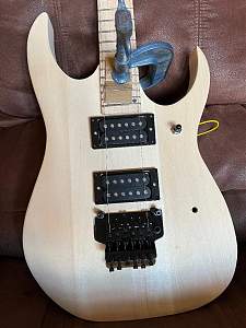

    Well, travel and various distractions have gotten in the way, but I am trying again. Mock build looks OK, after widening the neck pocket a hair. (Photos attached) Now working on the fretboard and neck. I am considering staining the fretboard, as it is not the rosewood I would have preferred. Any thoughts?
    I think I have made some sense of the Floyd Rose, which is a different critter, but it appears that there will be some space around and under the bridge. Should it be stained or painted same as the body? That is my guess.
    Simon, I did not get a close-up of the nut, but I will get one and hope you will make suggestions. Thanks. Click image for larger version.

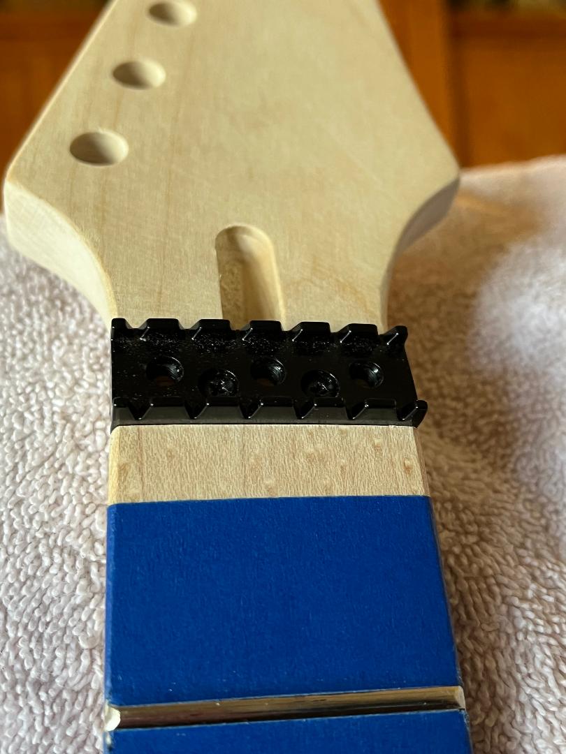

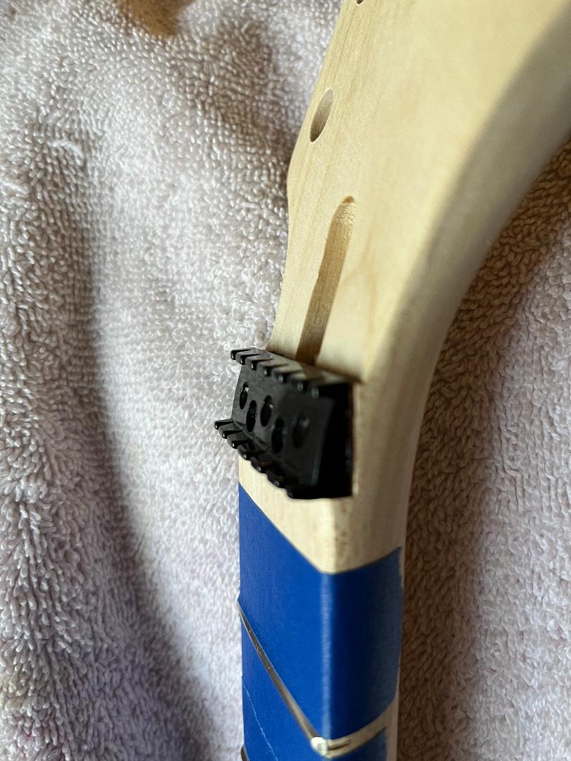

    Here are photos of the locking nut, which is what had me puzzled. It appears to be a pot metal. Is the stock PBG nut adequate, or would I be wise to upgrade? This will likely never be a gigging guitar, just another one in the collection. Have seen a T-shirt that read, "It's not hoarding if it's guitars." Click image for larger version.

    That’s the correct nut to go with the locking trem, but you should also have three (almost square) string clamping plates and associated bolts.

    Like many of us, I watch about a hundred videos. One guy said he'd gotten the best neck finish he'd ever achieved using boiled linseed oil. Hey! Cheap, convenient, and there is half a gallon in my garage. So, I sanded and stained with Old Masters Wiping Stain, maple flavor. Then the linseed oil, and set aside for 3 days. It was drying kind of bubbly, but I'm sure more than one coat would be needed. The video said wet sand with 1500 grit using mineral spirits with a splash of linseed. Even sanding lightly and that fine, I was starting to sand the stain off the headstock edges. And, although it seems I would have gotten a very nice feel eventually, after almost 3 weeks the BLO has not completely cured. So, time to sand back, touch up the stain, and return to TruOil.
    Have sanded the body and slightly rounded the upper outside edge where the arm will rest. Two coats of Timbermate, sanding in between. I'm going to try something new. Over a black basecoat, Rustoleum Colorshift paint, Purple Sunrise. We'll see.
