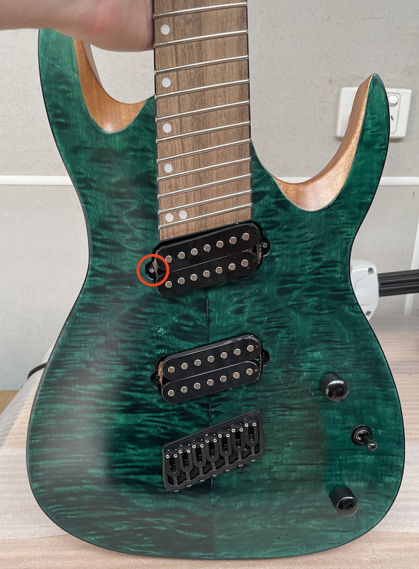

    Hi All, I've gone and stripped the head of the direct mount pickup screw and now can't remove it. The reason I need to remove is that is was the only one out of the 4 screws that for some reason would not go all the way in, even though I pre-drilled to the same depth.
    I've tried using duct tape on the head to help fill the gap, tried using 2 different nose pliers and even looked at cutting the head for a flat head screw driver using my Dremel, but the blades are too thick.
    So annoyed as i was up to the soldering and setup prior to completion!!!!
    Any ideas how to get this out without damaging the body or the pickup or the pre-drilled hole???

    I think I would keep persisting with the long nose pliers (or short nose). I would also tape around the edge of the cavity to avoid scratching the finish.
    Good luck.
    Thanks Trevor, will keep at it and see how i go. I still have no idea yet why this particular screw wouldn't go in all the way like the others, but hoping that once i get the screw out i can have a look and see why. I thought maybe a knot in the wood, but who knows.
    So frustrating as i was sooo close to having my fist 7 string usable

    I would cut off the head of the screw so you can at least get the pickup out. Then try removing the threaded portion that's left with pliers. At least without the pickup in there you have a bit more room to manoeuvre.
    Worst case scenario I can see, is having to pull the threaded portion out by force, then carefully drilling and plugging the bottom of the cavity for a new screw hole. There may even be enough room in the cavity that you could get away with just gluing a thin wooden block over the old hole and fixing the adjustment screw to that.
    I can think of more elaborate possible fixes using threaded inserts and swapping machine screws for the timber screws, but I can tell if that's feasible without seeing it first hand.
