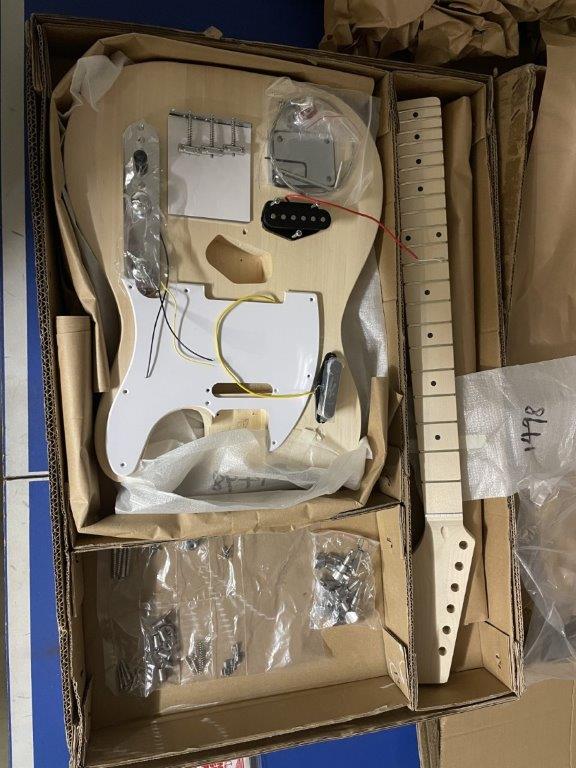

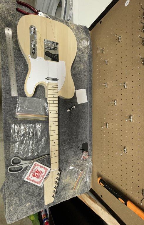

    Kit arrived last night!
    Did a quick unboxing and everything appears to be included. I will do a dry fit when I have some more time to check everything before I get started in earnest.
    Couple of items I noted:

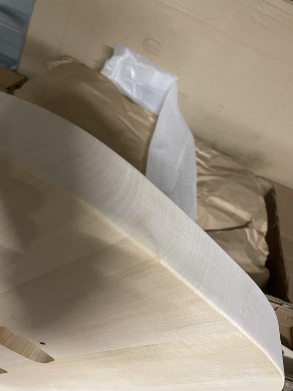

    - Minor blemish on the body, looks like there was a small crack that has been glued? I'm not that concerned as I am spraying this so should be covered up. Do I need to fill this before I start?
    - The neck fits really firmly into the neck pocket (so much that it's difficult to get in/out without some force). It's been raining here in Mackay so I assume the humidity has swelled the neck/body a little. Will check the neck alignment when I do the dry fit. Is this something that needs a fix or am I fine with it being really tight?

    I'd fill the crack before you start any sanding of bare wood. I'd use something like CA/superglue that won't shrink.
    The neck pockets on the kits can often be on the tight side when they first arrive, especially after any air travel. I'd certainly give it a couple of days to see if it improves. If it does, it may take a week or so to get back to its 'normal' condition. Whilst you normally leave the inside of the pocket unfinished, you'll put finish on the neck so that will make it an even tighter fit, so you won't want it too tight before any finish goes on. But you don't want to start sanding now and then have it too loose. So I'd just wait for a bit.

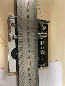

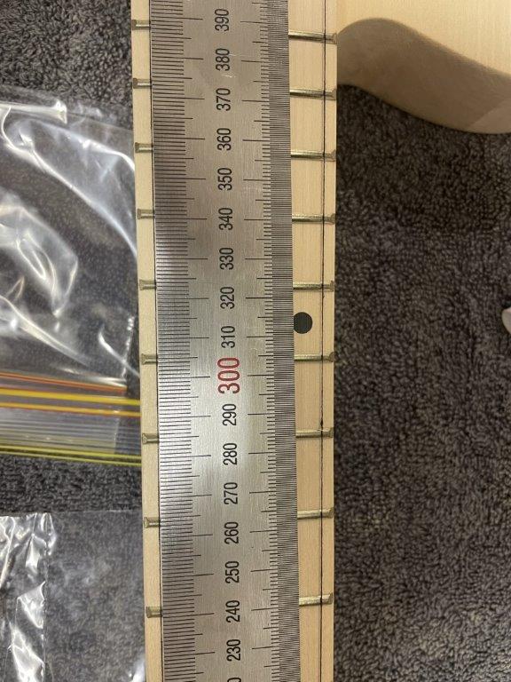

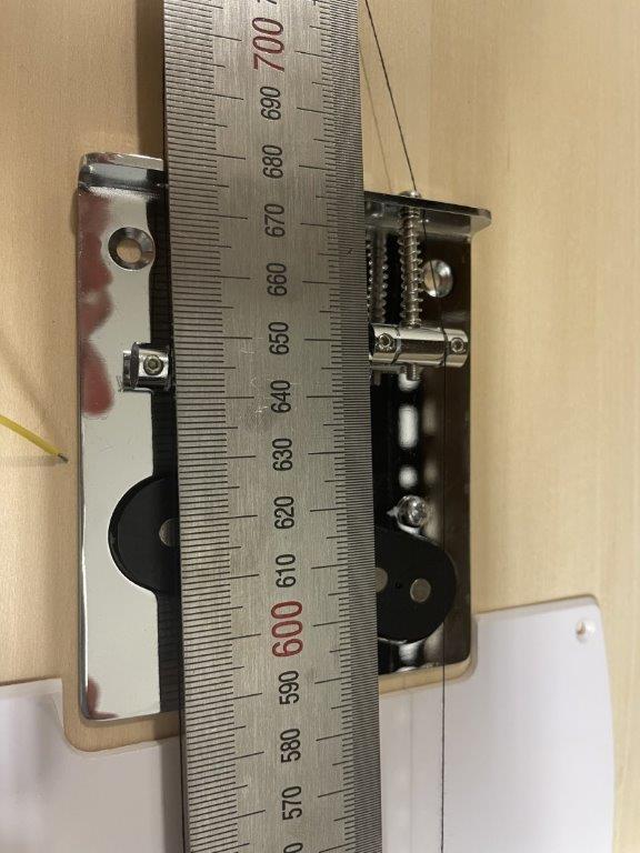

    So I finally got some time over the weekend and did a dry fit.
    Checked the scale length and nut to 12th fret is ~324
    Nut to bridge saddle on the high 'e' is ~645
    So I can move the saddle backward to get the intonation.

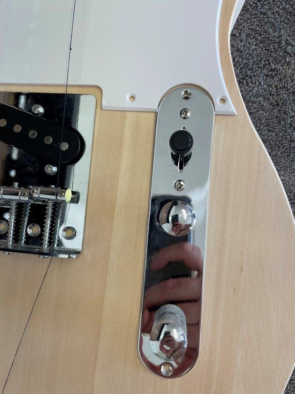

    Another issue I've come across on the dry fit is that the pick guard cut out for the volume/tone/pickup selector isn't correct and it doesn't slide in nicely. Can I sand back the plastic, or is there another way to modify this to fit?

    I guess now it is time to get sanding.
    Yes, I’d sand the pickguard cut-out. If you can find something tubular with a diameter slightly smaller than that of the cut-out to wrap sandpaper around, that will make it easier.
