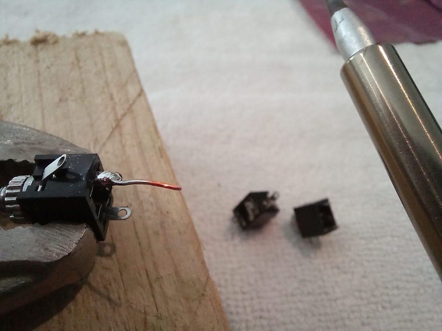

    So far I have bought a soldering iron kit and a couple of small jacks that have tabs for soldering, and I have tinned a wire and soldered it to the jack. Should I put a multimeter on it to check for resistance?

    Hi Don,
    If you have a multimeter you could check for resistance for your own piece of mind (it would be really small (less than 0.1 ohm!)).
    Most times you can see if you have a good solder joint - it should be shiny and smooth over the two parts you are joining.
    It is hard to tell in the picture - but did you feed the wire through the tab hole? I normally twist the wire around itself after going through the hole, especially with the stranded wire that the kits come with (I crimp single strand wire around the tab hole with pliers) . Then I solder the tab and the twist
    Not sure about the tassie oak, but I do know that the maple is really hard (I now use a jigsaw rather than by hand with a coping saw).
    It never does any harm to check with a multimeter. If you’ve got two or three wires going to a terminal (common with potentiometers on guitars) then it’s possible for them all to look soldered but for one to remain unconnected, often due to the insulation on a wire being pushed too near the joint and the insulation is held in place by the solder and friction from the other wires, not the wire itself. Less of a problem with the typical PVC kit wire insulation as that melts at quite low temperatures, but some other insulation types and heat shrink insulation are far more heat resistant.
    Touch the probes together first and see what reading you get. Whatever it is, you’ll never get any lower than that. On mine it normally reads 0.04 ohms. On my previous one it was 0.08 ohms. Partly internal resistance, partly lead resistance, partly the design of the meter.

    For guitars, you will generally be looking at resistance readings. Checking potentiometer values, pickup coil dc resistance and open and short circuits.
    The typical guitar/bass pot values are in the nominal 250k or 500k area. Pickups are normally between 5k and 12k but some high-powered ones with many turns using very thin coil wire can read up to 24k.
    So as long as you can read those sort of values, you should be OK with your meter.
