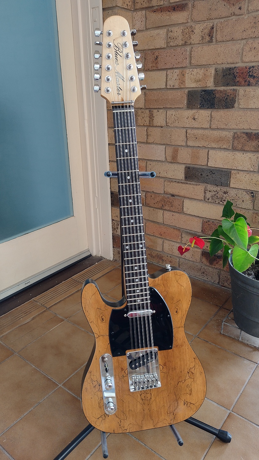

    Looking good. I always like seeing another lefty kit assembled.
    Cutting the pick guard is easy and can be done with a saw and tidied up with a file and sand paper. This was how I trimmed mine.
