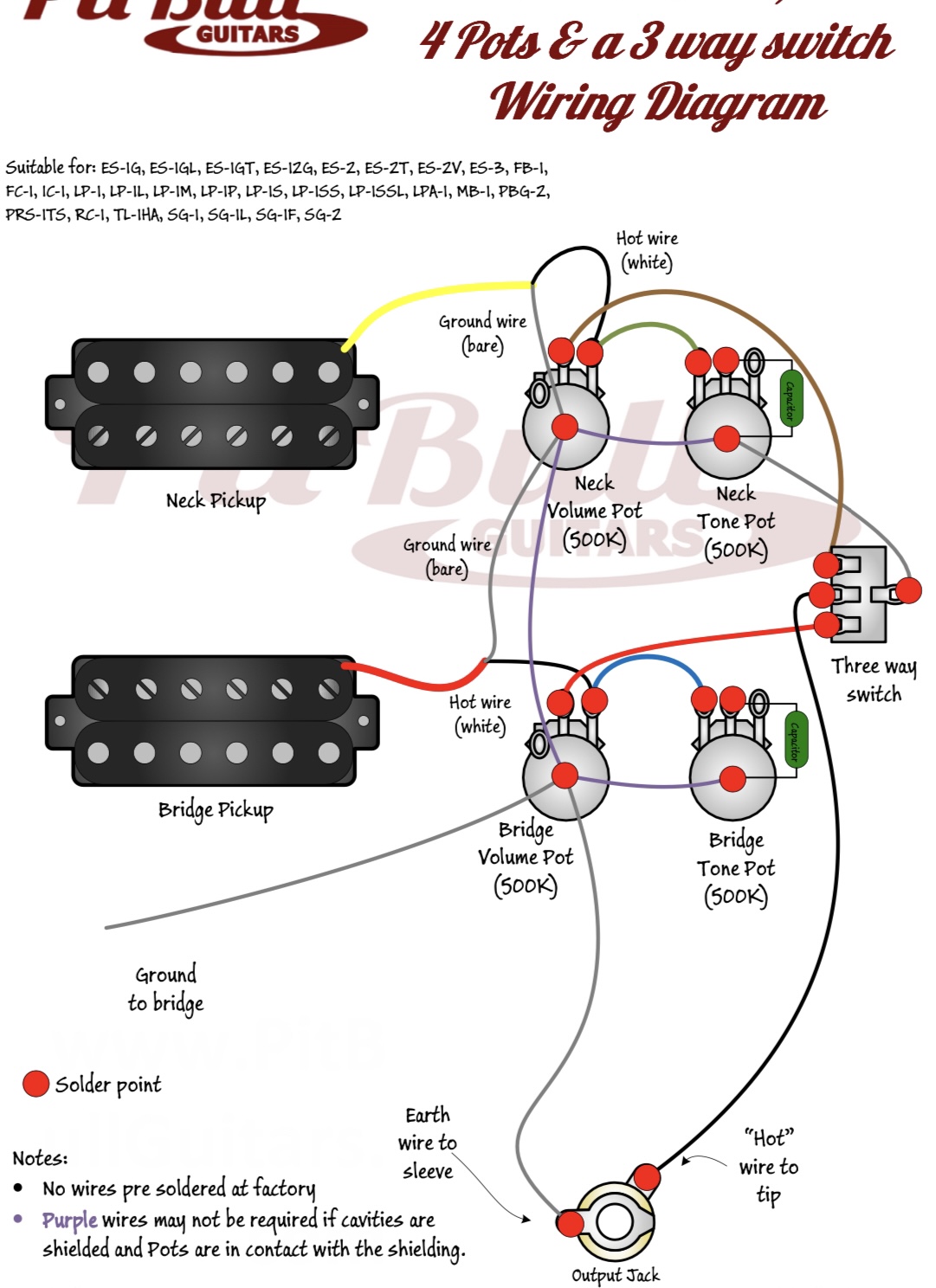

ID:	43256 Hello! I am beginning to work on the wiring for my ES-3 while I let the poly cure. I am making a wiring diagram that is more accurate for the ES-3 in terms of the placement of the parts, but I’m a bit confused about some of the connections on the PitBull diagram. Am I correct in saying that the switch is grounded to the neck tone pot, the jack and bridge wire are both grounded to the bridge volume pot, and both pickups are grounded to the neck volume pot? Also, does the diagram want you to ground the jack and bridge wire to the bridge volume using separate wires? Can I ground wires to different pots in order to avoid overcrowding, or does it matter which pots the wires are grounded to? Anything helps!!
    You can use any pot to ground wires, as long as all the backs of the pots are connected together and grounded. The only thing you want to try and avoid doing is creating a ring with the ground wires. I'd definitely ground the bridge pickup on the bridge volume pot and the neck pickup on the neck volume pot.
    I agree that the wiring diagram isn't optimised for an ES-3 and the way it's wires run. It was probably one of the first diagrams done and whilst technically it works, it's not very ergonomic!
    Definitely make up a cardboard template when wiring the pots together, and mark on the position of the F-hole so you can arrange the wires to run around the outside of the F-hole. You may find that taping or cable tying some wires together is necessary to keep everything neat. Also consider how the pickup wires will run to avoid being seen.
    Draw it out, and post a photo of it if you want it checked or commented on.

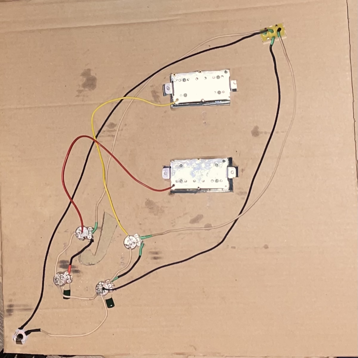

ID:	43257 here is a picture of the template I made to try make sure all the wires are long enough
