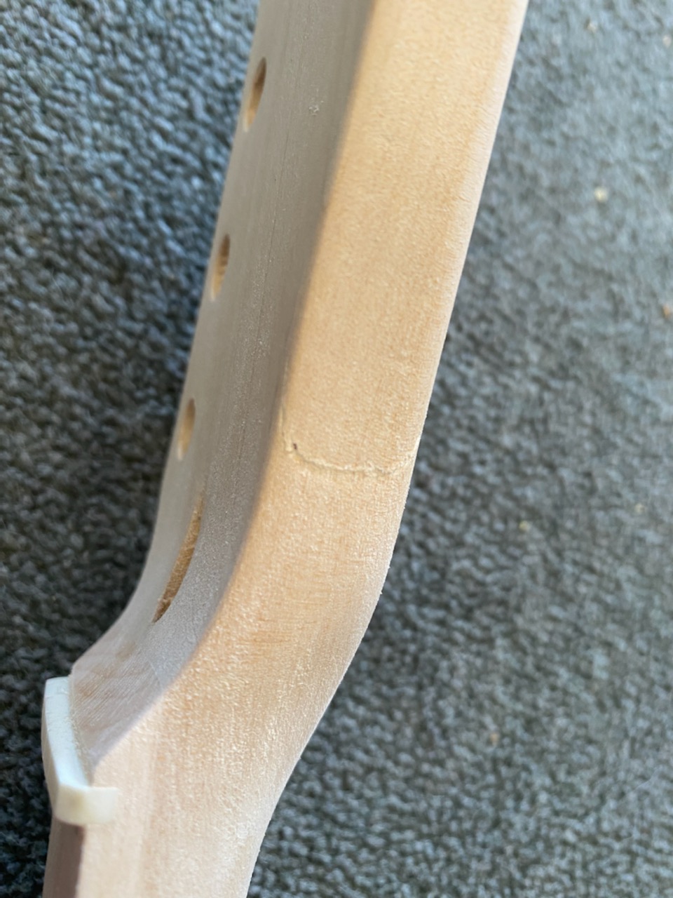

    Memo to self: Post help request. We have a problem - slight split in the grain and I don't know how to fix. Fingers crossed that some good soul here can help.

    Can you post a picture of the split in the grain?
    Thanks, Trevor
