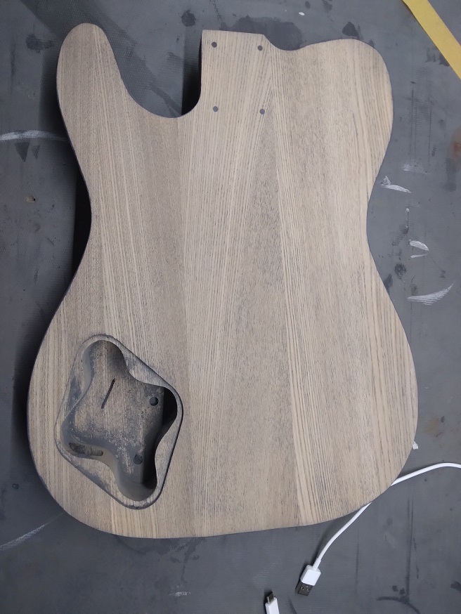

    I decided to go with a simple ebony grain filler. I'm still debating between phthalo blue, or yellow, but want to darken the grain for more contrast. This is my first time working with grain filler, and I think I may have made a mistake along the way. Below is what I have after 2 coats of grain filler:

    It seems like the filler is not penetrating as deep as it should. The grain filler I chose to use was Goodfilla Wood Filler. It is labeled as a wood filler, but can be used for grain filling, it just requires thinning it with water. My assumption is I did not thin it enough to fill all the grain, but was hoping for other opinions in case my thinking is incorrect.
    Thanks in advance for any assistance!

    That Goodfilla appears to be our Timbermate's American cousin!
    IME a single application with this kind of product is not enough. On my Ash tele (in avatar and Photo Gallery) I had to do at least 3 applications (and I think a 4th in some areas IIRC). I also used ebony on that guitar, but it was Timbermate brand.
    Edit to add:
    re: thinning -
    I don't know about the Goodfilla, but Timbermate (also water based btw) recommends thinning to a consistency similar to toothpaste (???).

    Thanks, McCreed, for the helpful answer. That's a good piece of info that this filler is the cousin to Timbermate! I've heard many people on here say that Timbermate is the way to go, but I basically had to buy it in a bulk size that made little sense, or a small bottle of Goodfilla, so Goodfilla won out. I will say it's been extremely easy to use, and for many different purposes.
    That's good to know on the number of applications. I didn't have a ton of the filler, so wanted to check in before buying more. The consistency could definitely be part of the issue. If it's supposed to be similar to toothpaste as mentioned above, mine was a little too thick at the time of application, but gives me a good jumping off point for the third application!
    "We were supposed to have a quote?"
    FTR, that's pure speculation on my part. It's just the description on their product page is very similar to Timbermate as well as it's appearance.
    I just had a closer look at their instructions and the only remarks I saw regarding consistency was "Add up to equal parts of warm water to GoodFilla to get a slurry." If this was what you used as a guide, my gut feeling is that could too wet/loose.
    Another thing that caught my attention was "Smooth with a damp cloth or sandpaper when dry."
    I don't know what your process was, but if it were me, I would use sandpaper only. I think a damp cloth could potentially pull out filler you've just put in.
