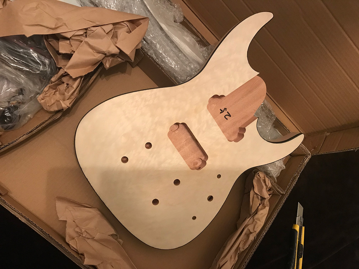

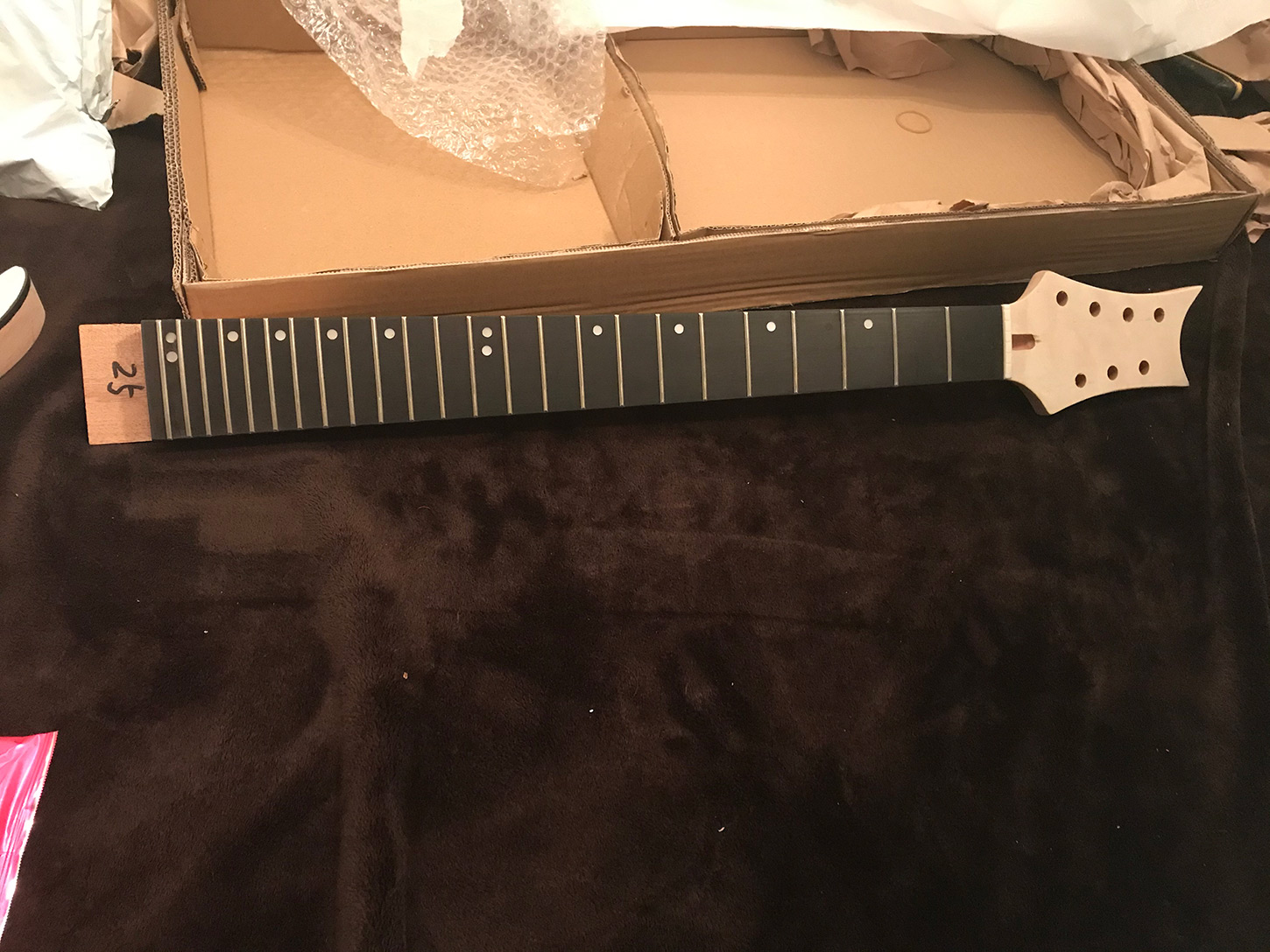

    Some of the small issues I’ve seen so far:

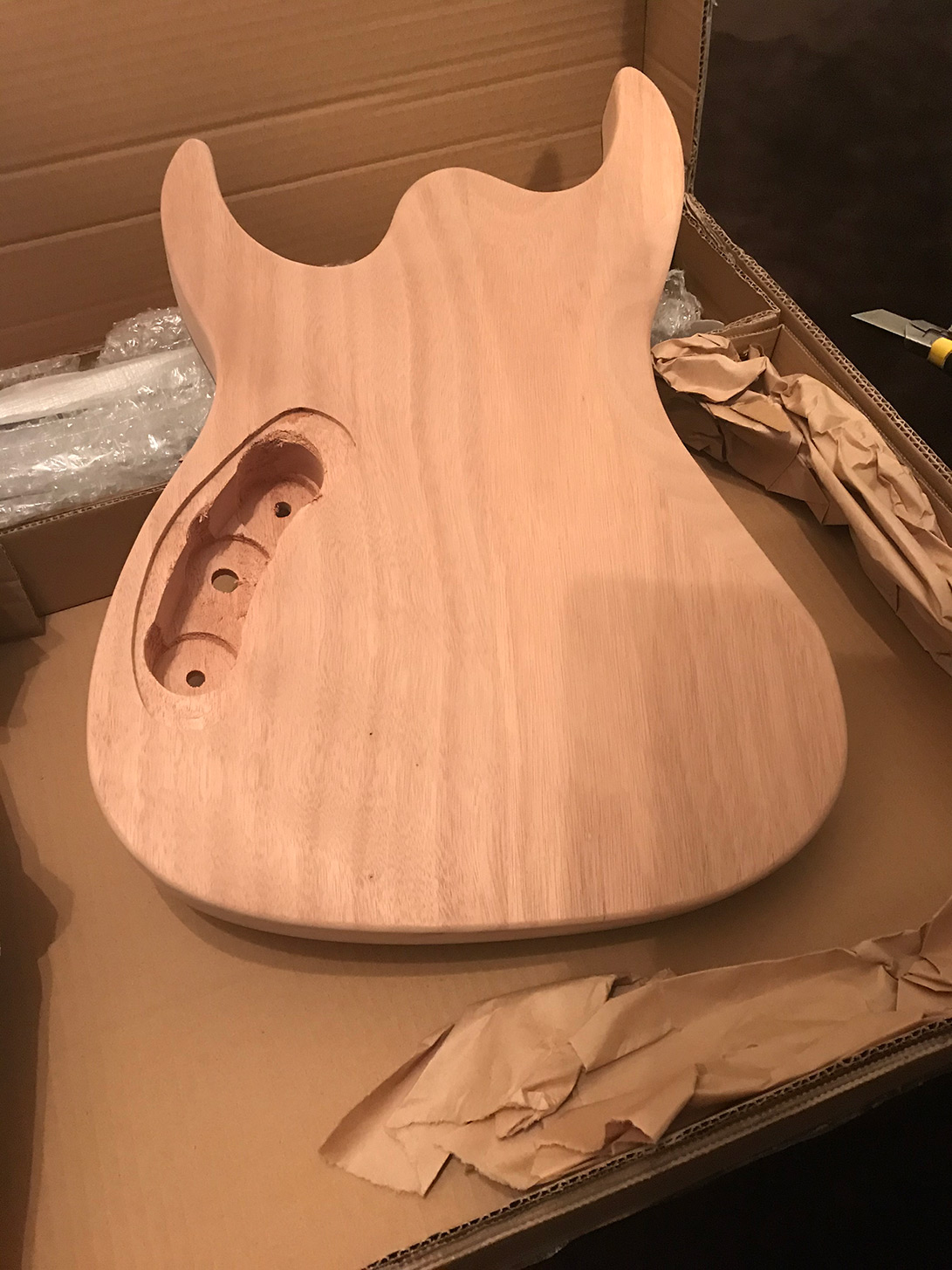

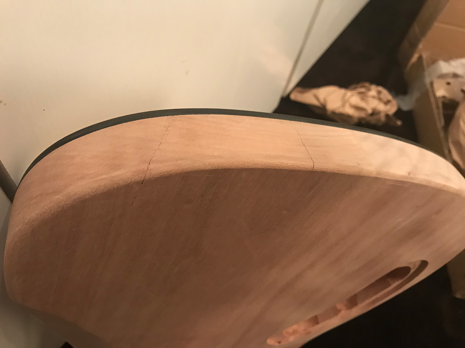

    1) A couple of cracks in the Mahogany body. I did fill them with woodfiller, hoping it will be good enough.
    2) The dots at 12th frets are completely out of line. Maybe I’ll route something with a personal design to cover this up.

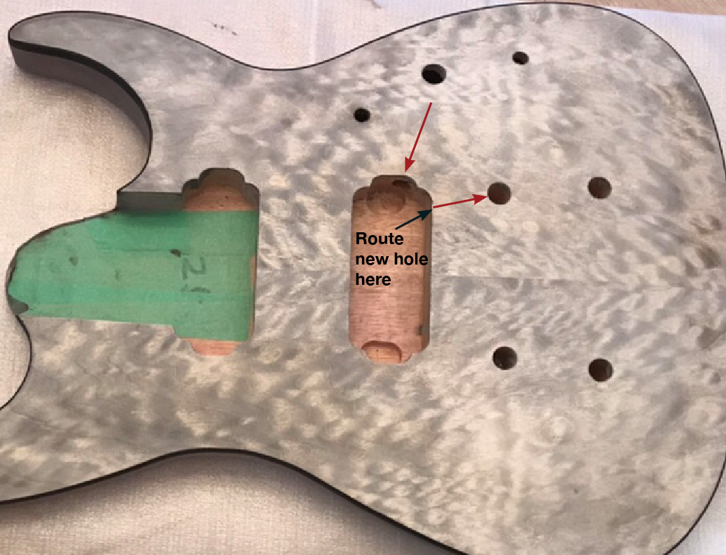

    3) The 3-way switch hole has not been routed deep enough, but it should be fairly simple to remove more material so that the switch can be attached on the top.
    4) The 24th fret was completely out of its pocket. It was an easy fix, I’ll see later if it needs some glue too.

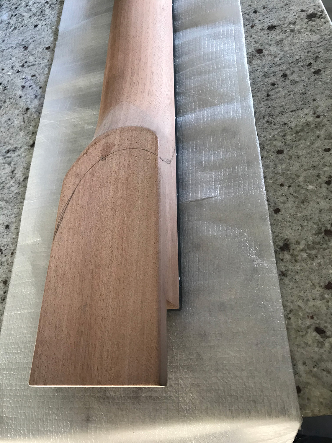

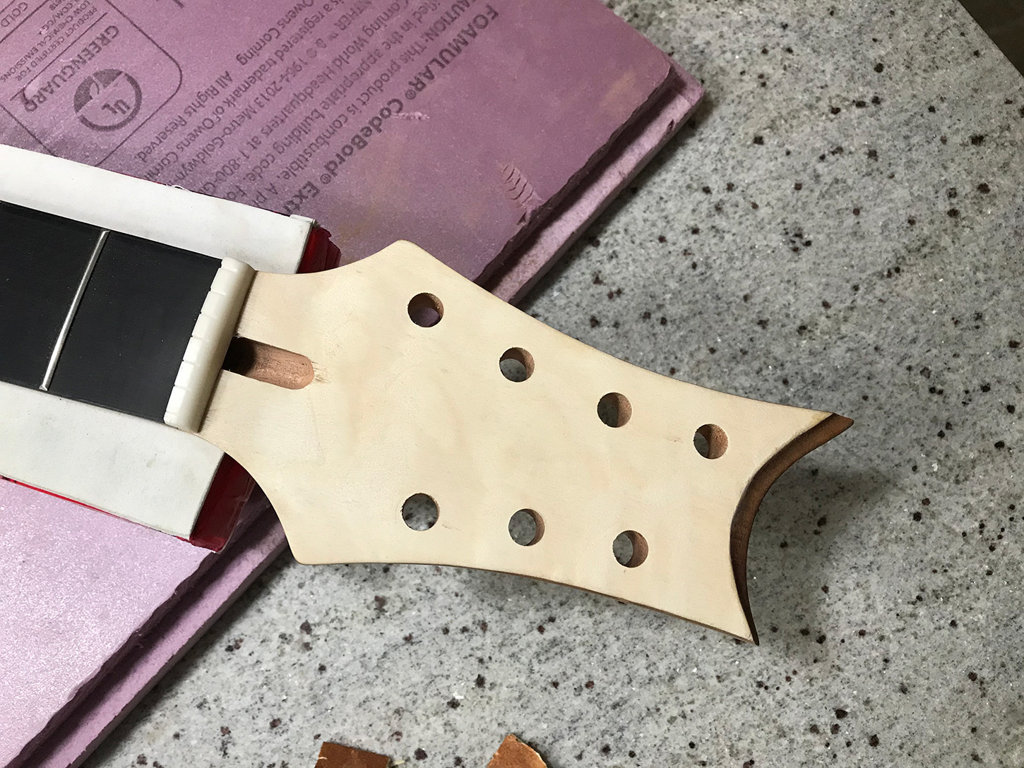

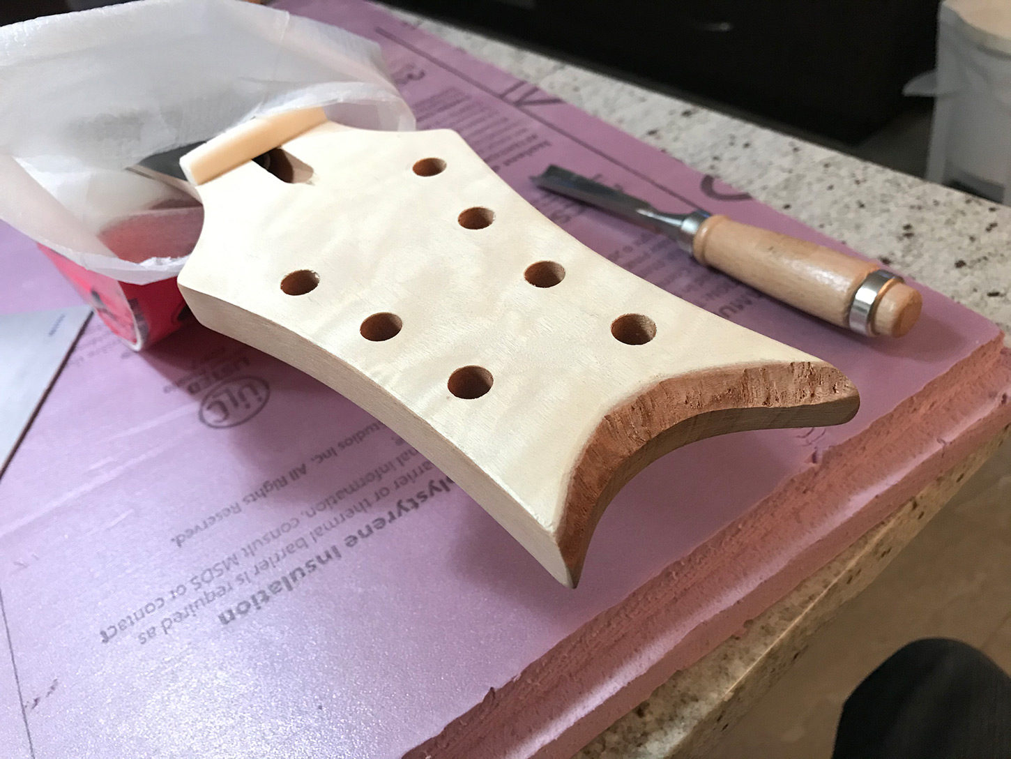

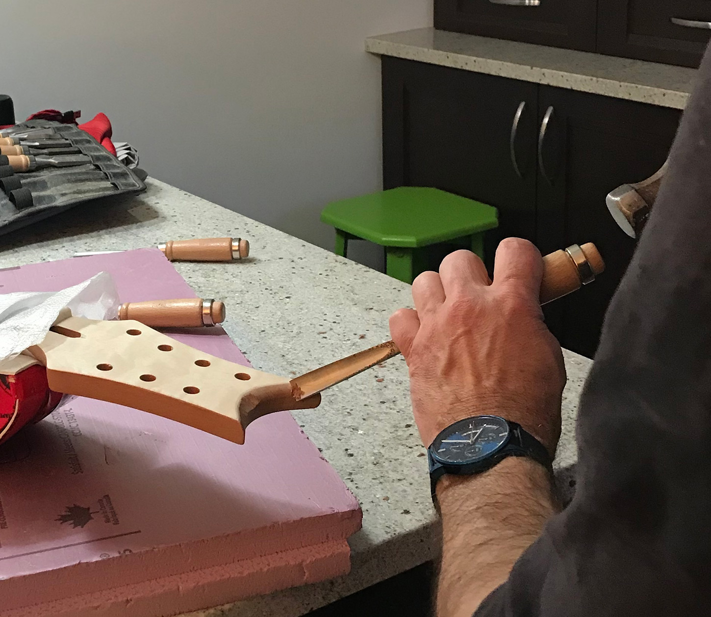

    I’ve been working a little on the headstock to personalize it. My goal was to have the Mahogany to show along with the Quilted maple.

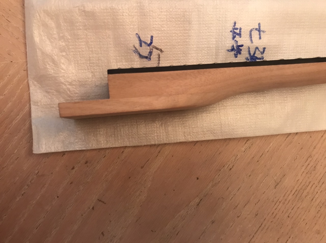

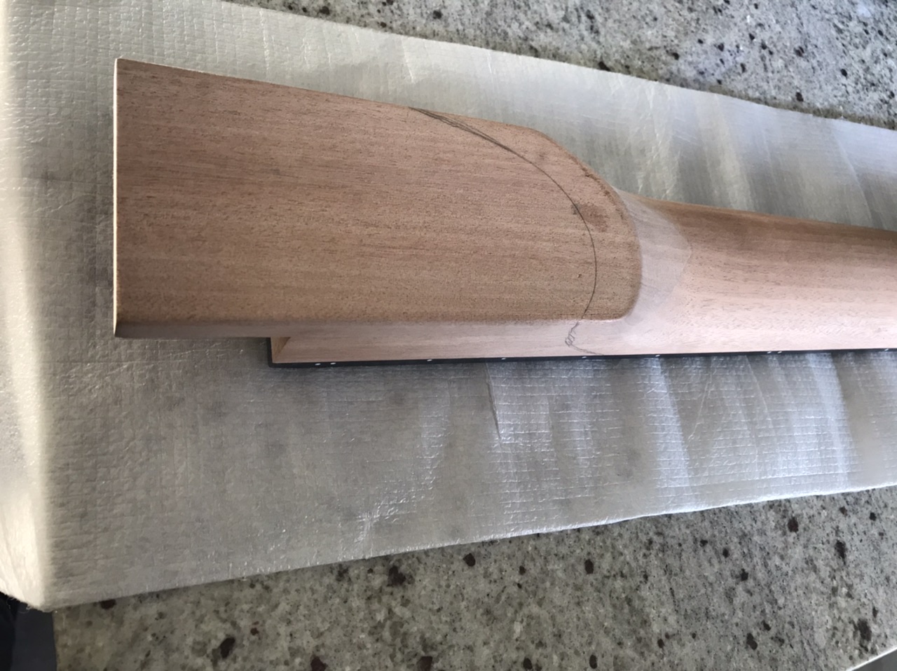

    And also, I am planning on reshaping the heal of the neck to make it align perfectly with the neck pocket. My new Japanese saw rasp should be useful to do this.

    Agreed, headstock looks great!
    #002 (WL-1)
    #005 (LP jr)
    #006 (TL-1A)
    'The TGS Special'
    A few days late, but...
    Yes, nice work. You obviously have some woodworking skills which will be a big asset with your build.
    I look forward to seeing this progress.
    Mick
    Thanks Mick and all! If I have some skills, I am discovering them as I go, as it is a first for me to work with wood. But I like beautiful things, so I naturally make my life more difficult whenever I can!!! It should progess faster when I’ll have time to reshape the heel of the neck.
    Éric

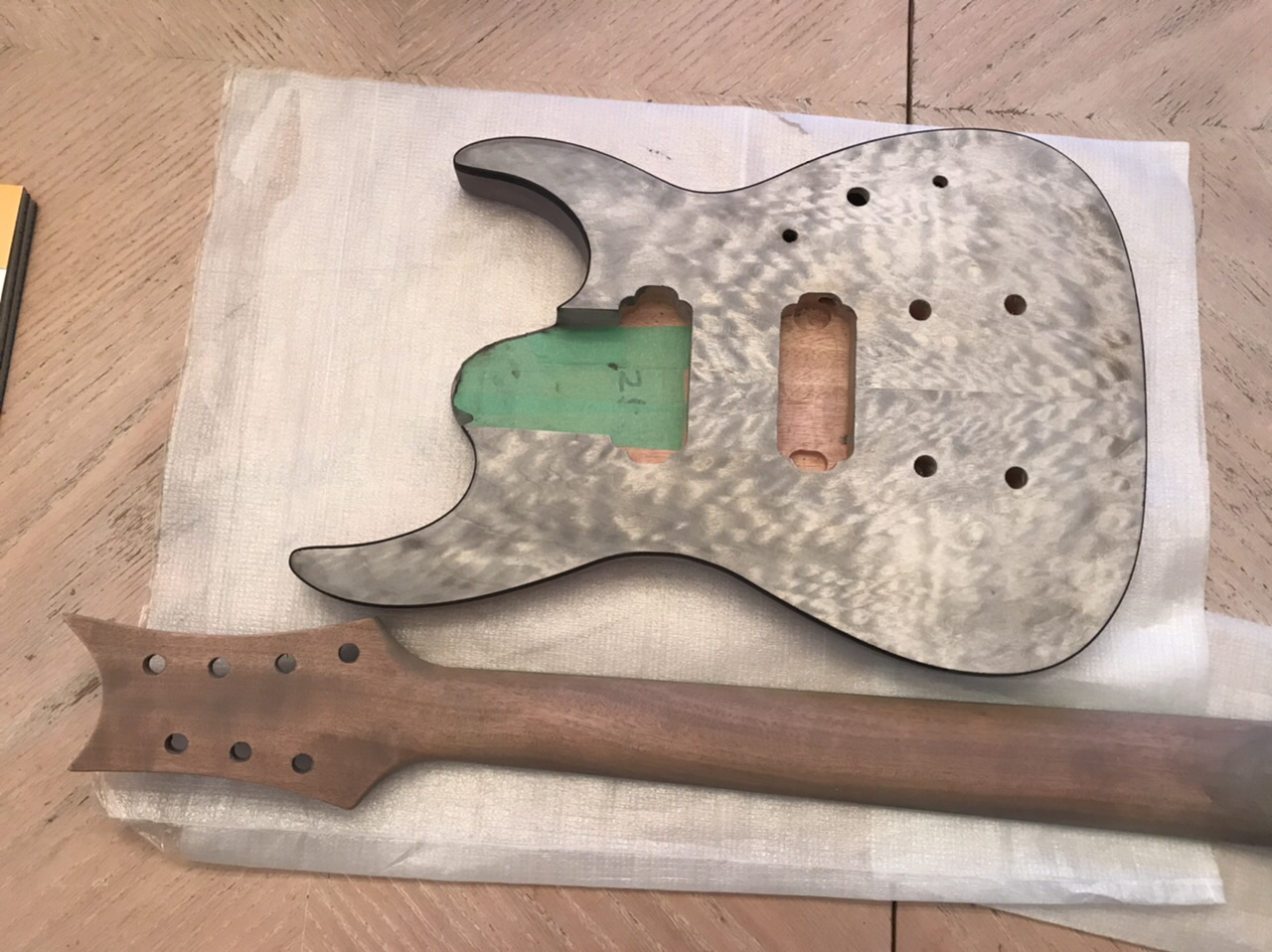

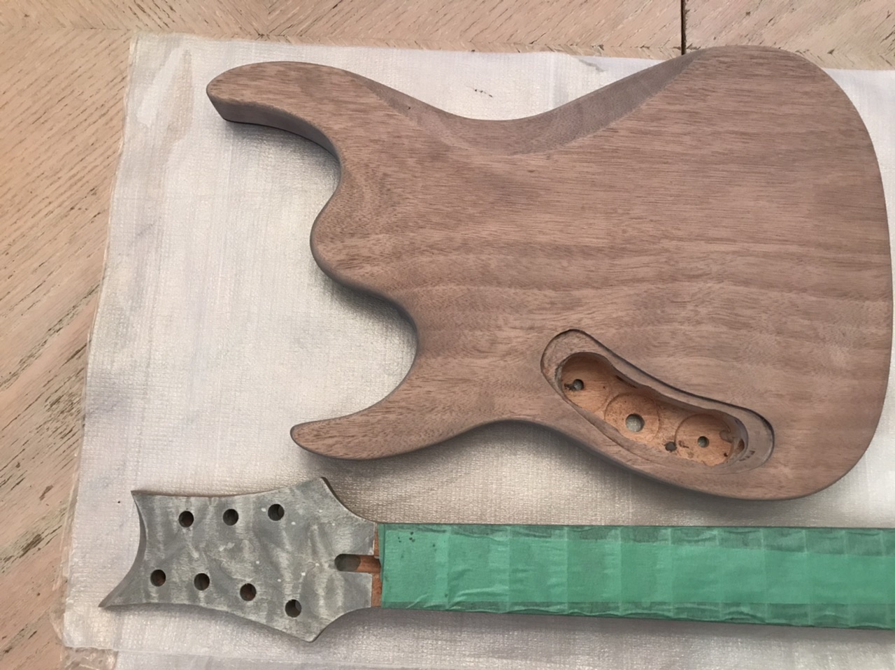

    Update

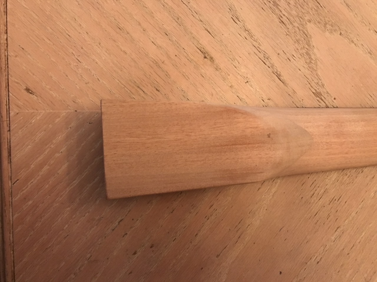

    I have now reshaped the heel to join the neck pocket more seemlessly. I have also done the first pass of grain filler on the mahogany part of the body. Slowly getting there...

    Some progress. Pore-filling and first tung-oil coats.
