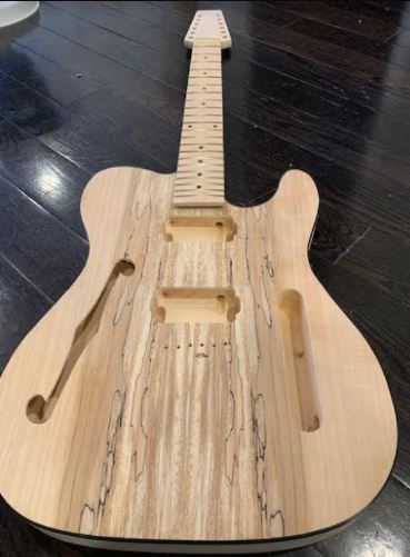

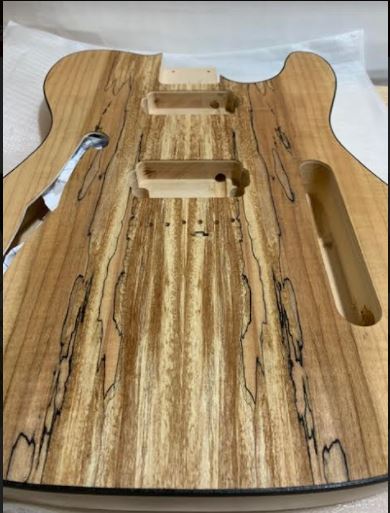

    Mock build between the neck and body fits perfectly. Below is a photo of the body together, and then the body, lightly sanded with a layer of tung oil applied.
Name:	12 String top fresh.JPG
Name:	12 String top Tung oil.JPG

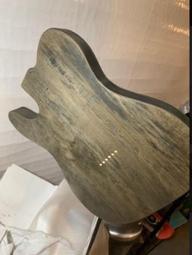

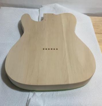

    I sanded the back of the body to 320 and applied a wood conditioner and then an ebony stain. Once this has dried I will be using a satin wipe on poly to finish the body.
    Currently debating what I want to do with the neck.
Name:	12 String Back fresh sanded.JPG
Name:	12 String back stained.JPG

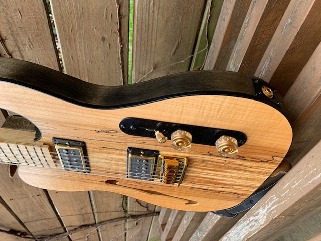

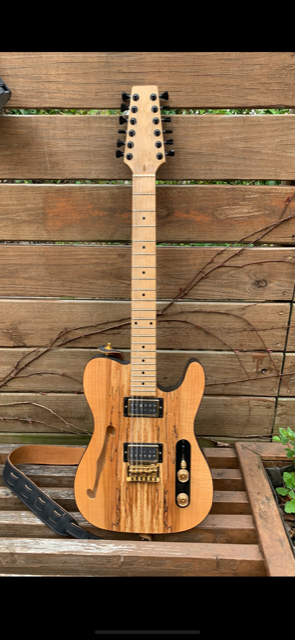

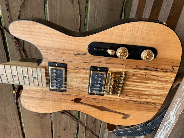

    Hi All,

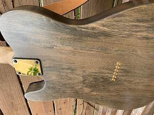

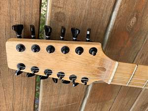

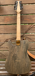

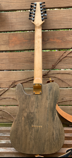

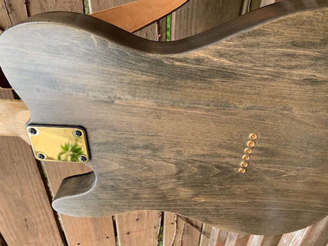

    Been a while since I have been able to post. Not long after my last post I welcomed my first child, so free time and energy has been almost non existent. I have finally finished up the remaining bits of getting this wonderful project perfect.
    I used a Golden Oak stain on the neck and Ebony stain on the back of the body. Topped off with a couple dozen layers of satin poly.
    Upgraded to a Gotoh 12 string bridge that intonates each string individually
    Hipshot staggered locking tuners. One post that really stuck with me while doing my research was "with a 12 string, you spend half your time tuning and the other half playing out of tune" this led me to get the locking tuners and upgraded bridge
    I liked the look of the speed knobs so I used those instead of the top hat style
    GFS Surf 90 pickups which sound amazing
    I have really enjoyed getting to play around with this and love the extra depth this gives over my normal 6 string. I couldnt be happier with the outcome of this project
    Thank you all for the help and the active community that has helped guide my decisions in the background of this whole adventure.

Name:	Back close.jpg
Name:	Final Back2.png

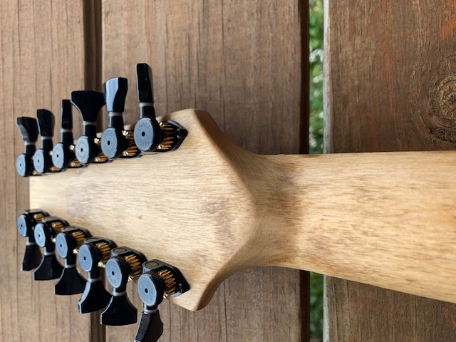

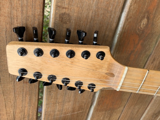

    Nov 2020
    Philadelphia
    22
    Not sure why some came out sideways, but if you click on them they open in the normal view
Name:	Back Headstock.jpg
Name:	Front Headstock.jpg
