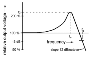

    Different pickups sound different because they don't just pick up the vibrations from the string. The whole pickup, volume control, tone control, guitar lead and amp input impedance arrangement creates a resonant low-pass filter circuit, which the pickup signal then passes through and shapes the tone. An exaggerated example is shown below:
    The resonant peak boost frequencies around the peak (a bit like a Wah pedal does) but the as the frequencies get higher, they get more and more attenuated.

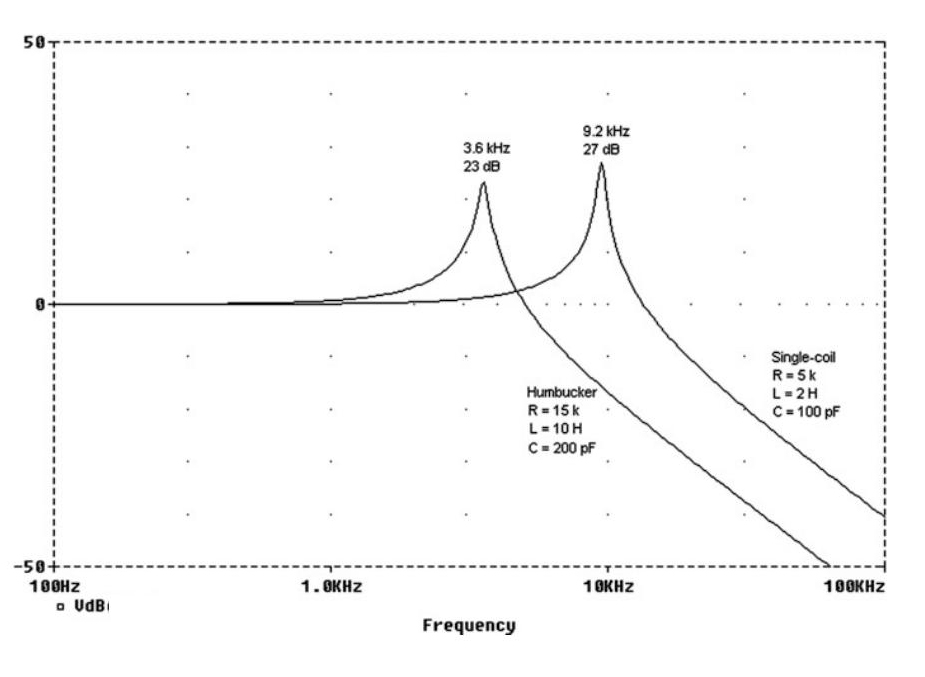

    By varying the level of inductance, impedance and capacitance in the circuit, you can move the resonant peak frequency up or down and vary its height. Inductance is probably the main factor in determining the peak frequency. For a humbucker, with two coils in series, the inductance is a lot more than of a single coil on its own:
Name:	Humbucker vs single coil.jpg
    So (in general) a humbucker's filter emphasizes the mids and cuts off a lot of treble, whilst the single coil's filter emphasises the treble and lets a lot more overall treble though.
