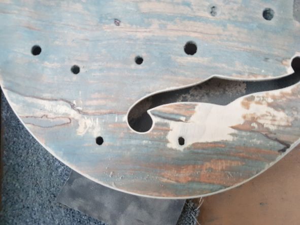

    Jan 2023
    Swansea, Wales, UK
    14
    Green mess, meant to be black.

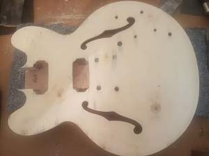

    Jan 2023
    Swansea, Wales, UK
    14
    Went through veneer so quickly, and now sanded veneer off.Click image for larger version.

    Apr 2017
    238
    I don't know that particular kit but a couple of comments.
    Not good with the stain doing that, it may have reacted with the glue used for the veneer. Always best to test stain on an inconspicuous area if possible.
    You did well getting the veneer off. Veneers are usually very thin so they are problematic to sand unless you are removing them.
    The body is most likely basswood and this should take a stain. Test the stain in the pickup pockets first.
    400 grit has probably made the timber too smooth to take a stain. I stop at 240 grit when applying stains. Might be worth going back over the body with 240 grit to open the grain of the timber.
    Hope that is of some help.

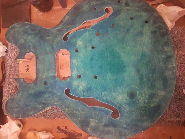

    Jan 2023
    Swansea, Wales, UK
    14
    Sanded the body with 240 grit, and attempted a blueburst on the ply top.As you can see, I used three different colour blue dyes.
    I have now realised I am wasting my time and money, so I will sand yet again, and paint with spraycans, it certainly could not turn out worse.Click image for larger version.
    Apr 2017
    238
    That looks terrible. What brand of dye did you use? The dye is definitely not taking to the timber.
    Solid colour is a good choice. Make sure you put a sealer/primer on before colour.
    1,967
    Yes, the stain is not absorbing into the timber. Maybe it is the glue from the veneer and/or the ply!
    It is incredibly frustrating. What type of stain was it? I never have any success with stains when I use sanding sealer first (but others on this forum swear by it). I have had black stain turn brown and blotchy.
    Keep persevering and good luck with take 3. Definitely use a sealer/ primer, and also try to get some clear from the same brand as the solid colour to make sure they are compatible.
