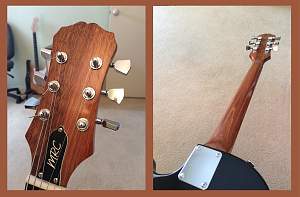

    Also, 6-8 coats is about where I might think about a very light touch up with a synthetic sanding pad (aka synthetic steel wool or Scotch-Brite pad) and this is merely to de-nib the surface (remove any dust or debris that may be in the finish). I don't sand between every coat and, only sand lightly as described above, as needed.
    The neck below is Mahogany with 24+ coats of Tru Oil, wet sanded and polished Micro-Gloss. It feels absolutely great in the hand, not grippy at all:

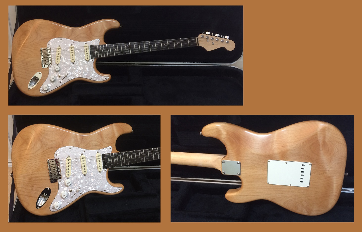

    This is an Alder body with 24+ also, same post finish treatment:

    I did those back in 2017, so my memory is a bit vague, but my procedure has not varied much in a number of years.
    Based on that, I would have likely started with 1000 or 1200 wet/dry paper, then switched to my Micro-Mesh and worked up through 2000 > 2400 > 3200 > 3600 > 4000. Then hand polished with Micro-Gloss (1 micron liquid polish). Both of those products are manufactured by 3M.
    Some will argue that going to 4000 is extreme or overkill, but it's what I do, and has served me well.
