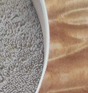

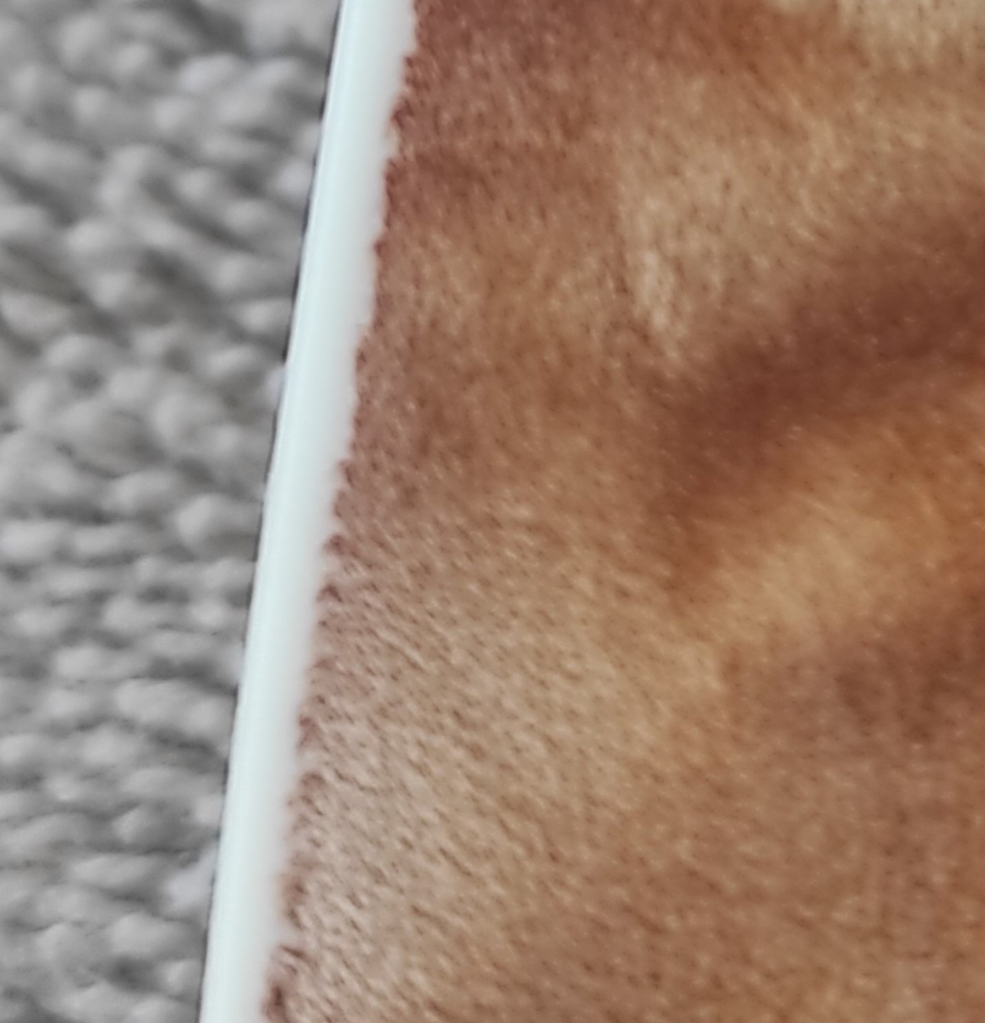

    I have a body with a gorgeous quilted veneer with binding around the edge. When i was preparing the body for finishing (some coats of thinned BLO then Tru-oil on top) I made an effort to remover any veneer from the binding to make it as clean as possible.
    Two coats in, the veneer has swelled (I think) and is now covering the binding in some spots again. As per the second picture, the veneer isn't covering the binding everywhere, you can see some of the clean binding and it looks so good.
Name:	Bleeding edge 1.jpg
ID:	38910 Click image for larger version.
Name:	Bleeding edge 2.jpg
    What's the best way to clean this up? Just keep sanding, through the finish around the binding, through the veneer and then refinish?

    Run a scalpel along the inner edge of the binding?

    The first thing to do is to go into a guitar shop and look equally closely at their stock...
    But I wonder if this is a grain raising type phenomenon, in which case if you take it back again it will probably go for ever. But that's a complete guess.

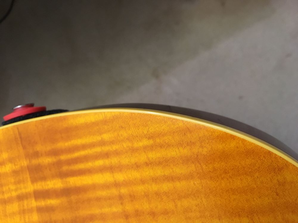

    I don't recall seeing this issue on my PRS-1TS kit, but looking at it, I'd think some careful scraping or sanding would clean it up. I do know I sanded the join between the veneer and binding well before I applied alcohol based dye, but I'm sure it was just me being thorough, not trying to fix anything. FWIW, my top coat is Tru Oil.
