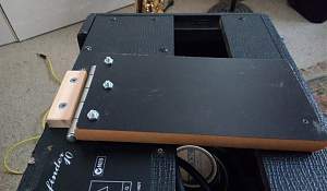

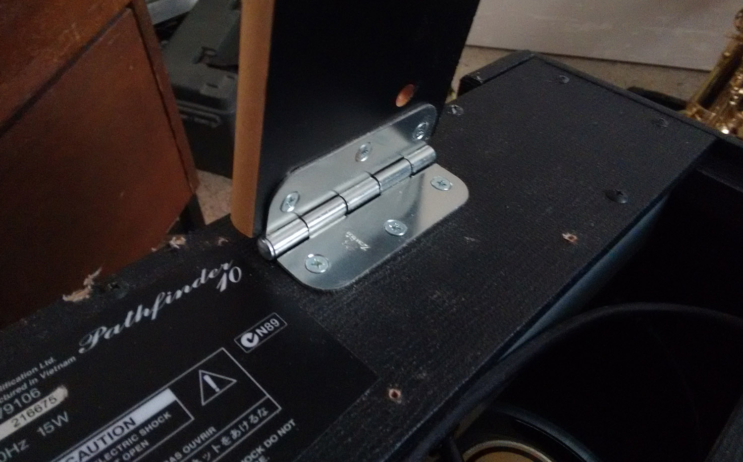

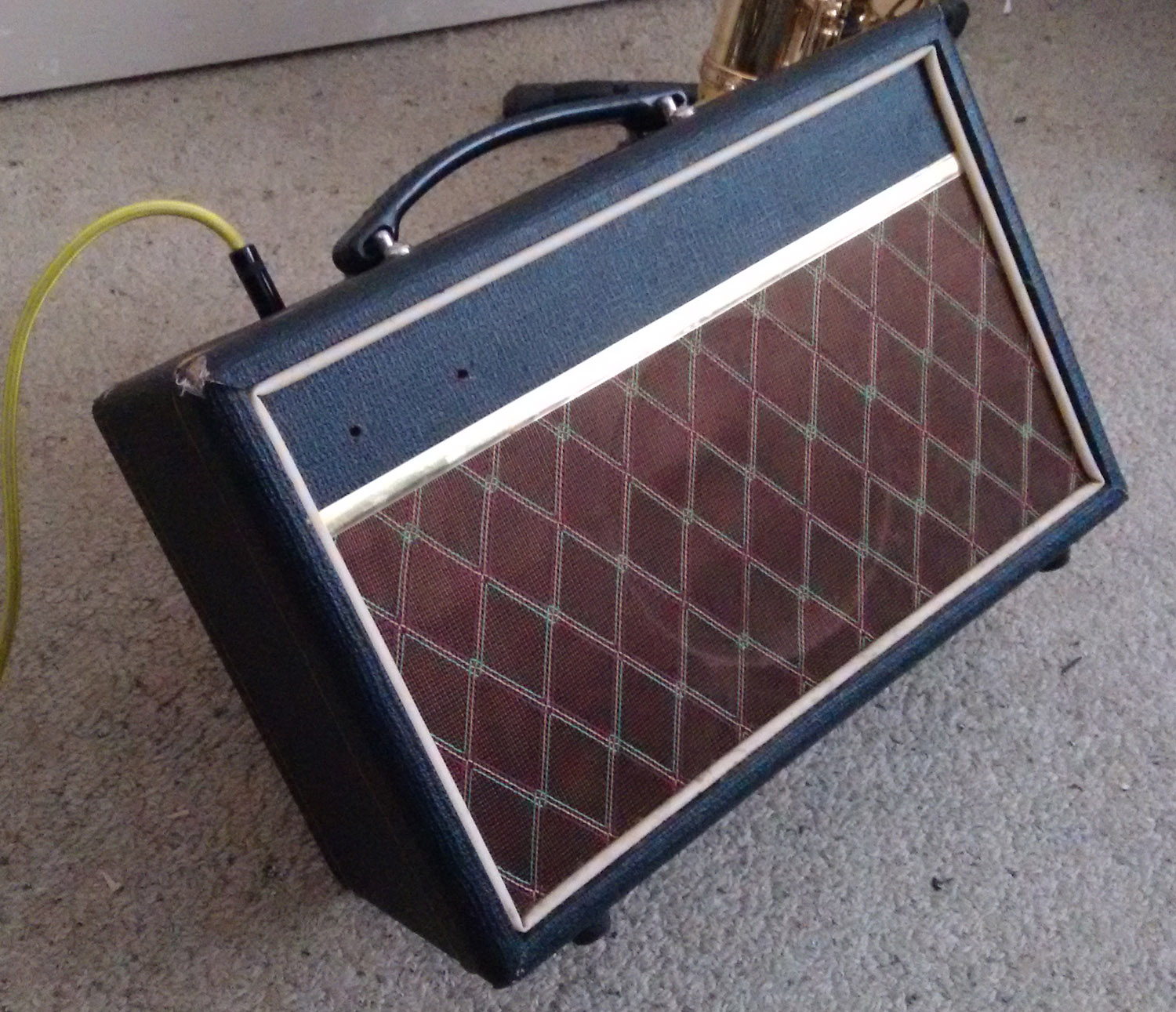

    Can't resist a bargain so when I saw this @ Camberwell Cash Converters it was a no brainer.
    Vox Pathfinder 10 for the princely figure of $60.
    Missing the Vox badge but it's all about the sound.
    Perusing youtube stumbled upon a neat (and cheap) idea instead of an amp stand.

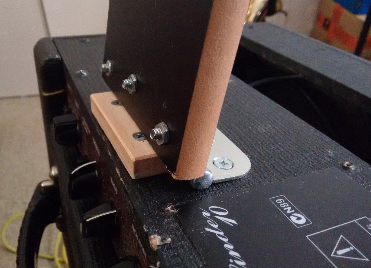

    Angled the bottom and glued sandpaper to the bottom edge for grip.
    I'll refine it at some stage to blend it in.

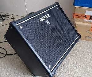

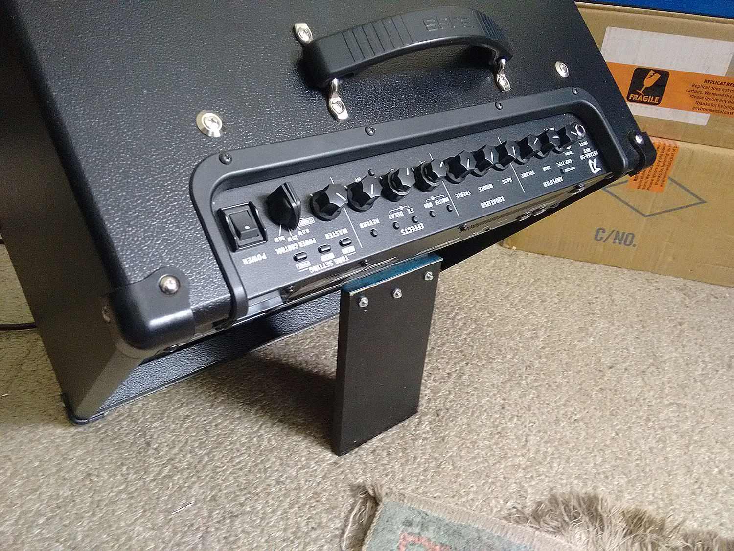

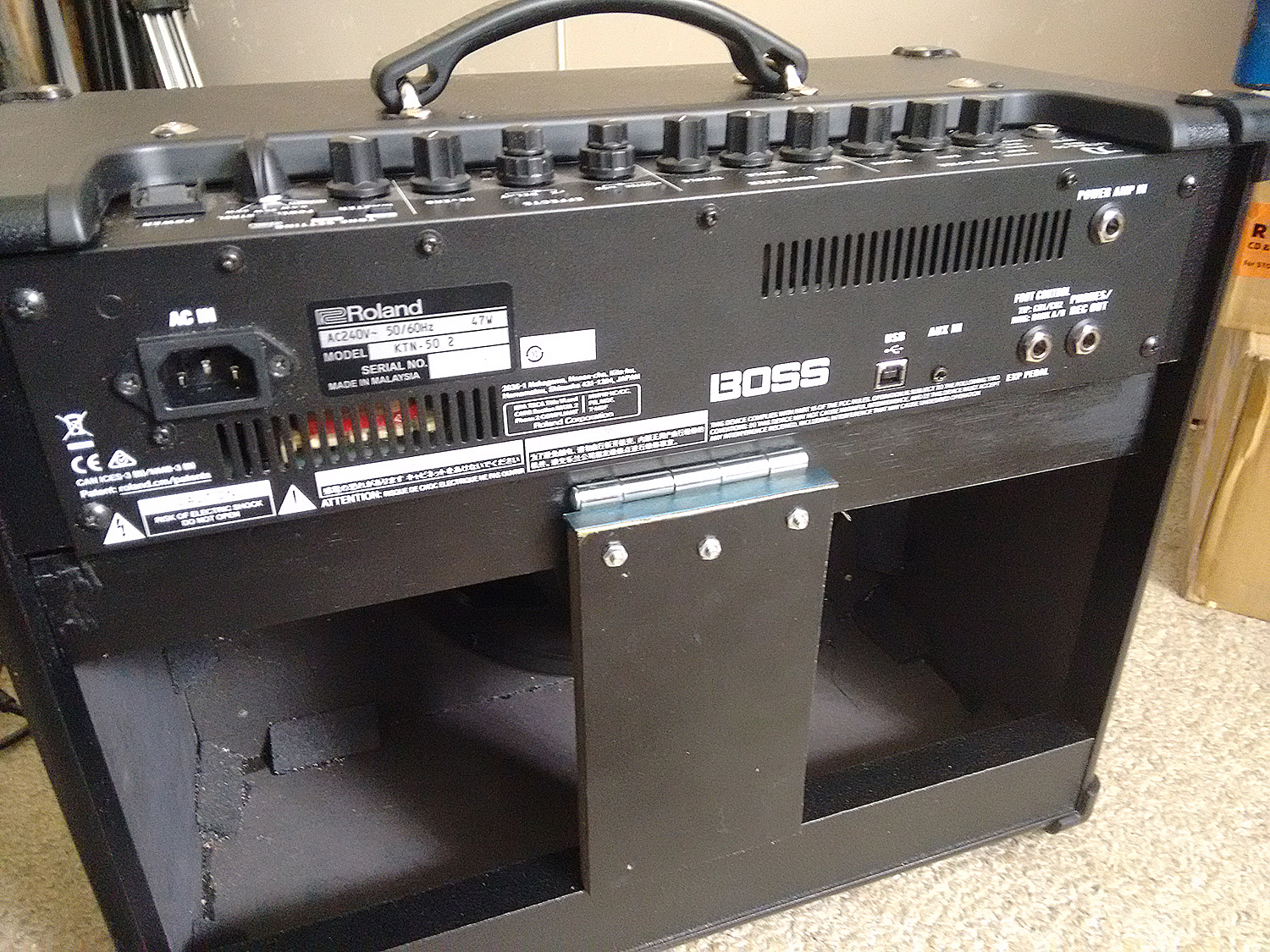

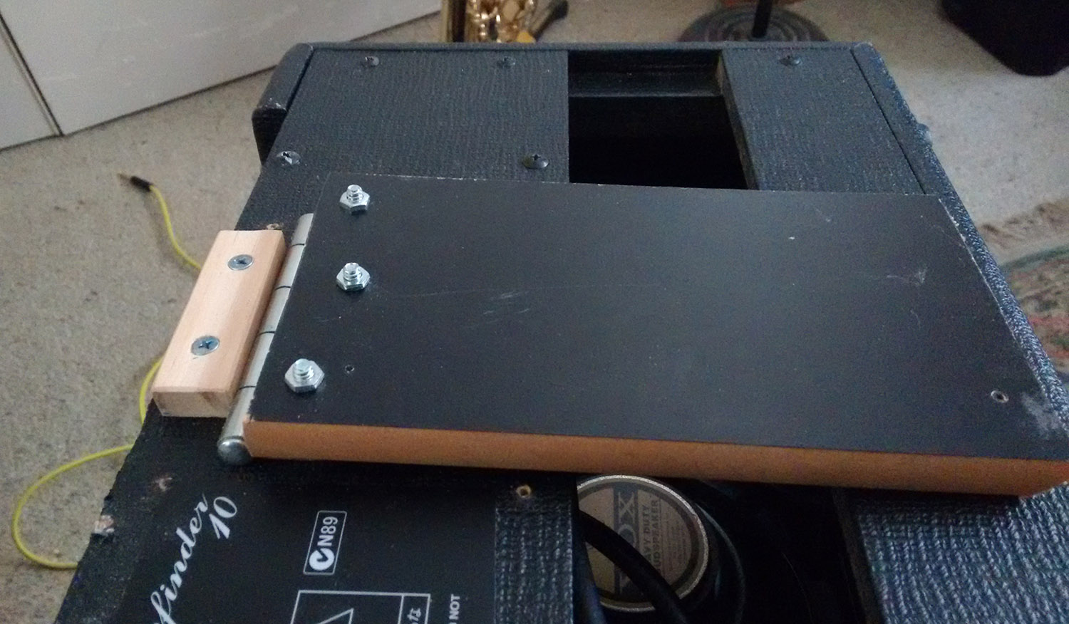

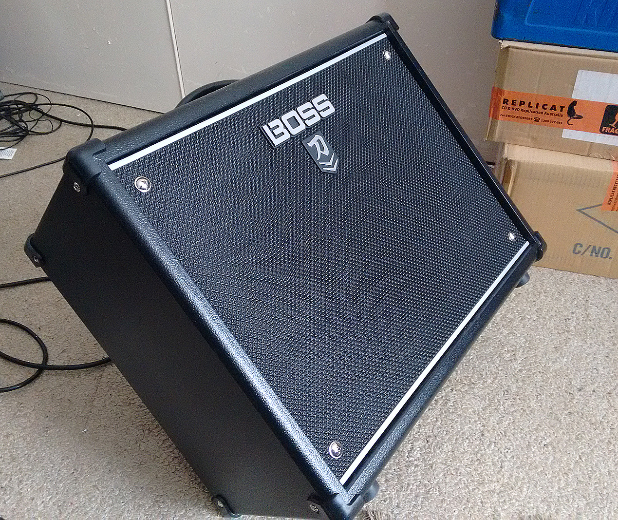

    Rather than start a new thread.
    Decided to re-purpose the Vox tilt mod onto my Boss Katana 50.
    1.2m Length of 40mm X 12mm pine cut to width.
    2 X Zenith 38mm L brackets to mount it.
    Good ol' matt black spray paint and voila!!

    cheers, Mark.
