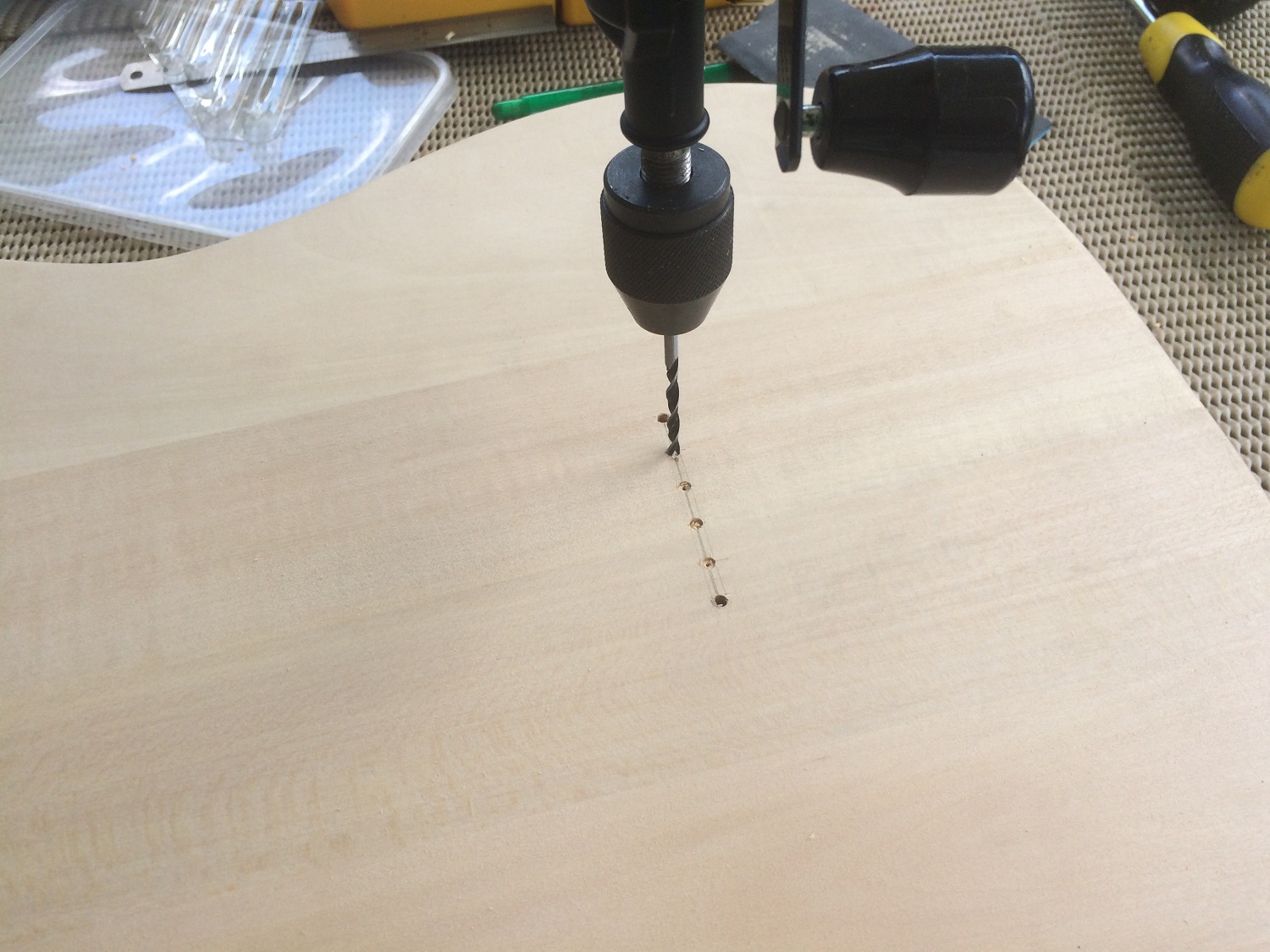

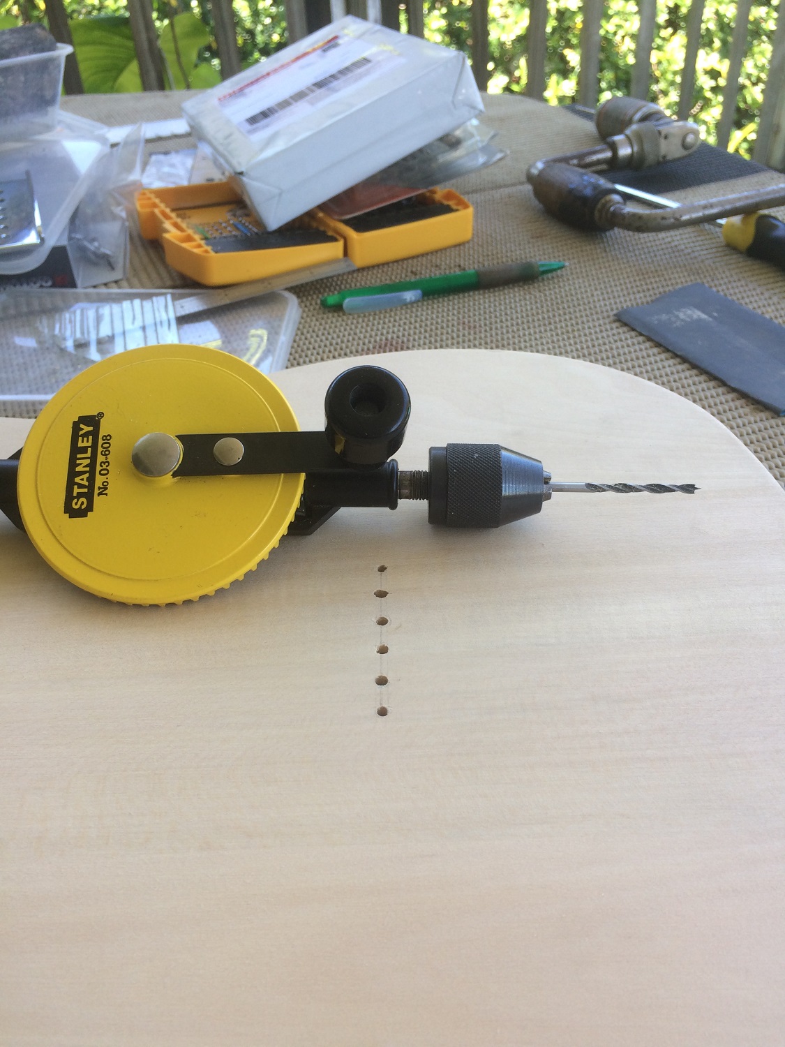

    The top of the guitar. I start with a fine Brad Point Bit for its accuracy and then drill a hole about half way through the body with a regular bit. The tricky part is to drill the 2 outer holes all the way through the body. Make sure the drill is as vertical as possible. This is where a hand drill is preferable to a power drill as a hand drill does not “get away” from you like a power drill. Ask me how I know??

    A bit shabby, but this will be covered by the Bridge.
