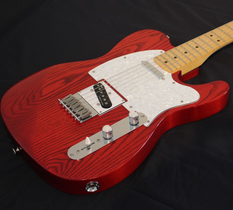

    I used Cherry ColorTone on the ash Tele in the pic below, however the supplier I bought it from sold it "pre-diluted" (my mistake) and it was too light to give the depth I wanted, so I ended up finishing it with U-Beaut Wood Dye (just plain "Red") and used it neat (undiluted). I grain filled the ash with ebony Timbermate, dyed with ColorTone/U-Beaut and then top coated with DIY wipe-on poly.

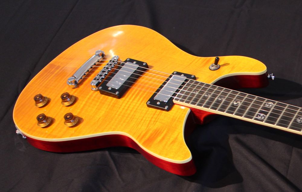

    The PRS-TS1 below, is done with no grain filling, alcohol based aniline dye (mixed by me) and top coated with Tru-Oil.
    These two guitars might give you an idea of what some of your products will look like.

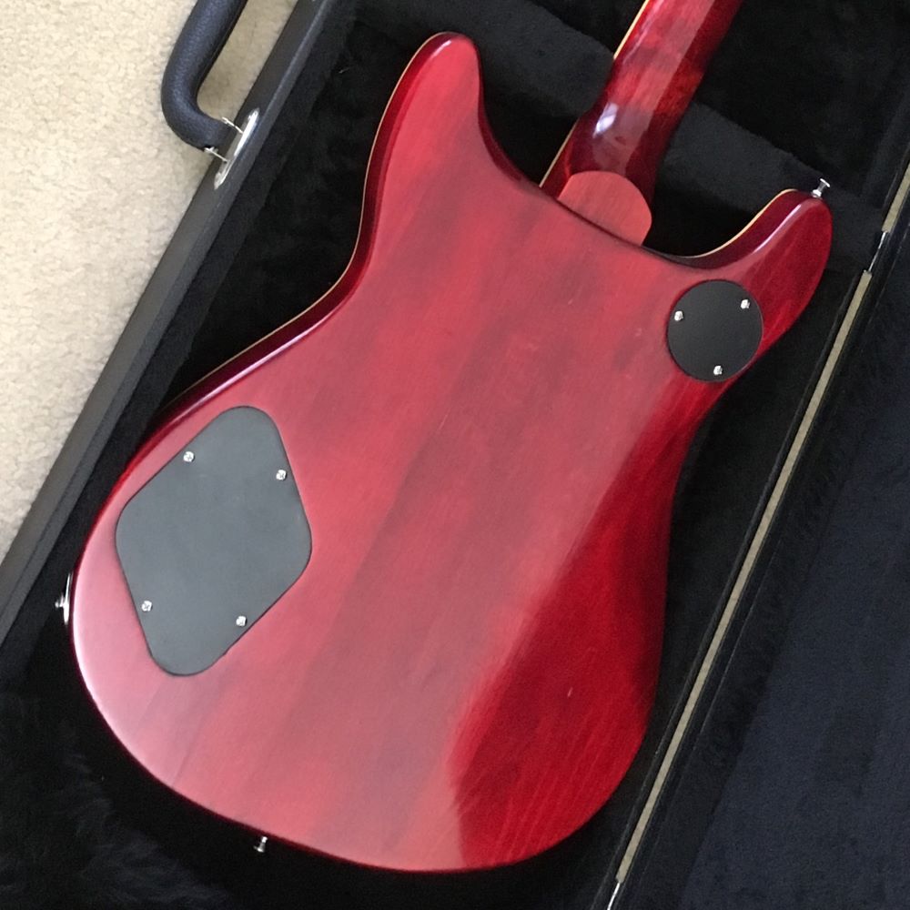

    Here is a pic of the back of PRS-TS-1 which was a mix of red aniline dye powder (in alcohol) and Angelus "brandy". I was going for that vintage cherry vibe. It has Tru Oil over it and I don't think it effected the original colour at all despite the TO having a naturally amber tone to it.
Name:	prs back 1k x 1k.JPG
    Note: the body is basswood and the neck is mahogany.
