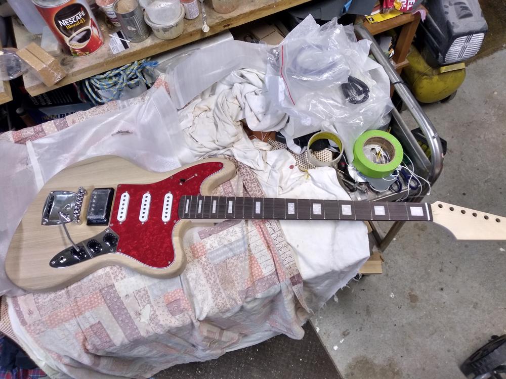

    Thought a baritone guitar would be nice so ordered the JZ-6 kit. Since the pickups are not well spaced I though I would rout out a space for a humbucker i had left over from another kit. The lower 2 single pole pickups I will wire in series and maybe add a switch to be able to choose each single pole individually. Should allow for a wide range of possible tones. I think I will paint this one sea foam green. The kit is quite good and the neck fits snugly. Being ash it will need plenty of grain filling. Head stock shape needs some thought.

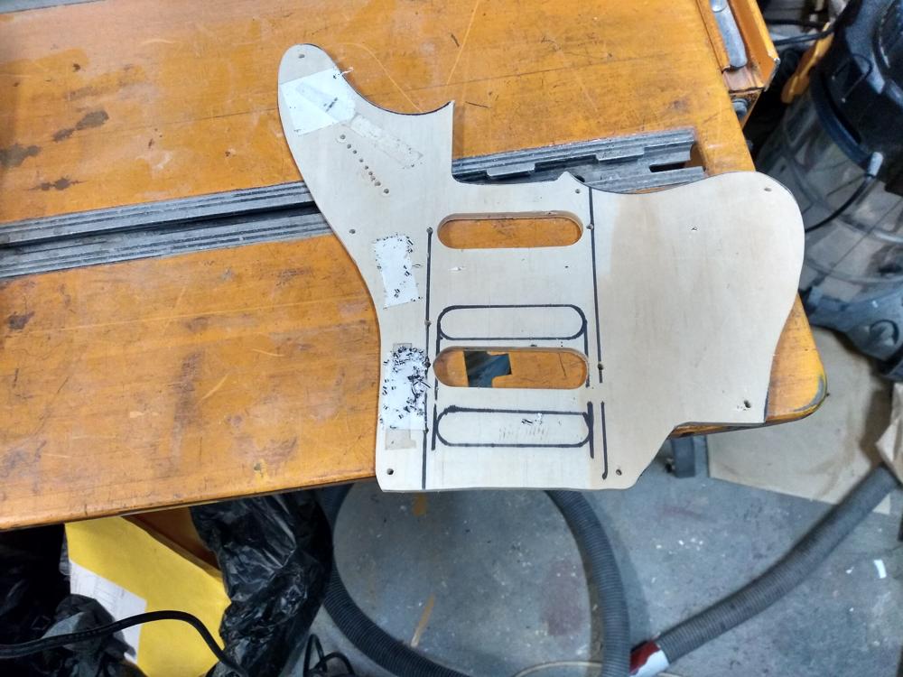

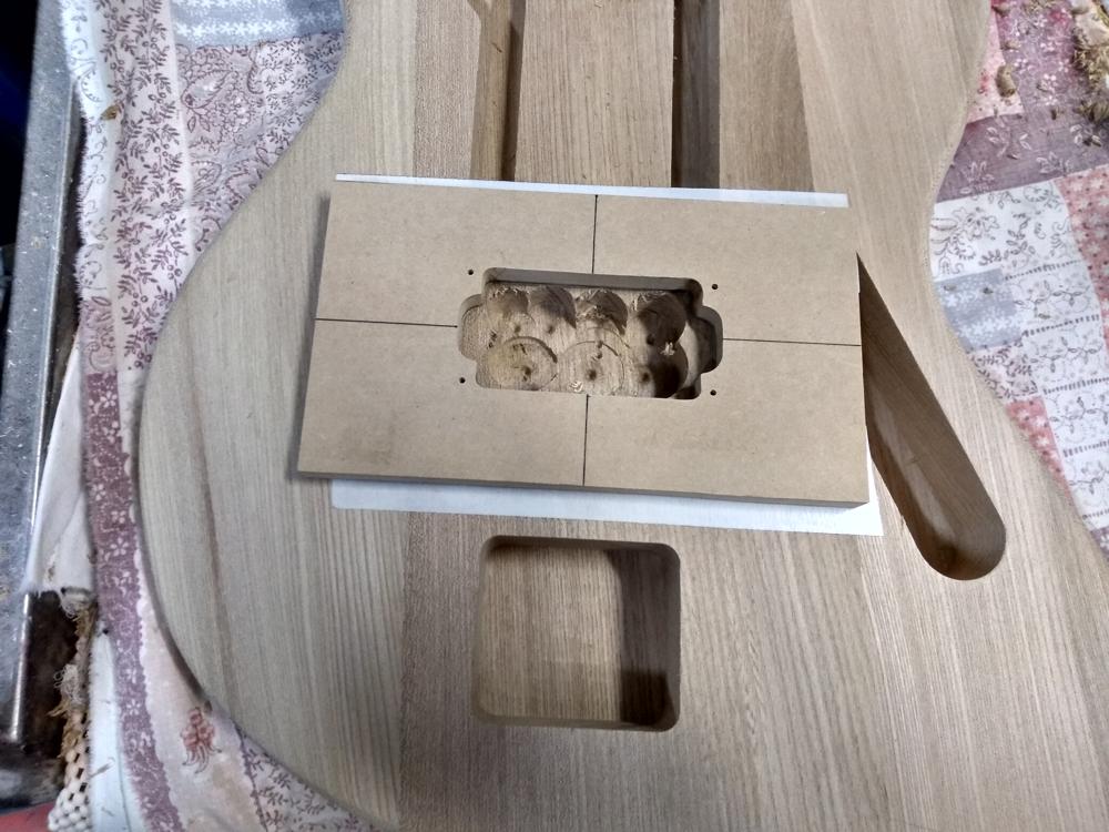

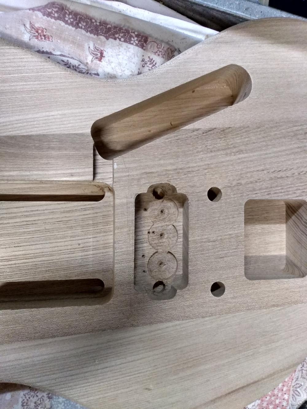

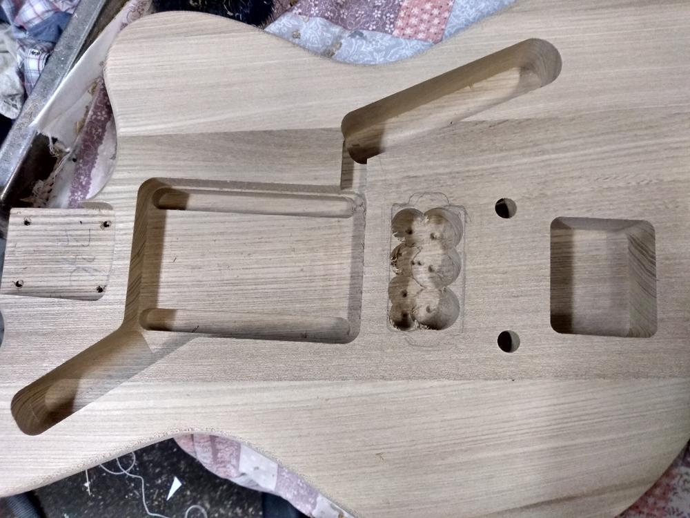

    Rout the Humbucker and Make a pickguard template
    Had a busy day today and routed out a place for a humbucker near the bridge. The humbucker template I got off ebay was very good and made routing quite easy although still scary. I finally decided that 4 pickups was not for me so I got the Triton router table out and made a pickguard template using WeirdBits method. I roughly placed the middle pickup half way between the neck and the humbucker and it turned out ok but not quite square but I dont think it will be noticeable. Have some brown tortoise shell blank pickguard on the way so there is no turning back now.

    Quote Originally Posted by stansby40 View Post
    I roughly placed the middle pickup half way between the neck and the humbucker and it turned out ok but not quite square but I don't think it will be noticeable.
    It feel it will be noticeable, especially to you. It may be worth making another template and get it right now. You could of course angle both the single coils slightly, where any slight deviation from similar angles will be far less obvious.
    You could always try making a basic pickup rout template that you stick over the pickguard one (enlarging the hole in that first) so you can get it fully square.
