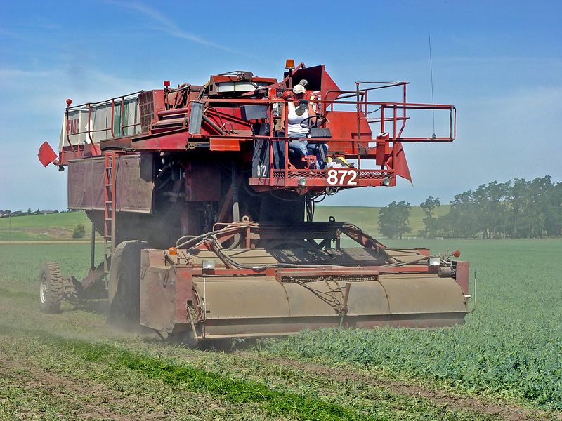

    ...it's like shelling peas.
    Hmmm. I spent a good portion of my youth shelling peas on a machine like this one...

    It was easy, but you'd need a really big garage.
