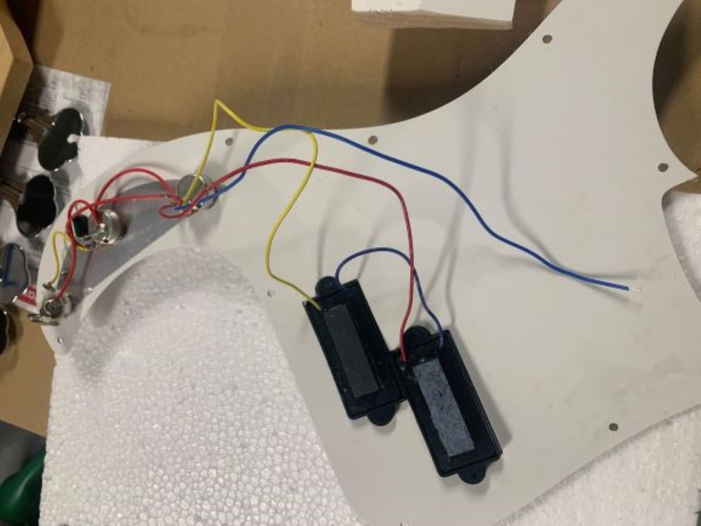

    this is my first build all going good so far some minor adjustments to make things fit. i am stuck on the wiring, the pots and jack are all pre wired and soldered, there is one blue wire not connected i think this for the bridge earth but dont know how to connect it to the bridge there is no hole in the body to get the wire to the bridge. any help would be good
    cheers

    I can't tell in the pic what the blue wire attaches to. If it is the case of the pot then for sure it's the ground wire for the bridge. You will need to drill a hole from under the center of the bridge to either the control cavity or the pup cavity. It helps to have a long bit so you can drill as flat a channel as possible.

    thank you will try to drill the hole

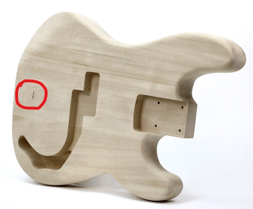

    Are you sure there's no hole for the ground wire?
    The kit should come pre-drilled with a hole to the control rout, positioned under where the bridge will go (highlighted in red). It's at an angle, so can look more like a mark than a hole.

    If there isn't one, then you'll need to drill one, and you'll need a very long drill bit to do that. Look for a 300mm long bit. Partly because its a long hole and partly so the drill doesn't get in the way and you can get the angle correct I'd suggest a 4mm bit. It won't t be easy to get the angle right. You'll need to drill from the top to the rout, you won't be able to drill the other way. It may be cheapest to buy a set, something like this. https://www.amazon.co.uk/300mm-Extra...NsaWNrPXRydWU=
    Drill a small depth vertical hole first, otherwise you'll never get the drill bit to bite and not skid over the surface. I'd also suggest cutting out a wedge of the correct drilling angle from scrap wood that you can lay the drill on top of after securing it in place with double sided tape, and use pencil lines to get the direction right.

    And beware of the chuck or other moving parts contacting and scuffing the body somewhere you don't want it to... Simon's wedge helpful for that too.

    If there isn't one, then you'll need to drill one, and you'll need a very long drill bit to do that. loom for a 300mm long bit. Partly because its a long hole and partly so the drill doesn't get in the way and you can get the angle correct I'd suggest a 4mm bit. It won't t be easy to get the angle right. You'll need to drill from the top to the rout, you won't be able to drill the other way. It may be cheapest to buy a set, something like this. https://www.amazon.co.uk/300mm-Extra...NsaWNrPXRydWU=

    definatley no hole that is OK i was able to drill one using some of your advice, i used a dremel which has a very small diameter chuck <12mm so was able to do it with out damaging the face of the guitar.
