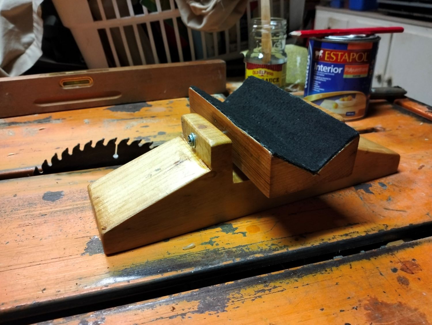

    First up, a neck rest made from some scrap timber, and felt:

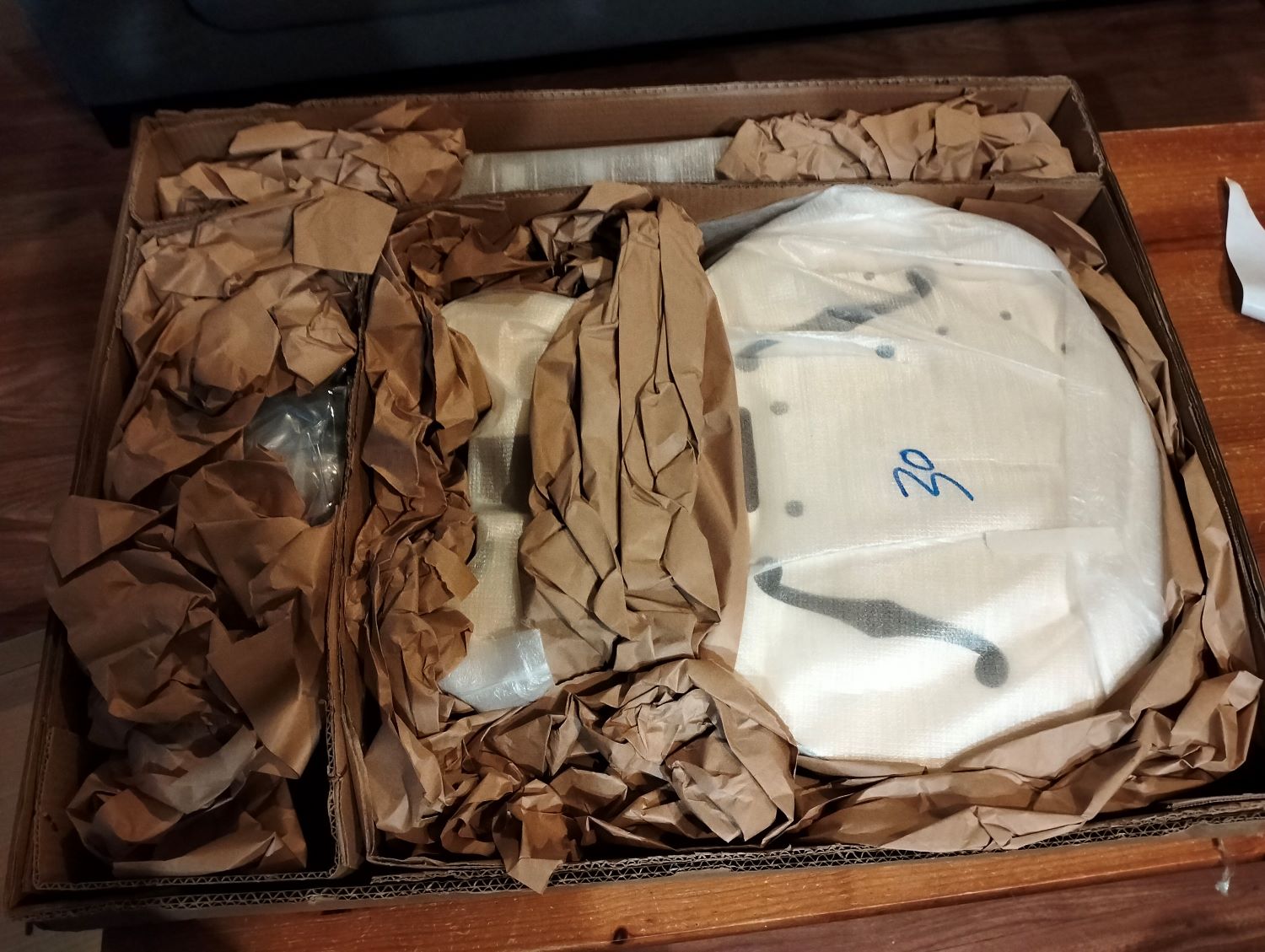

    Here is the kit being unboxed:

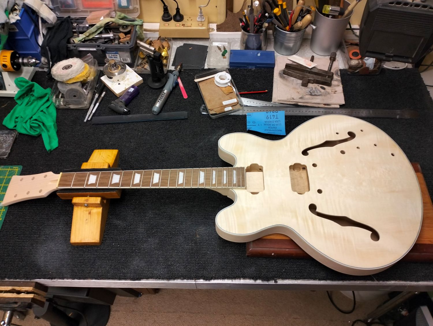

    And here it is with a dry fit of the neck:
Name:	Neck dry fit.jpg

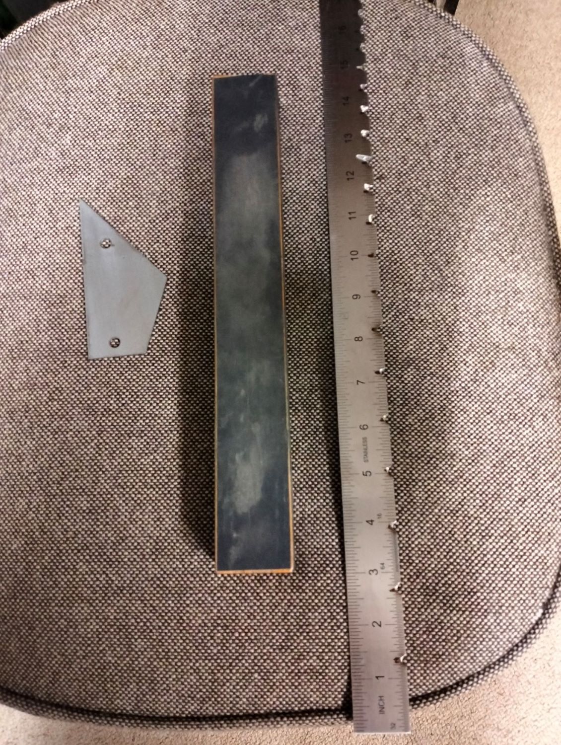

    Made some more tools:
    This is a leveling beam (timber rather than aluminium), a fret rocker (cut from scrap material) and a straight edge from a 600mm ruler with notches ground with a dremel. Way cheaper than purchasing.
    I aslo bought a crowning file and Fret erasers.

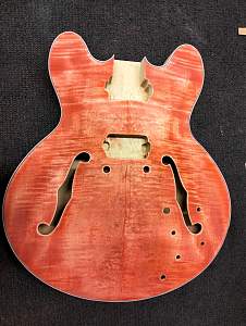

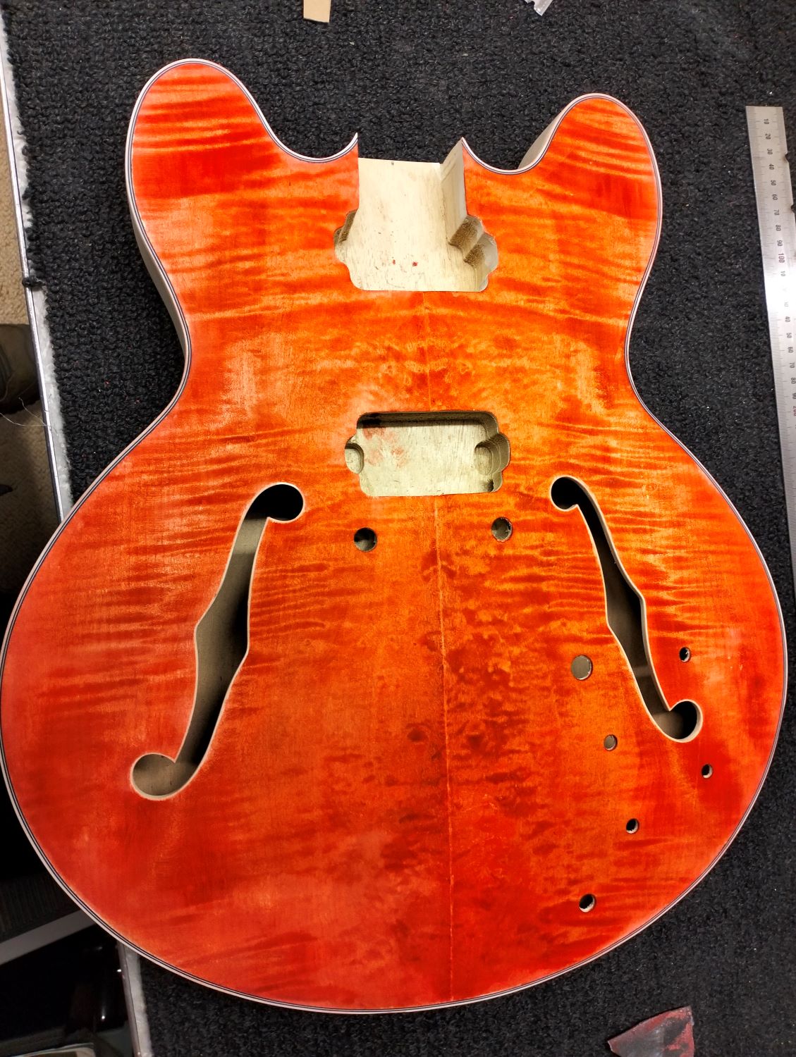

    I bought some cherry red and mahogany red Colortone stains.
    After a light sand of the body & neck I stained all over with the mahogany red (which is darker) to hopefully bring out the flame in the maple veneer then lighly sanded it back:

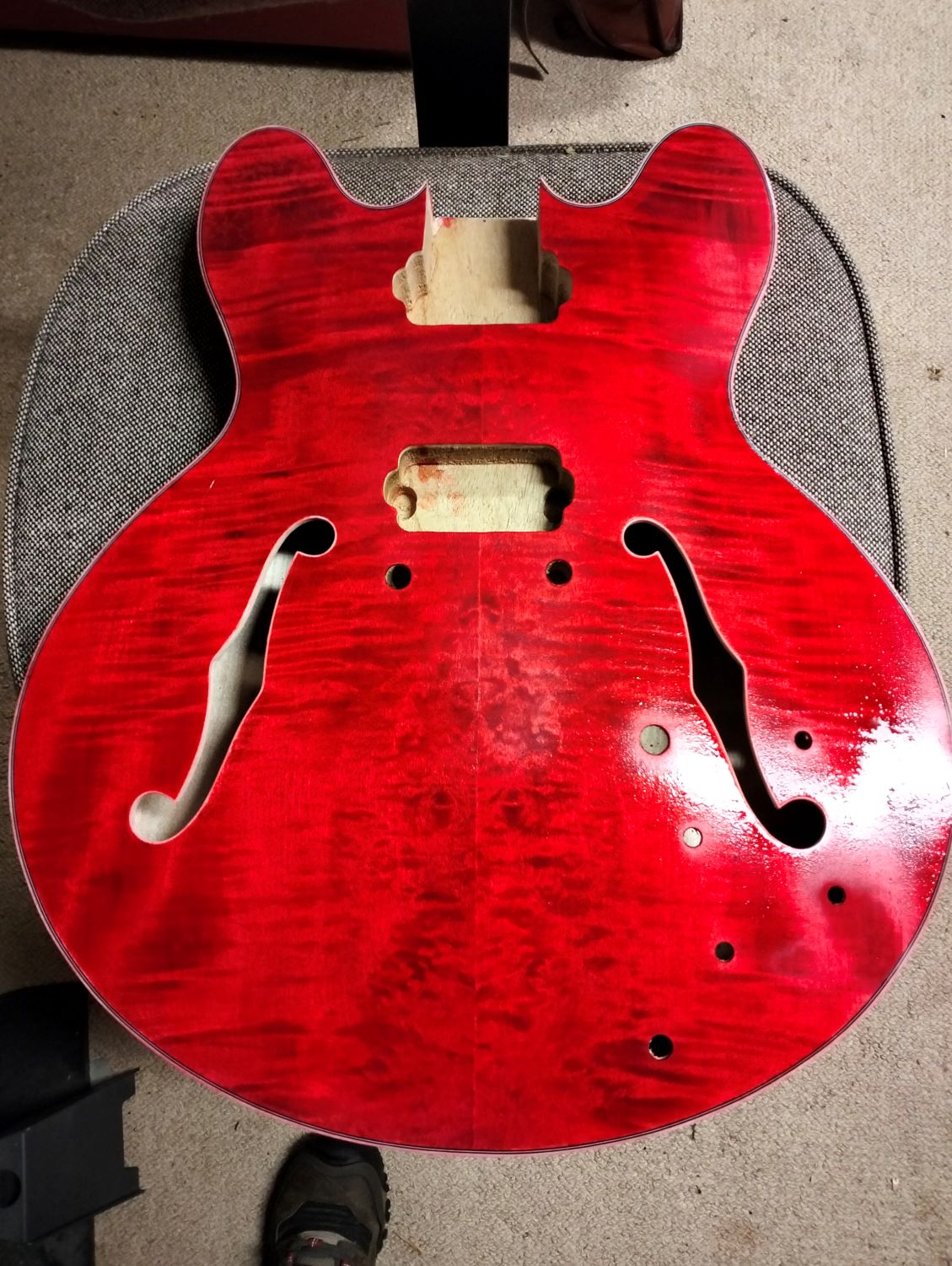

    I then re-stained with the cherry red:

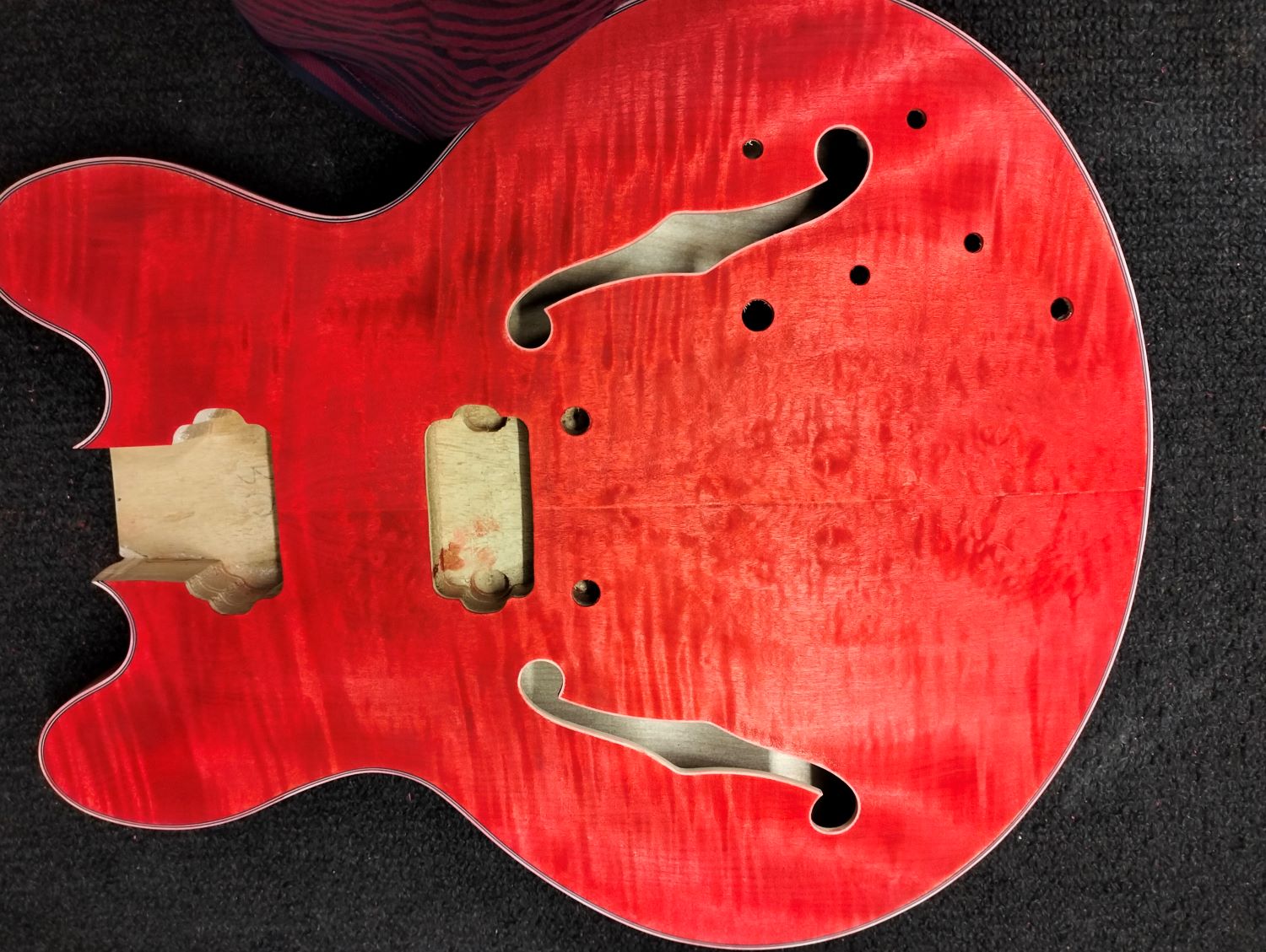

    I then piled on more of the cherry red:
    Then added some mahogany round the edges, just to darken it. I wet it down with a mist of water to get an ide of what it would look like laquered:

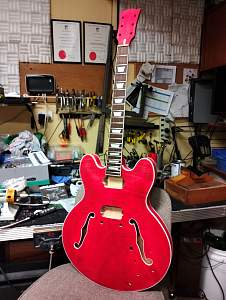

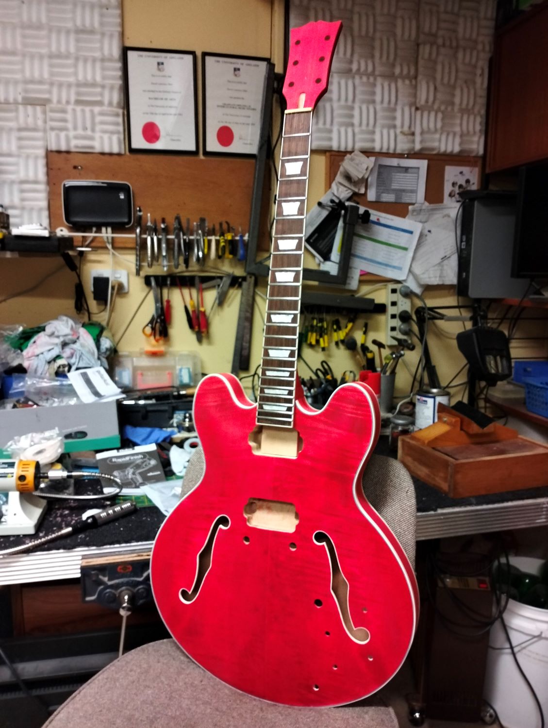

    I also stained the neck and headstock and dry fitted it. Not such a good photo, looks way pinker than it actually is:
Name:	body & neck 2.jpg
    I bought a tin of Mohawk nitrocelulose laquer but unfortunately it is now Winter and too cold to spray so I will have to wait until it warms up.

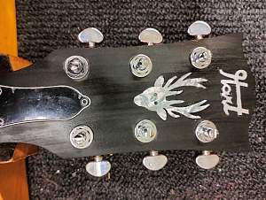

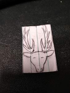

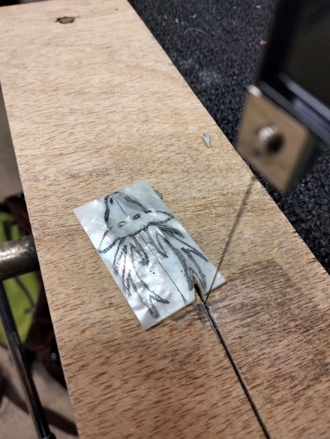

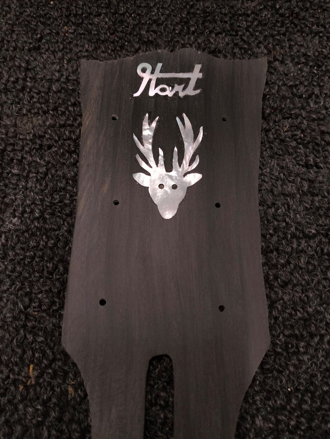

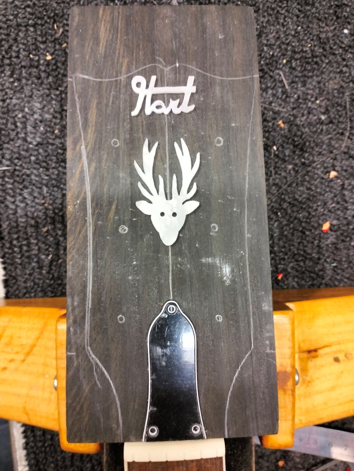

    I can't say that I was that impressed with leaving the headstock plain red and as I have plenty of time until the weather warms up, back to YouTube and online shopping I went. I've seen videos of how to do mother of pearl inlays. How hard can it be?
    Turns out that it is not so much hard as very time consuming.

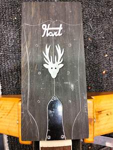

    My surname is Hart and my dad had a keyring with what is probably a family crest that featured a stag. Why not I thought. Many stylised images from the internet later I drew what turned out to be a combination of a few images the transferred it onto some 50x30x1.5mm mother of pearl. I cut this out with a jewelers saw (slowly, going through many blades), then added my surname. I also bought a Blackwood headstock plate which took ages to arrive from China and turned out to be way too thick. I cut it down with my bench saw (tricky that!) then sanded it to 3mm with a belt sander, collecting the dust for later. I also bought a router jig thingy for my dremel.
Name:	inlay design.jpg
ID:	44683 Click image for larger version.

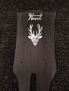

    I traced around the MoP then routed out a 1mm rout and glued it in with super glue. I used additional superglue mixed with the dust I collected to fill the inevitable gaps then sanded the whole lot back.
Name:	Headstock Plate.jpg
ID:	44685 Click image for larger version.
Name:	Inlay complete.jpg

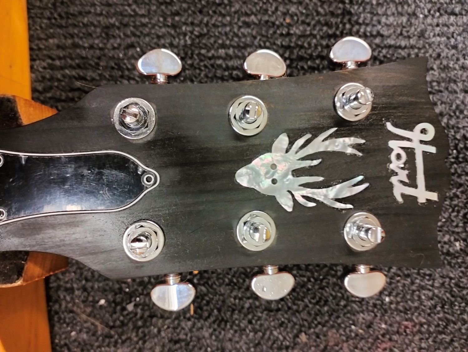

    I then glued the Headplate onto the headstock. I put the machine heads on just to see what it would look like. Came out ok.
    Next time though I will use 5 minute epoxy as I kept losing the fill in the gaps and ended up using epoxy mixed with wood dust to finish it off.
    And the headstock is better dark IMO. Nice inlay work.
    I’d be a bit concerned that 3mm is a bit thick. You’re adding to the overall headstock thickness, so there will be less of the tuner post sticking out. It obviously depends on what tuners you’re fitting, but some have holes lower on the post than others, and with some conventional tuners, you may not be able to get enough turns round the post for stable tuning. Locking tuners won’t have a problem, as there should be less than one turn on them (unless you choose to add more).
    Gibson use black fibreboard on their headstock facings these days, (rather than the holly veneer they used to use) which is about 1mm thick.
