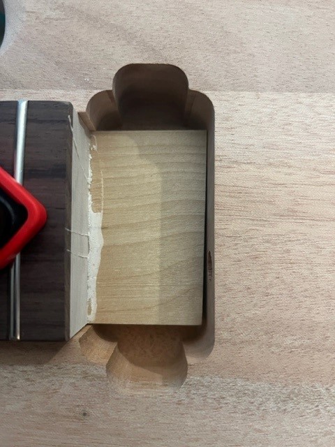

    The scale length checks out but the neck was not an exact fit. The picture below is how it looks when clamped into place, do I need to sand the neck or the pocket in this case?

    Re the pickups, I see no problem with that, but other will have to shime in on that. Re neck, I would sand down if you can get away with that scale lengthwise, or shim if you can't. I have seen pictures of people who glued it in like this without a problem, but you just want to make sure that the neck is straight on the body (therefor I would). Strings could help you in checking the straightness before glueing it down.

    Quite sure that the end of the tongue on the neck does not need to meet the back of the pup route. Quite often there is a gap. Setting the scale length is most important and (I agree with RocknRolf that the neck) needs to be straight.

    Those neck tenons are there to provide more gluing area for the neck and they certainty aren't built to fit snugly against the rear of the neck pocket. I'd position the neck as you've shown it in the photo. You wouldn't want it any nearer the pocket as you need a small ridge left to rest the pickup ring on. I'd sand the glue excess off the rear of the neck, but leave it at that.

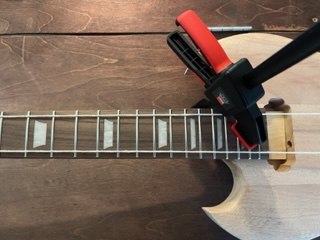

    Thanks for the input on the neck, the scale length was spot on at 30.5" with the saddles set in the middle positions so if can glue it like this I probaby will leave it as it.
    I will put some strings on to test the straightness. These tuners slip in from the back and are held on by 4 screws so my next step is probably algining the tuners and getting holes driled.
    Any tips for test fitting the bridge? This is a 3 point bridge with inserts that let the mounting screws go into them. The PB guide mentions masking tape or tubing but the bridge would never be flush using that method.
    Using masking tape or tubing to hold the posts in is about the only way to test the bridge out for alignment short of pushing the bushings in. You can use masking tape to help keep the bridge in place during testing as there's nothing but string tension to hold it there otherwise and the saddles aren't held in either.
    We'd recommend using ordinary string or thread, rather than bass strings, to test out the neck/bridge alignment. Clamp the neck in place and fit the bridge. Tie a stop knot in one end of a piece of string, pass it through the E saddle on the bridge, up to the E nut slot, down through the E tuner hole, up through the G tuner hole, through the G nut slot and back down to the G saddle. You only need to pull the string with enough tension on the string to see how the strings line up with the edges of the neck. You don't need to put it under full working tension and you can then put off drilling the tuner locating screw holes until after you've applied your finish (it's a lot easier and prevents finish cracks if you wet sand and water gets in the holes).

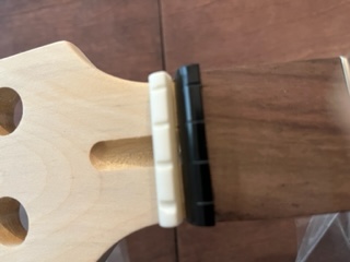

    I used tape to get the bridge fitted and used the string method described above and the spacing looked good. However, I ordered a bone nut with the kit which it came with, but it is right handed. I contacted PB but I guess I need to wait to get that addressed before going further in this area.
