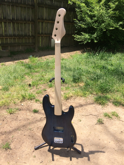

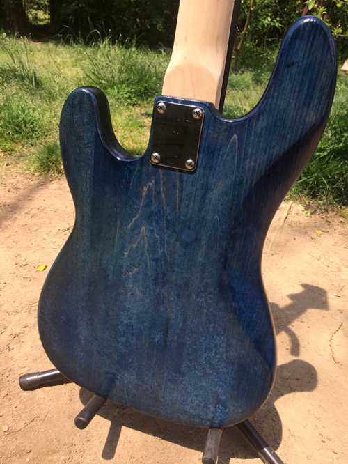

    This is what I have so far.

    Looks good! Very cool headstock. I don't think I have ever seen a maple fretless before. Was that a special order?
    Erm, am I the only one who's noticed it seems to be a string short? I count 4 tuner holes, not 5.....
    I'm sorry if I was unclear. The 5 string is a jazz bass I will be doing for my girlfriend's brother-in-law. This blue P-bass was my payment for doing the 5 for him. I'll post pics of his jazz when I start working on it. I have only seen a few maple fretless fingerboards and they were stunning. I don't know how well it will wear over time but that's part of the experiment! I am still unsure whether I will use CA glue, epoxy or oil on the fingerboard. Yes, it was essentially a special order. The kit came with a fretted maple neck and it was from another website. I ordered the fretless neck by itself from Pitbull. It says on their website that if you order a kit from them (Pitbull), you can get a different neck if you contact them and give them some extra time to match it to the kit. Thanks, my headstock idea was an homage to Leo Fender's original Tele headstock. It was fun getting out the old carving tools and whittlin' in the sunshine!
