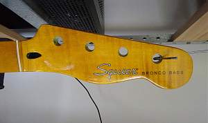

    Co-incidentally using it on my current refinish on the Squier Bronco.
    I will definitely be leaving it to dry for a couple of weeks.
    The body is undergoing a new paint job and will probably also get a White Night clear gloss.
    Pickguard material will probably take forever to show up so there is no urgency.
    cheers, Mark.

    Hi Colin no worries. I've done about 4-5 coats with a light sanding with 400 grit in between.
    To knock off the orange peel and bury the decal edges.
    Not shown in the picture is that I have removed the frets.
    I appear to have gained an obsession with 7.25" radius necks.
    This is the 4th one in production at the moment with 2 completed.
    cheers, Mark.
