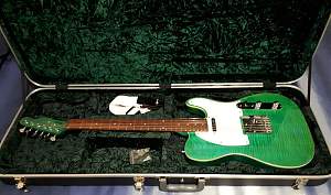

    As for where I'm going with the build; I'm hoping to build a guitar capable of being used for heavier tones, like the Swedish Buzzaw style associated with the Boss HM-2 pedal, but also suitable for melodic songs like this
    So I want to go with a finish that shows the grain of the wood rather than the typical matte or gloss black that is generally associated with heavier styles as I feel like that pairs with my musical interests more than a flat-colour finish would. The whale blue PRS guitars are where I'm mostly looking for inspiration for the finish, but I'm also leaning towards using the bondi blue Dingotone finish.

    As far as the finish goes, I've just used Angelus Leather Dye on my TLA-1Q build and have been very happy with them. Would be easy enough to thin down to dilute the colour a bit as well if you didn't want it quite as dark.

    I looked into the Rit clothing dyes and other peoples experiences with staining their guitars with non-wood stains/dyes and kept being led back to Angelus leather dyes, and your TLA-1Q looks absolutely stunning, Woltz so I think I have been sold on that now. I'm now looking at a green stain on the top and a dark brown stain on the back and headstock.
