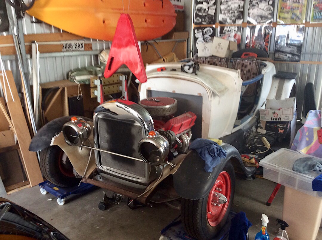

Nice Rodger! Very Hotrod aesthetics to that build!

Something a lot newer than the body. I can't make out any identifiers on the motor. Is that a'32 body, Whats the grill from?
Holden 253, Stage 2 cam, Edelbrock Performer manifold, Holly 450
Over bored 0.030. Built to cruise.
29 Model A. Four inch stretch in the body so we have a bit more leg room.
Grill is standard Model A. Moved forward to accomodate the stretch and motor.
Ah cool. I knew there was something going on but I am not familiar enough with the early girls to pick it. Looks like you've put the holden cross member in as well? Sensible idea, I do have a soft spot for the I beam from a looks perspective, but the handling and safety upgrade of doing the independent front end can't be understated.
Cool rig, I got rid of my workshop ornament a couple of months ago. No regrets, but I still find myself casually looking around for another car project, its a sickness.
