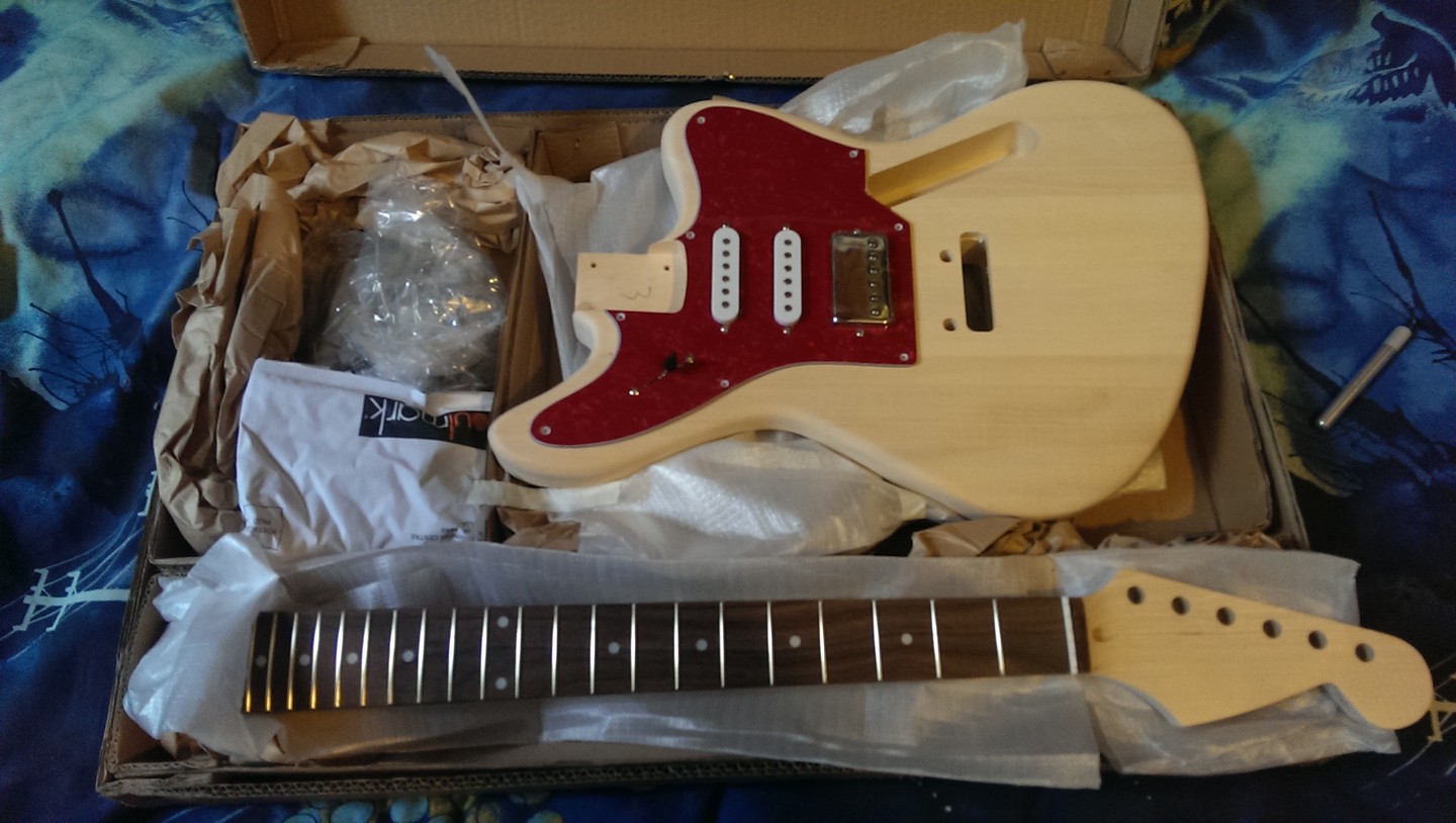

Guess what just turner up at my house!!!
Attachment 18208
Attachment 18208
:eek: :D :o
you will be a busy boy Nitro, what are the plans for the JM-1 ?
Im going to make a Jaguar Replica, at least thats my plan.

Bonus the other half wants a bass, looks like a YB-4 kit ?

ordered a set of GFS Jazzmaster pick ups for my JM kit on the weekend wanted something better but $ are tight :cool:
no idea, they are still in Florida LOL

Will try to use the std jag switches, ive sourced them allready, but will need a lot of help with the jag scale, not quite sure what to do so any advice will help. i have seen a jag bridge on a fender strat but dont know if he used the longer scale or adapted it.
you've got a couple of options, I think the easiest would be to use a jazzmaster pickguard (blank or a blacktop one) and modify to suit the jag switch plates and using the strat style trem with the kit. If you want the jag scale you'll need a new neck and I don't think that's viable.
check out my build below where I modded the JM1 kit pretty heavily.
http://www.buildyourownguitar.com.au...ghlight=mashup
WOW WHAT AN AMAZING BUILD. Thats what i want to do, chuck the strat bridge and use a stang or jag bridge. Can yo post some pics on the measurements and work done when you recessed the bridge assenble. I definately dont want to change the neck to a 24, i want to do the mods using the 25.5 neck, and im not too worried about the authentic jag sound. in fact id rather use a gen. mustang bridge, they say they dont go out of tune as easily. btw thanks for your help, much appreciated....
