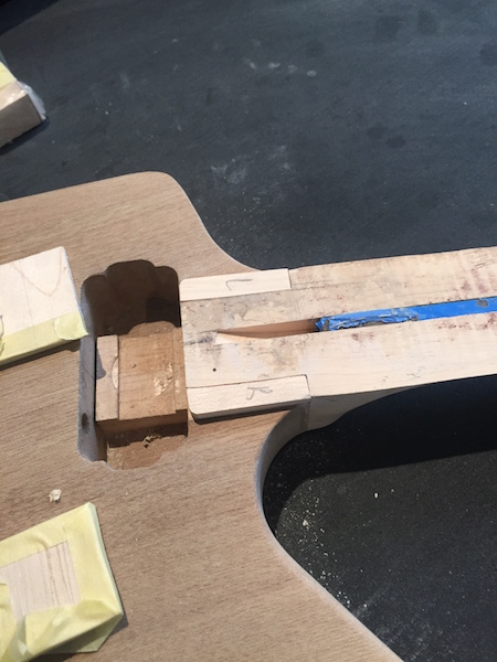

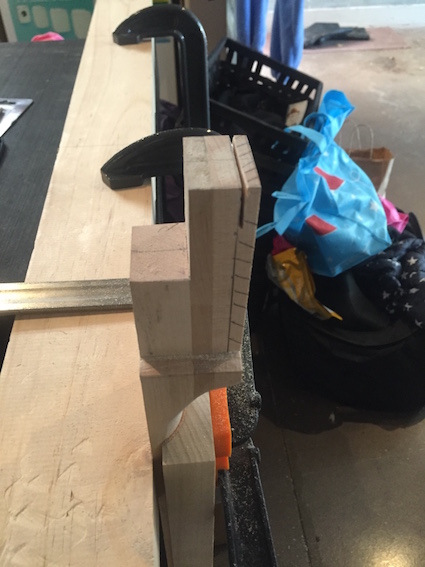

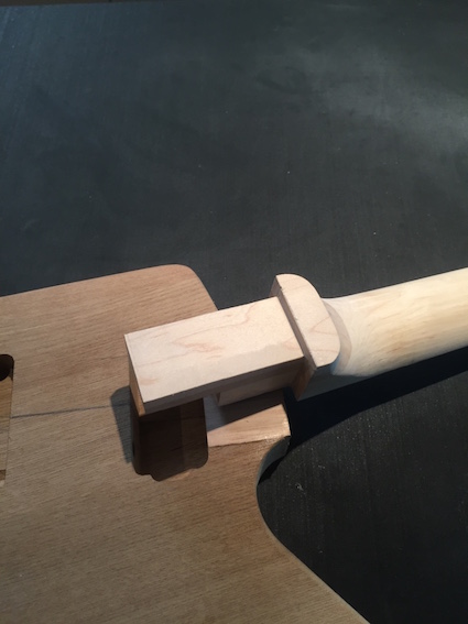

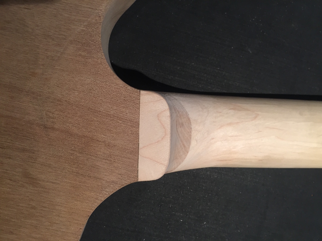

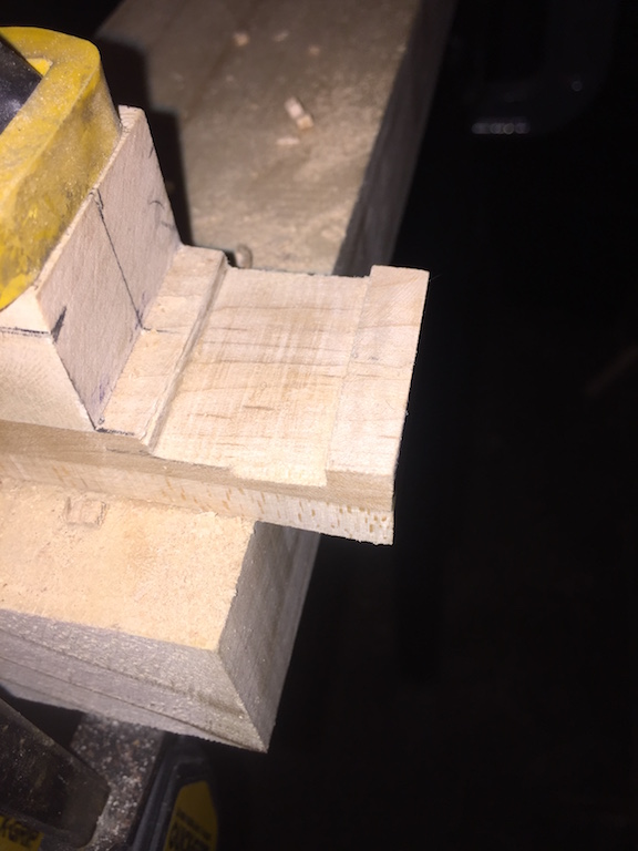

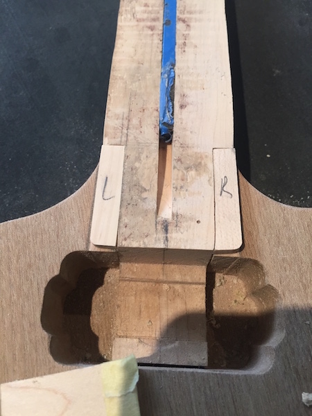

So I began to size up what would be required to do what I envisaged.

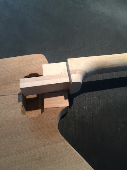

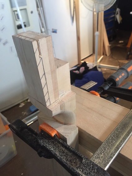

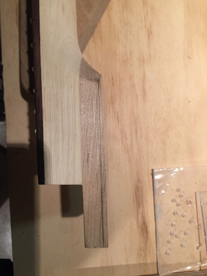

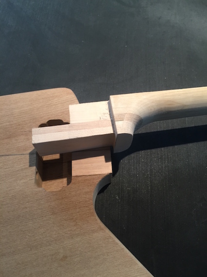

The solution to 1 (from my viewpoint) was to level the wonky neck heel, laminate some additional material and reshape it to leave the back of the neck heel flush with the rear of the body.
Just because I like to make life hard for myself, I also elected to reshape the neck end into a traditional Gibson style tenon and fill and re-rout the neck pocket to suit it. In order to do that, i would need to strip the fretboard, I consulted the Oracles (Adam & DB) who wished me luck but foretold of woe to come.

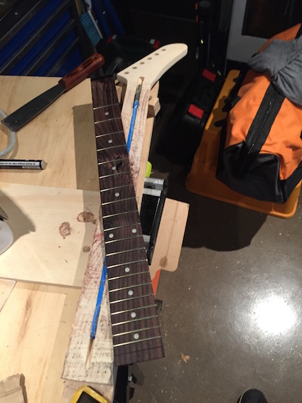

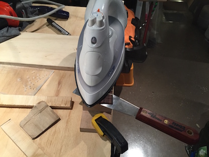

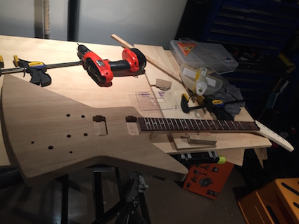

So I set to it, attacking the fretboard with a steam iron and some improvised tooling, i was not gentle but was comforted to find that the fretboard came away grudgingly but in accordance with the wisdom gleaned from Youtube and other sources. I managed to separate it without destroying either neck or fretboard. I then started measuring, and marking and measuring some more
So far progress to date is:
Battery Box rout and cable run completed
Neck pocket filled
Fretboard stripped (Undamaged)
Neck Lamination and rough reshape done
And all of this without even starting on the sanding!
