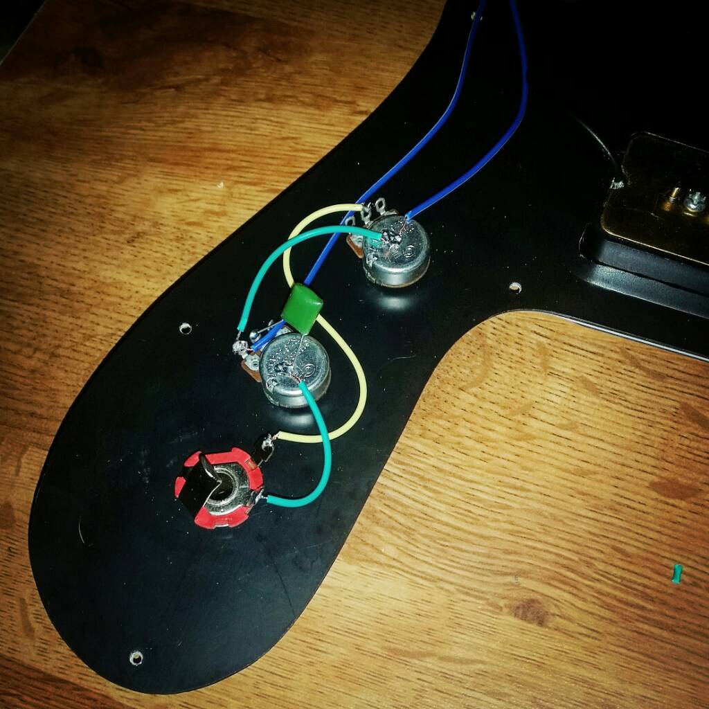

Attachment 9445 I am not very good with wiring so I'm doing what I can to make this one nice
Sent from my SAMSUNG-SM-G900A using Tapatalk
getting there JBird, be worth putting copper shielding on the bottom of the pickguard, or at least run an earth wire between your tone and volume pots - solder to the back of the pot casings.
You also have to earth the volume lug to the back of the casing, the lug closest to the jack.
You probably haven't got to this yet !
I plan on grounding it all just haven't go all the way through it yet
no worries JBird thought that might be the case
So wiring sucks!!!! I can't figure out why I get no sound except for a loud buzz when I touch the screws holding the pups to the body or the 3 way switch... its frustrating the hell outta me!
