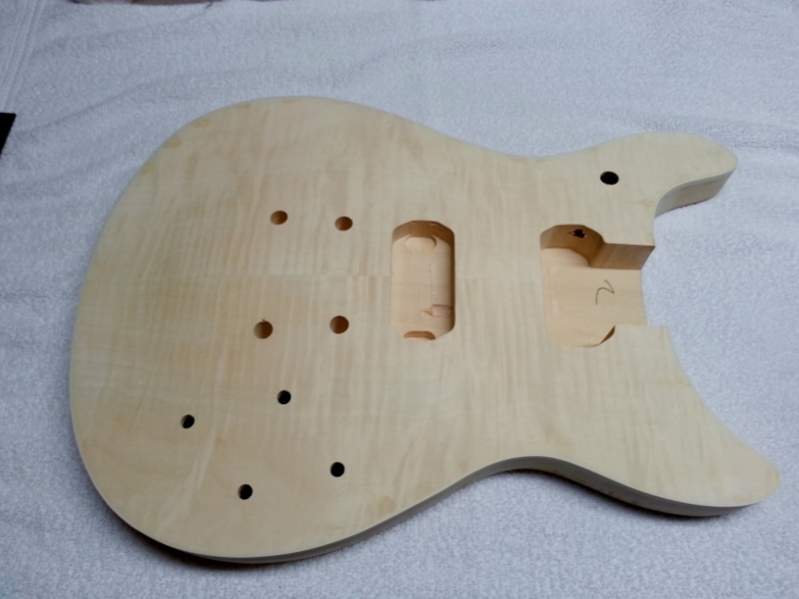

The body of the Guitar looks great. I can see some clue around the binding on the woo, but I figure than should sand out.

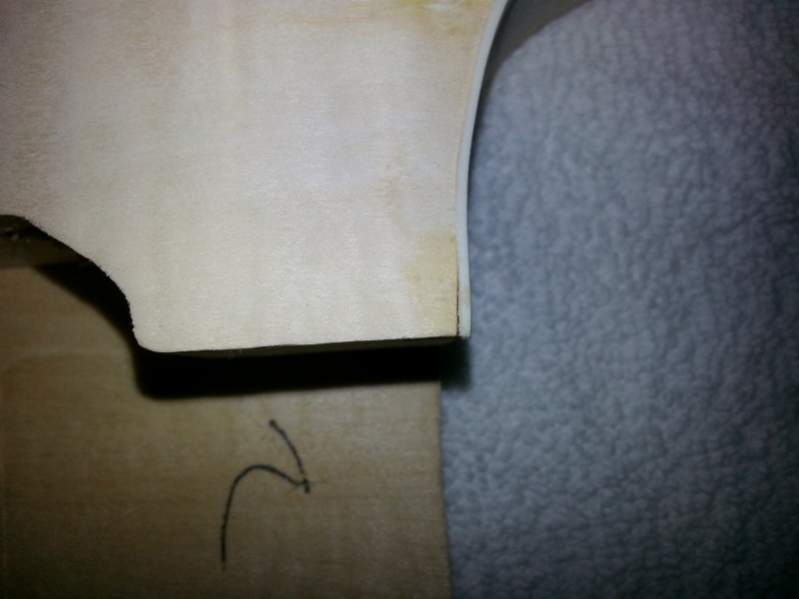

But I did find one issue. The binding on the top of the guitar at the neck has pulled away from the wood. Hopefully a little titebond and some tape and I can get this stuck again.

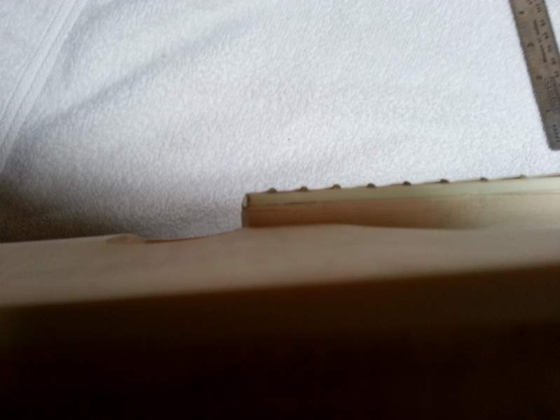

The last issue or perhaps it is a non-issue is the neck and the body. It seems really high over the top of the body at almost 12mm. It is however, fairly tight which makes me confident that I won't screw it up. Feedback would be greatly appreciated
Plan for this week is fix the binding and do initial sanding of the body using 220 grit paper on my orbital sander.

Bit of glue on the binding I'd use superglue and tape it up tight, try and wipe off any excess glue before it dries.
I've attached a pic of a PRS I built a while ago, different model (PRS-1S - spalted maple cap) but it's a set neck and my fingerboard is about that proud from the body so with a tune-o-matic bridge should be ok. Does your neck rake back like a LP guitar does about 3 degrees from memory ?
I think my PRS does.
I'd order your hardware and to a mock build and get a long ruler to see what the string action will roughly be.
Welcome to the forum and good luck with the build. As Wokka said, superglue (CA) is your best bet for the binding fix, ideally a medium/thick variant so it doesn't seep. Also, the 'flame' caps/tops on the kits are usually quite thin so be very careful when you start sanding the top, less is better.
Thanks for the tip on the binding. Due to my years of building R/C planes I have a lot of experience with CA type glues. Some thick should do the trick, be fast, and much easier to clean up.

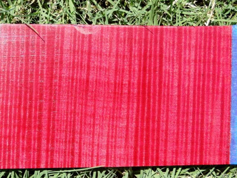

Yeah I saw that, was just too worried it is a more salmon like pink. I can start really light an work up with the transtint. Here is a sample I found that made me think it is the way to go.
Attachment 1312
that's a nice shade of pink, the flames should look excellent
Even a black initial coat, then sanded back would really make those flames pop against the pink, would be a cool contrast.
It's gonna be a great build either way.
I am worried about using black. I think when I sand back if I can't get all of the black off it is going to darken up my pink. I was thinking the dark burgundy after sanding back will let me keep my pink relatively light.

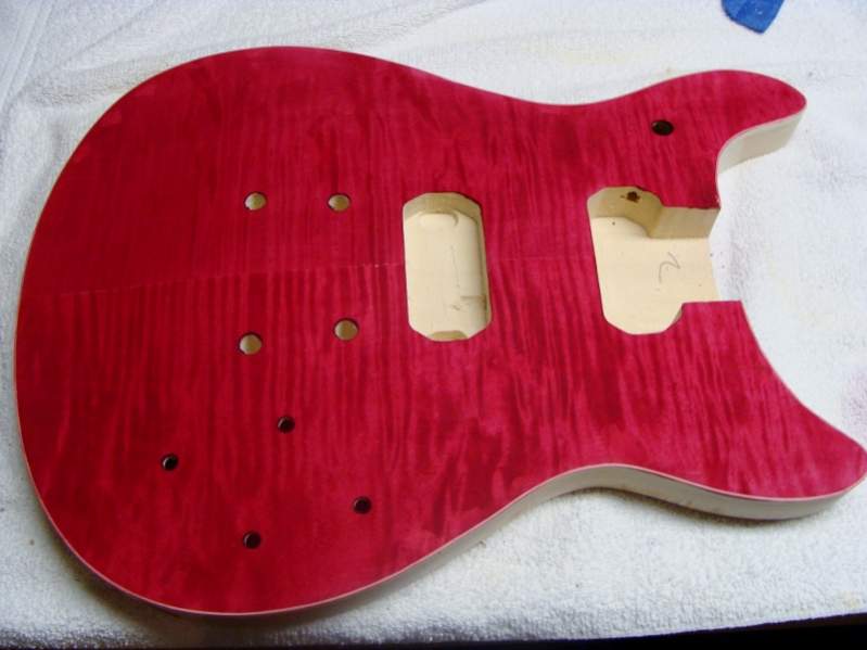

Sanded, Sanded, Sanded, Did my coat to sand back. I can see some fingerprints. I even used a metal brush around the binding, hoping to avoid glue and fingerprints. Any suggestions.
You can see them at the top left of the guitar.
Hey Flowman, that looks amazing that cap, the stain really brings out the lovely flame.
Those finger marks with glue, all I can suggest is to put a darker burst edge on, if you sand any more you risk sanding through the thin cap.
