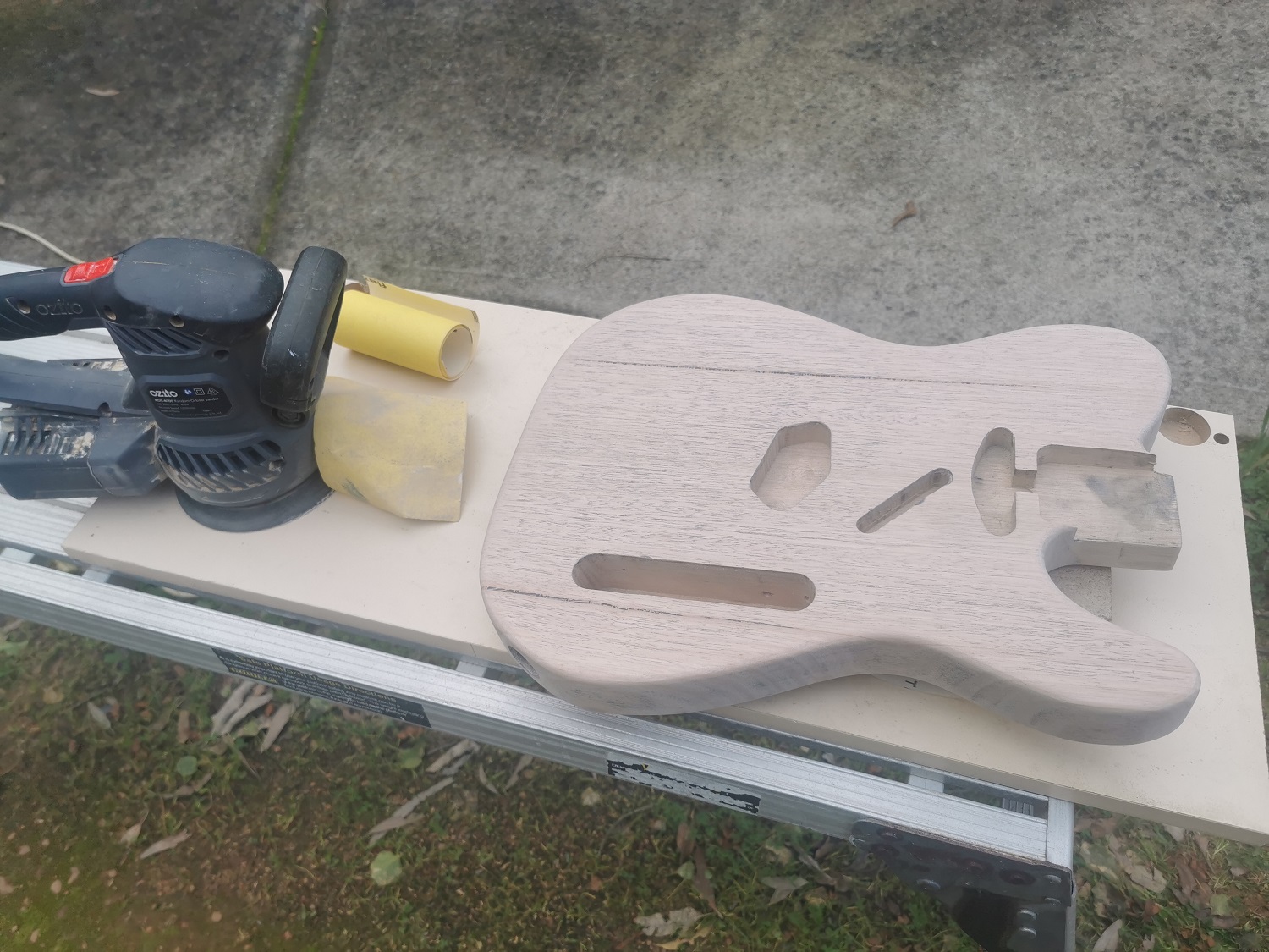

A side view of the completed body, ready for finish.
https://i.imgur.com/K8bvxT8.jpg
After routing, rounding over, and sanding. I learnt a lot from this, mostly what not to do. It's a good thing the bridge, pickgaurd, and control plate will cover most of the sins.

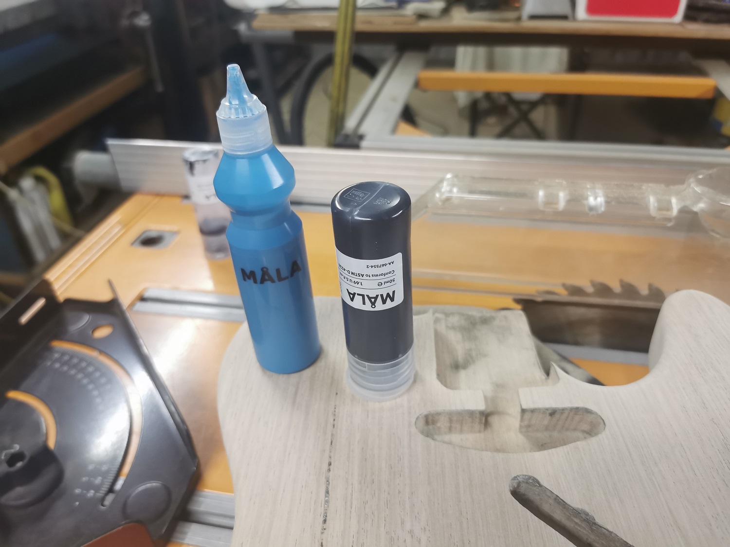

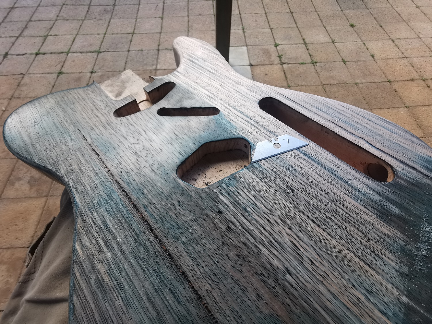

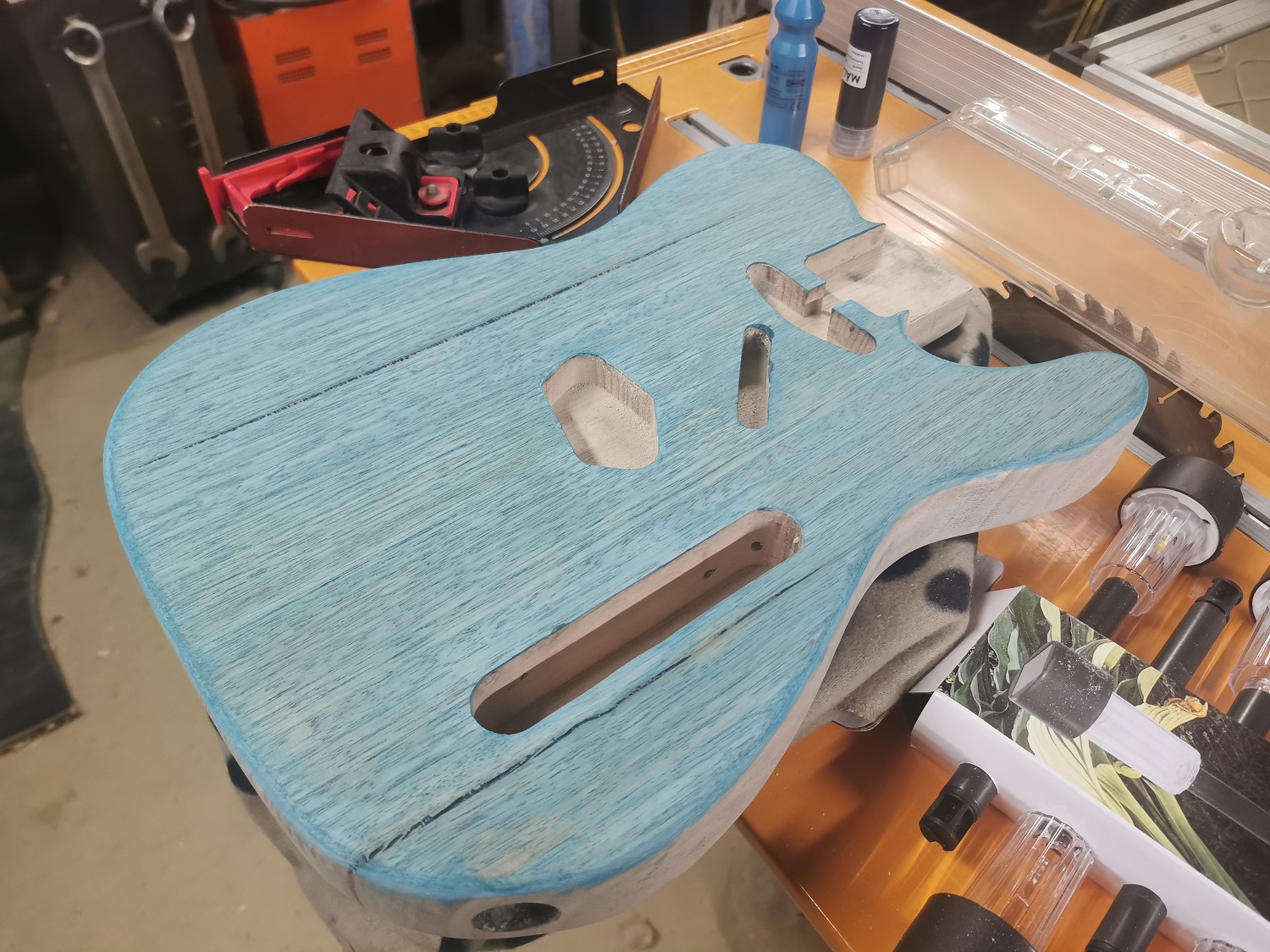

The final finish on the body. I wiped on blue acrylic paint, and then applied a couple of layers of Black Hard Wax over the top. This filled the grain and gave the body an "antique" look. I'll likely complete the finish with a microcystalline wax for further protection.
If I were to do this again, I would apply the blue acrylic paint, then a black wash to get the antique look, and then clearcoat the body with poly or lacquer instead of wax.
https://i.imgur.com/egdsgWq.jpg
Another view of the front. The "cracks" are purely cosmetic inclusions in the wood and don't cause any weakness issues.
https://i.imgur.com/kztstBi.jpg
I'm really happy with it. I know it's not for everyone, but I wanted something a bit old and distressed looking. Mostly because I knew I wouldn't be able to put a really nice finish on it.
https://i.imgur.com/5xskScN.jpg
The back and sides are pure black hardwax with no other pigmentation. I wanted to the front to be a contrast.
