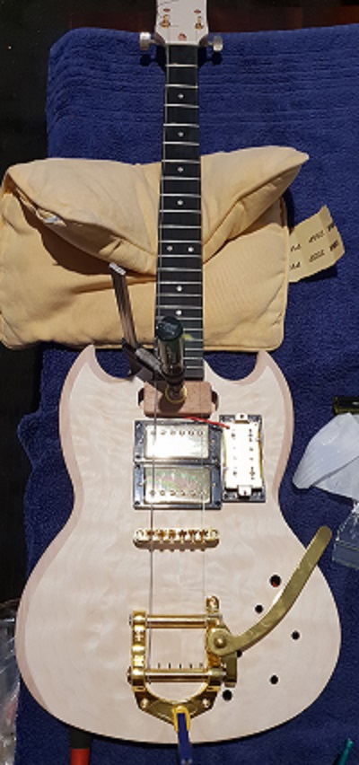

Start of my mock build Attachment 33674
Printable View

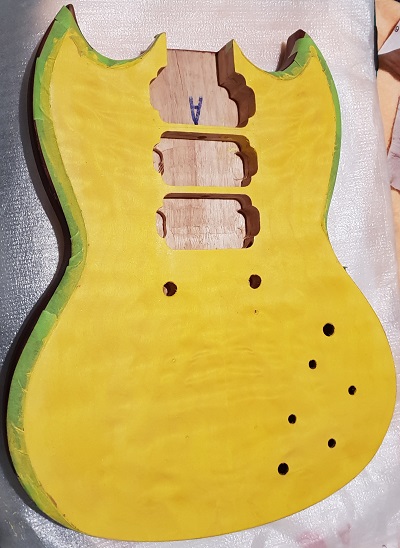

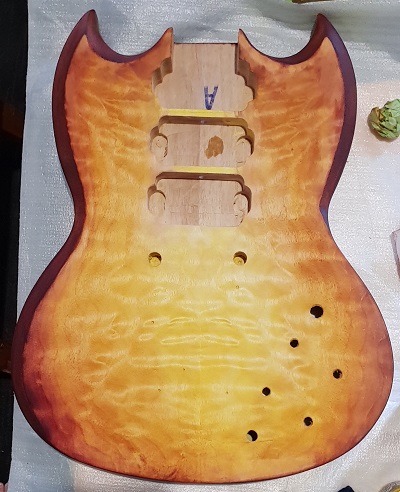

My Stain job - Sealer and pearled stain Attachment 33675

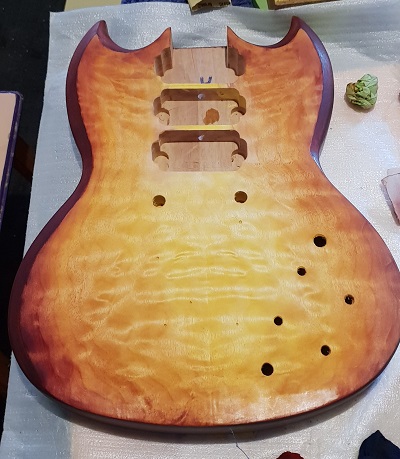

My Stain job - just a little more to do. Attachment 33676
My Stain job - just a little more to do. Attachment 33677

Shall we keep this one alive, because I love the look of that!
Thanks, RocknRolf. I'm a follower of Sonic Mountains quote "What I lack in talent, I make up in enthusiasm."

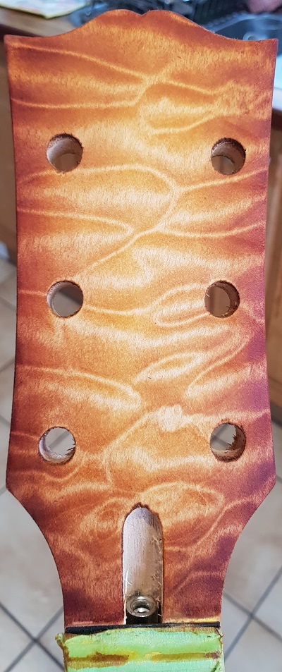

First build-Head Stock Attachment 33685
Wow! That's lovely grain on that headstock.
That'll feature nicely with a nice gloss clear coat!
And work on the body too!

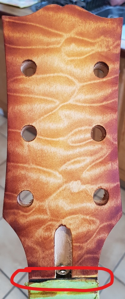

There's currently a thin line of unstained veneer by the nut on the headstock. I'd use a small paintbrush and get in there and touch it up, as it will become very annoying over time if you leave it.

Anyway, that line will be covered by the nut as the nut has been removed. Thanks for the comments.

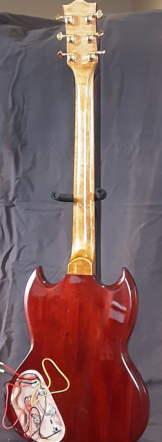

Its been a while.
Left a mark on the back of the neck joint gluing the neck last night. clear coat seems to be a bit soft still.
Need to sort out the wiring for the 3 pickups, proving to be a bit of a pain with the parts supplied. Anyone have any ideas of how to best wire this guitar?
Attachment 37053Attachment 37054
There’s no simple answer as you’ve got two basic wiring schemes to consider. See this thread. https://www.buildyourownguitar.com.a...ad.php?t=10660
Thanks. It seems that in a majority of instances when dealing with a 3 pickups, 3 way toggle, two volume and two tone controls is to convert a tone control into a third volume control and convert the tone control into a master without getting into fancy wiring and switches.
Ill try this first and see how it goes.
