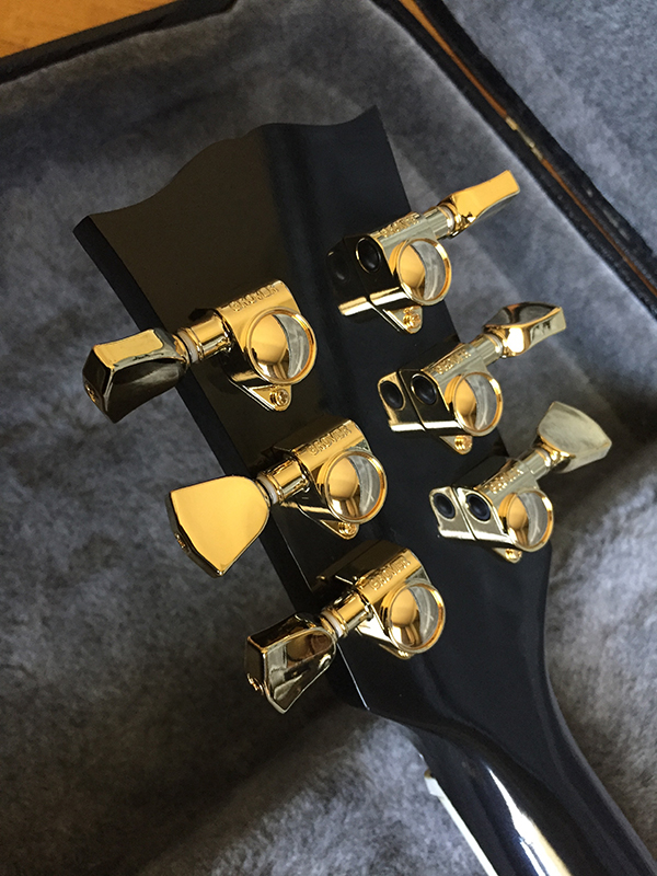

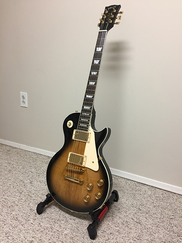

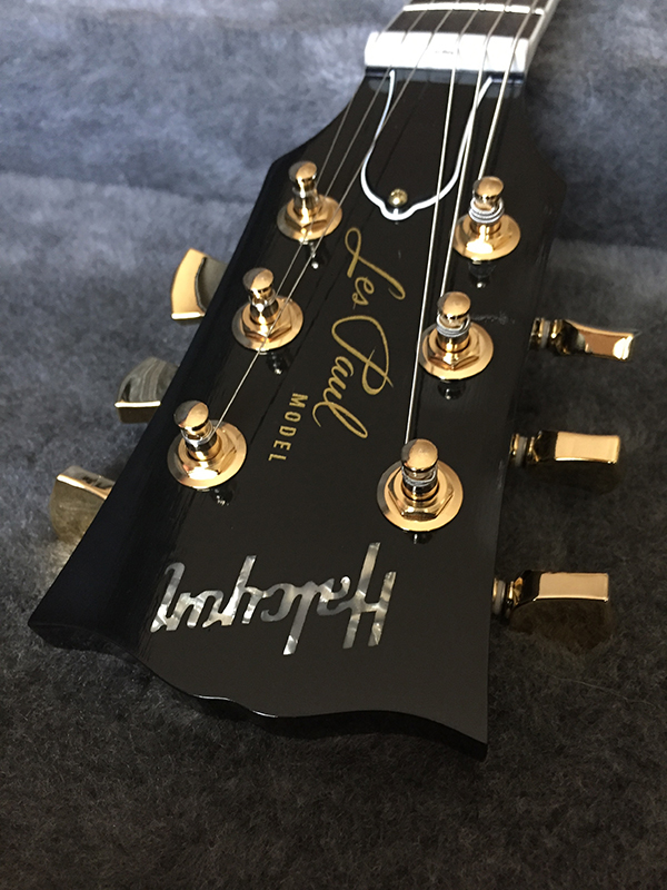

A couple quick pics after final assembly
Attachment 25998Attachment 25999
Wow that looks fantastic. The black finish is so deep and shiny!!! Well done
Outstanding. Really. I keep coming back to look at the pics.
Great result and build. Looking forward to your next one.
