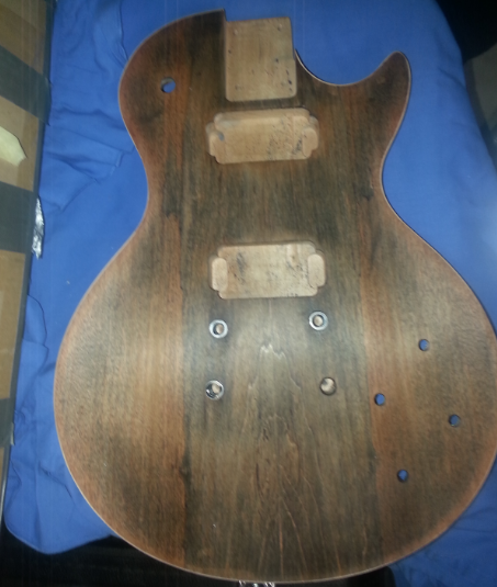

So here it is at present(this is the one with the neck issues and way too much ink with the timbermate):
Attachment 11413
Alkay.
Forgot to mention. That was with the 2:1 mix of cedar and water.
I thought it wasn't dark enough so while it was still wet I put more coats on.
To the eye I still want it darker but I'll let it dry overnight and see.

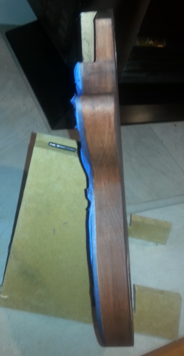

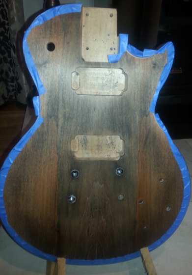

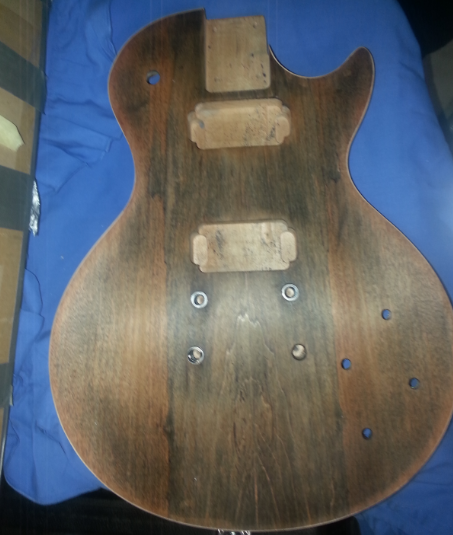

Hi again, so it's been a few days but here's an update:
Attachment 11487
And another:
Attachment 11488
And another:
Attachment 11489
And one more haha:
Attachment 11490
Alkay.
Hey Wokka, I'm getting there I think, but the photo's don't show it. I'm really happy with this one so far.
This site is full of info, it's difficult to find a sanding and finishing technique on the neck so if you could share a link that would be great. I did naughty oil on my last one and that was difficult to play.
Would a wax finish work?
Hi Alkay, the body is looking good. Sanding the neck don't think there are any video's or tutorials. It's pretty straight forward. Once the headstock shape has been cut sand the headstock face top to bottom with the grain. Sand the sides as you would sand the body sides. Sand the back of the headstock face same as the front - top to bottom with the grain. Sand the back of the neck from headstock to heel and I don't use a sanding block - cup the sandpaper in your hand and hold it in the shape of the neck and sand HS to heel. I start at 120 grit if it is rough, or usually 180 grit is ok and go through to about 400 grit.
Wax wouldn't be very durable for the neck so I suggest a Dingotone neck kit or use whatever you are using for clear coats on the body. I found naughty oil on necks work very well. Maybe with your other kit give the neck a good polish and it should play pretty slick.
Good luck !
