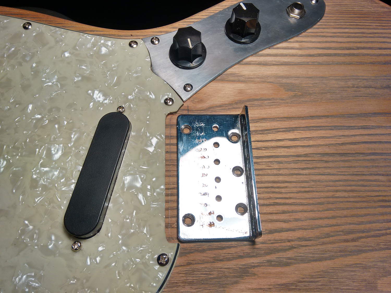

Relocating the bridge will also highlight another issue.
Attachment 35961
It appears that the ground wire hole will coincide with the string-through holes.
Attachment 35962

re: ground wire hole - IIWM, I'd plug the lateral hole with dowel then fill the top bit with 2-part builders bog.
No ones going to see it and that stuff is drillable once it's properly set (if it's mixed properly). The ground wire hole be drilled again in a more appropriate location.
Yes, but probably slot a drill bit down there to get an idea of the angle required for the second ground wire hole first.
cheers, Mark.
I have a 6" x 1/8" (150 x 3mm) bit that I use for doing those. (from the BGS)
They're good because the extra length of the bit allows a decent angle without the drill chuck hitting the top of the body.
I'd love to have right angle drill though.
edit to add:
Should have included that in lieu of a right angle drill, if you have a rotary tool that has a flexi-shaft attachment (my Dremel does) it can be very handy for this application. You have to use the lowest speed setting though, or the long bit gets a bit unwieldy.
Thanks for the tip McCreed. I think I have a long bit kicking around, however I certainly have the flexible attachment that came with the Ozito rotary tool.
Never actually had to use it but it's now something to check out.

Meanwhile I've 'fixed' the position of the bridge.
Still no sign of the switches showing up so I decided to restring for a test.
Low E still goes back a fair way, but much more flexible with the spring.
Attachment 35970

Looks better. You'll need to cut the new screw lengths down or else you'll have problems with the string coming up from the bottom if you are going to rear-load them.
Hi Simon.
Yes, I cut down about 5mm from the high E and B screws.
Attachment 35994
