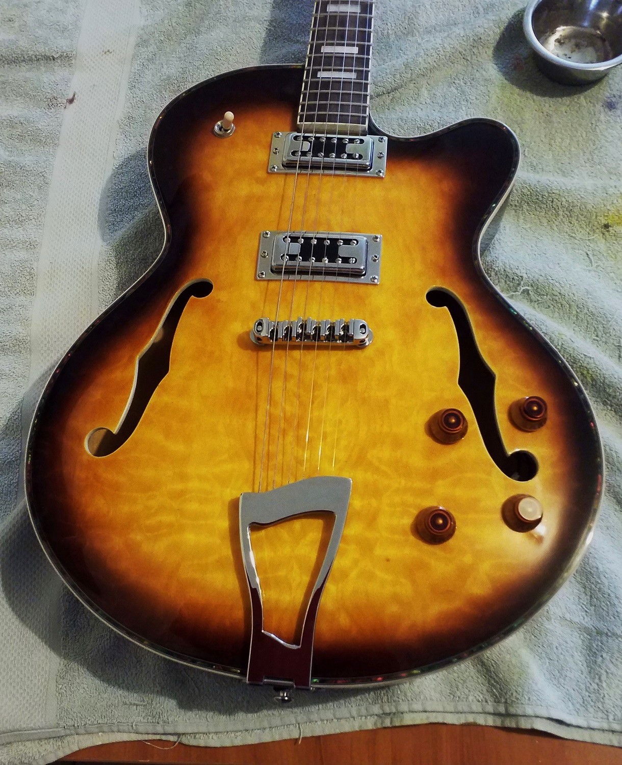

cheers guys sonic wanted me to do something other than a strat lol was a bit worried i wouldn't be able to play it but was OK as its quite light pic's dont do it justice, so got another hollow body EX on the way going to do something bit different on it, these hollow body take a lot of work definitely not for noobe you want 2 or 3 build under the belt before you try one of these very easy to get wrong tested me at times but it was a enjoyable build to do quite pleased with it

Hi Phozin, lovely work! That’s an interesting looking bridge on your hollow body, can you tell me what type it is? Cheers.
hi its a roller bridge it uses a 6mm holes for the posts where a tunematic uses a 10mm gibsons use a 6mm as well you need a blank body or dowel the hole and re drill it i have a couple on a couple of my builds really good for keeping in tune i quite like them

Thanks for the details.I do have a blank on the way, I’ll look into them.
