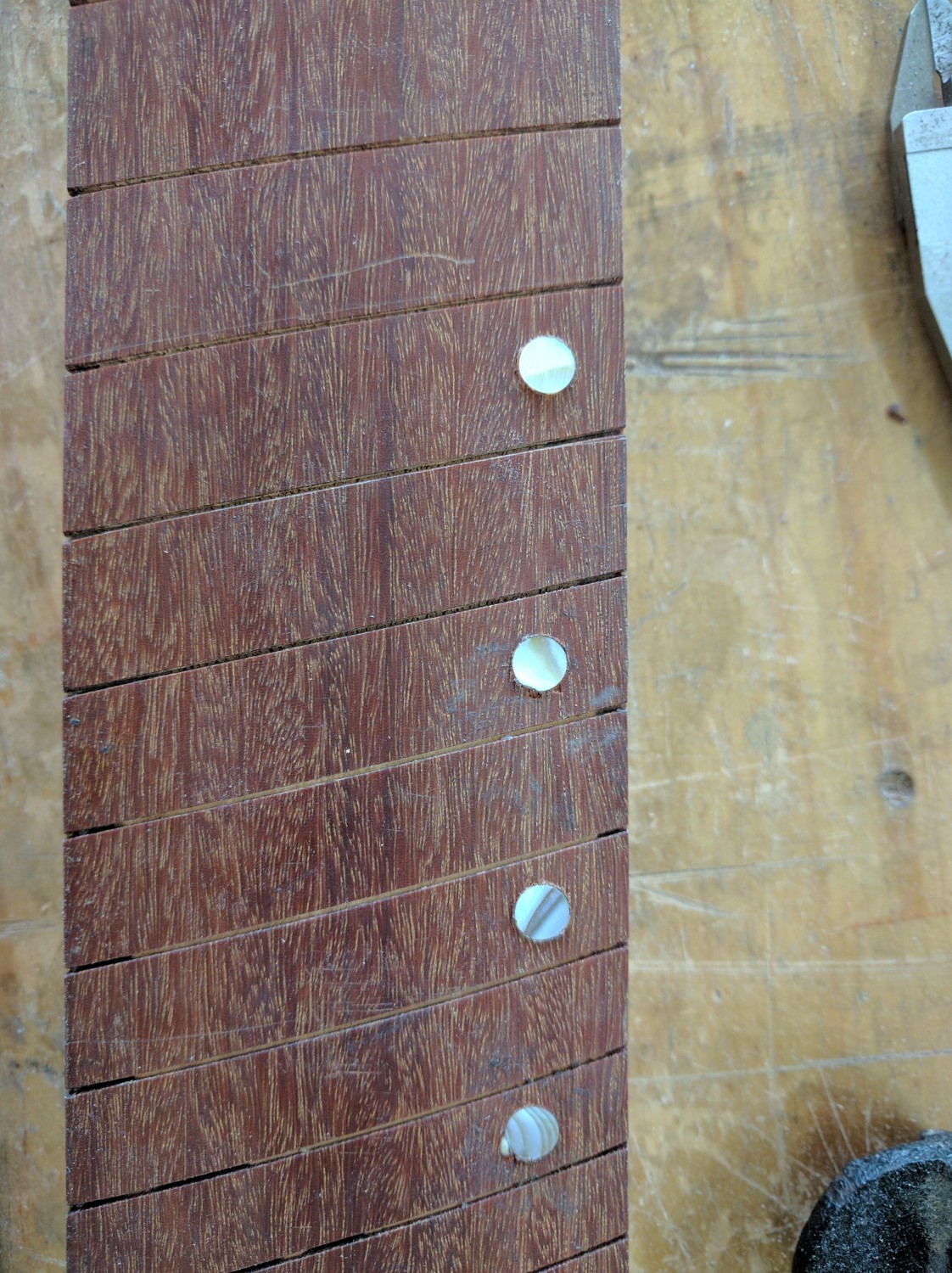

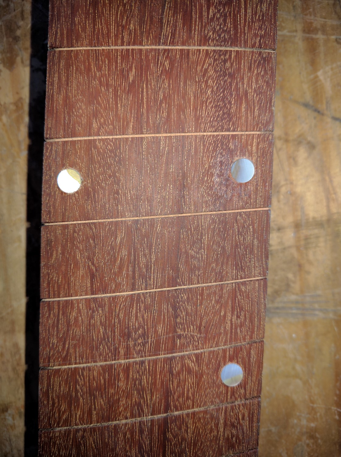

First up was inlays. Opted for Black Lipped Mussel (as nice as Pāua is these stood out compared to the dark red a little better). There was a really nice variety of colour in the pieces, and I tried to arrange them a little bit by how light and dark they were. Lighter near the centre of the fretboard, darker towards the outside.
Attachment 13601
Attachment 13602
Attachment 13603
Look at this one. So nice.

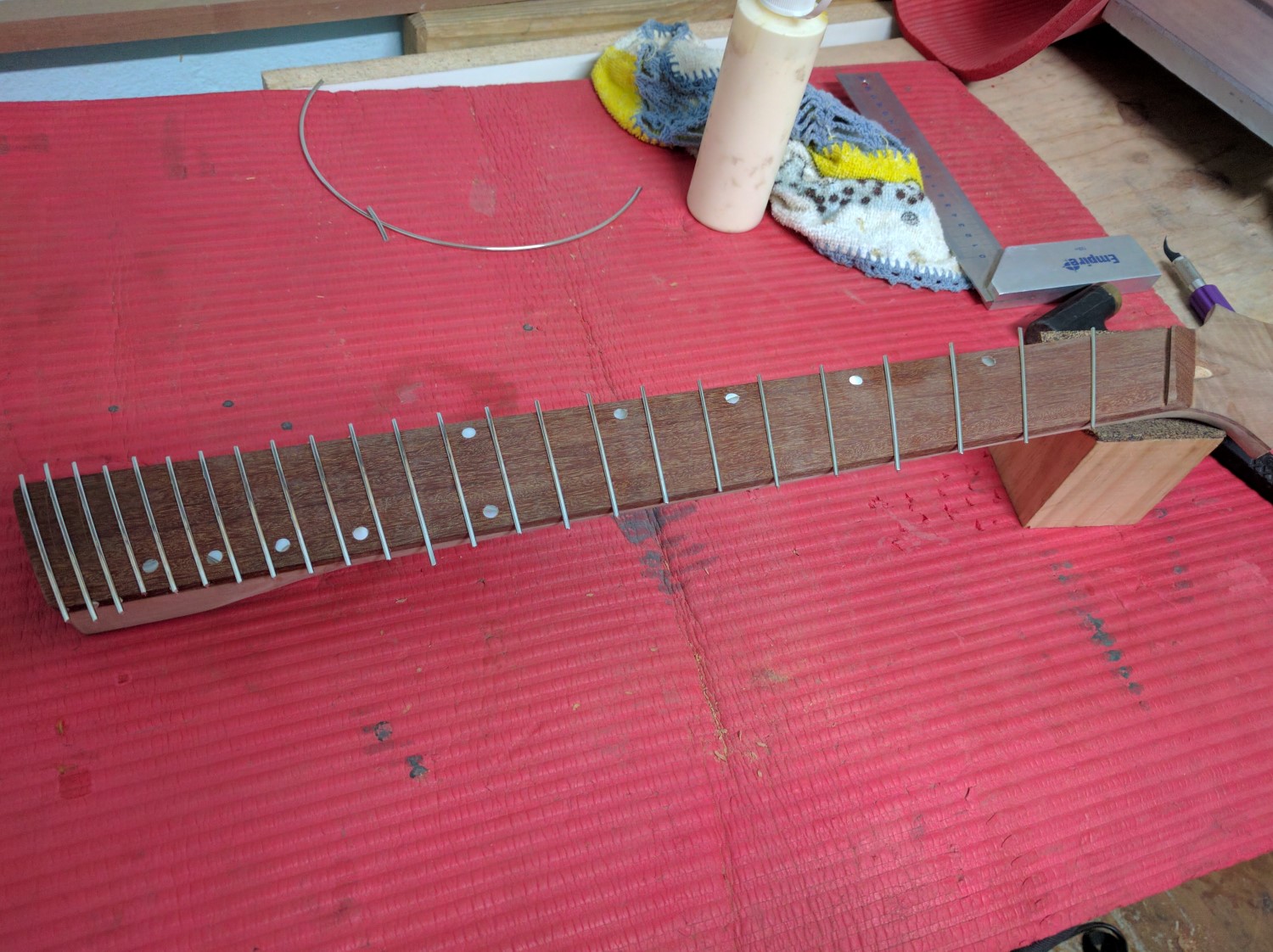

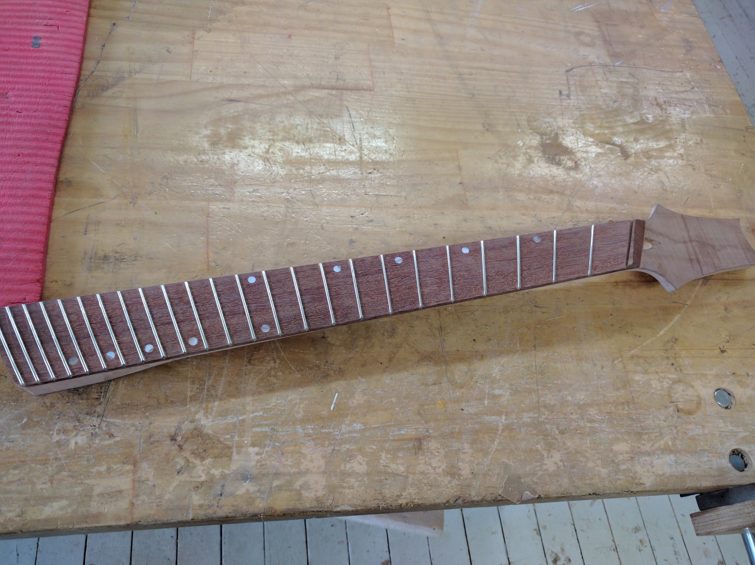

Then it was fretting time!!
Attachment 13605
Attachment 13606
And we're so close!! I'm super excited at how well it's come together.

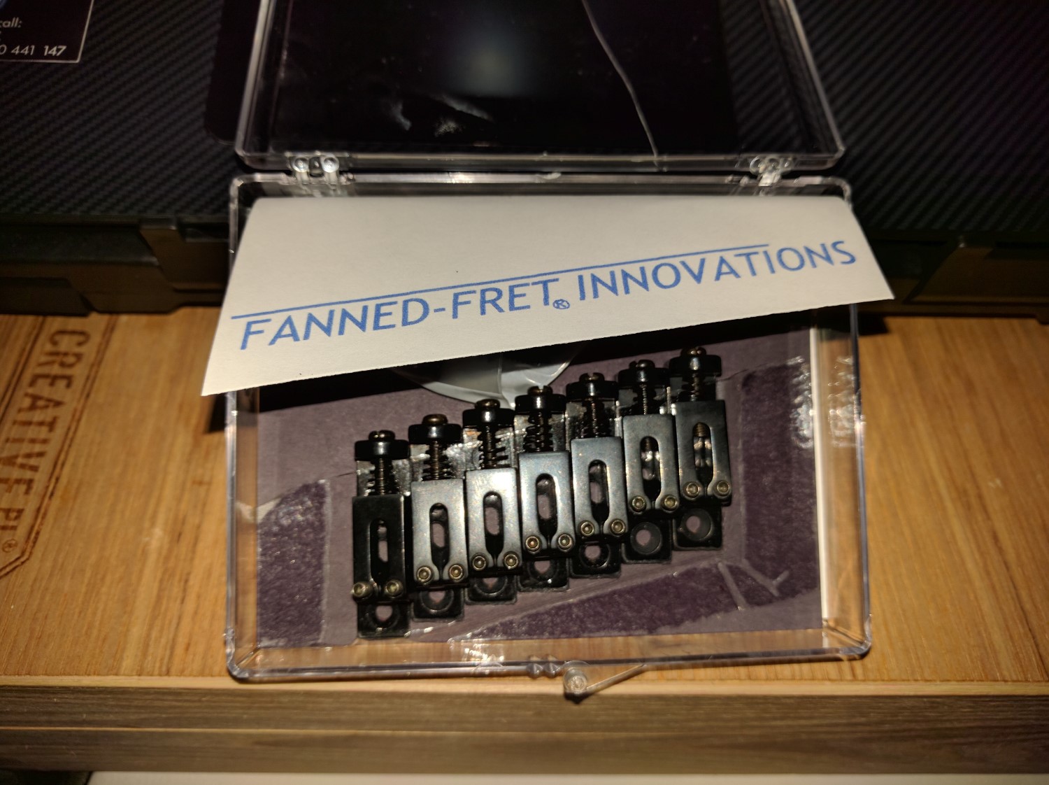

Next week we'll finally be able to do the neck pocket and sort out the bridge (we wanted to wait to make sure we routed the neck pocket the right depth) because my bridge finally arrived!!
Attachment 13607
