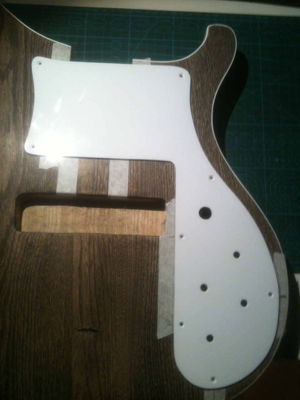

making some pickguard holes, and final touches to the pickguard sides. Only lefting pickup cavity and polishing.
Attachment 9513
Attachment 9514

Hi guys!
Been very busy at home..Being a father its time consuming but...you know, the first is the first...
Some progress around..
I've finish the pickguard and installed the electronics...because of the shielding theres no need to ground pots to switch but its ok.
-CTS 500k (linear/V and log/T)
-Sprague orange drop 715p 0.047uf
-3 way switch remain from another previuos project
-All parts rickenbacker style knobs
-4 pointer washers
-neck pickup cavity aligned and installed and shield job finish.
Attachment 10523
Attachment 10524
Attachment 10525
