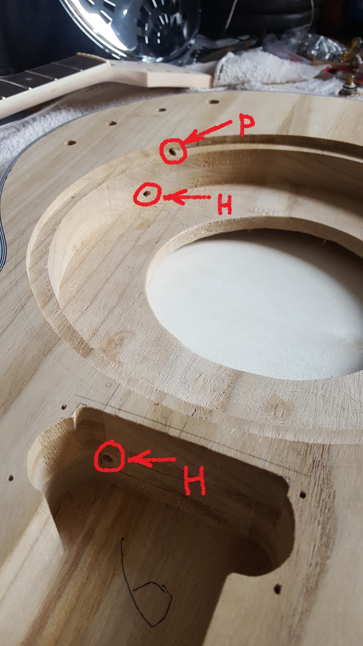

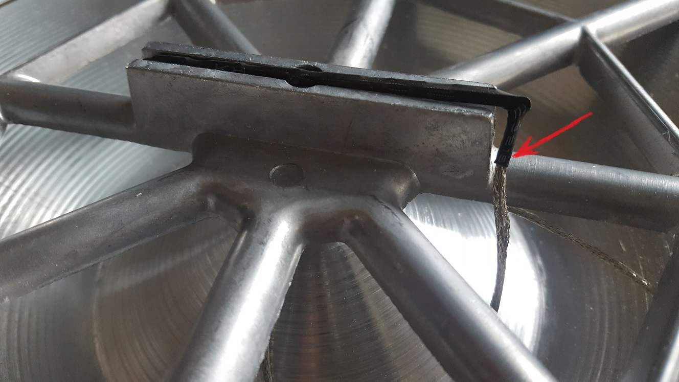

My piezo has a stiff 90' downward bend that prevented it sitting in the bottom of the spider. I drilled a hole through the spider to accommodate, then ran the lead along the spider leg. Over the cone edge and through the body (at point marked P) into the pot cavity. Connection made in the pot cavity. Humbucker has connector under the cone and wire exits into pot cavity at point marked H.
I wouldn't suggest a hole through the cone

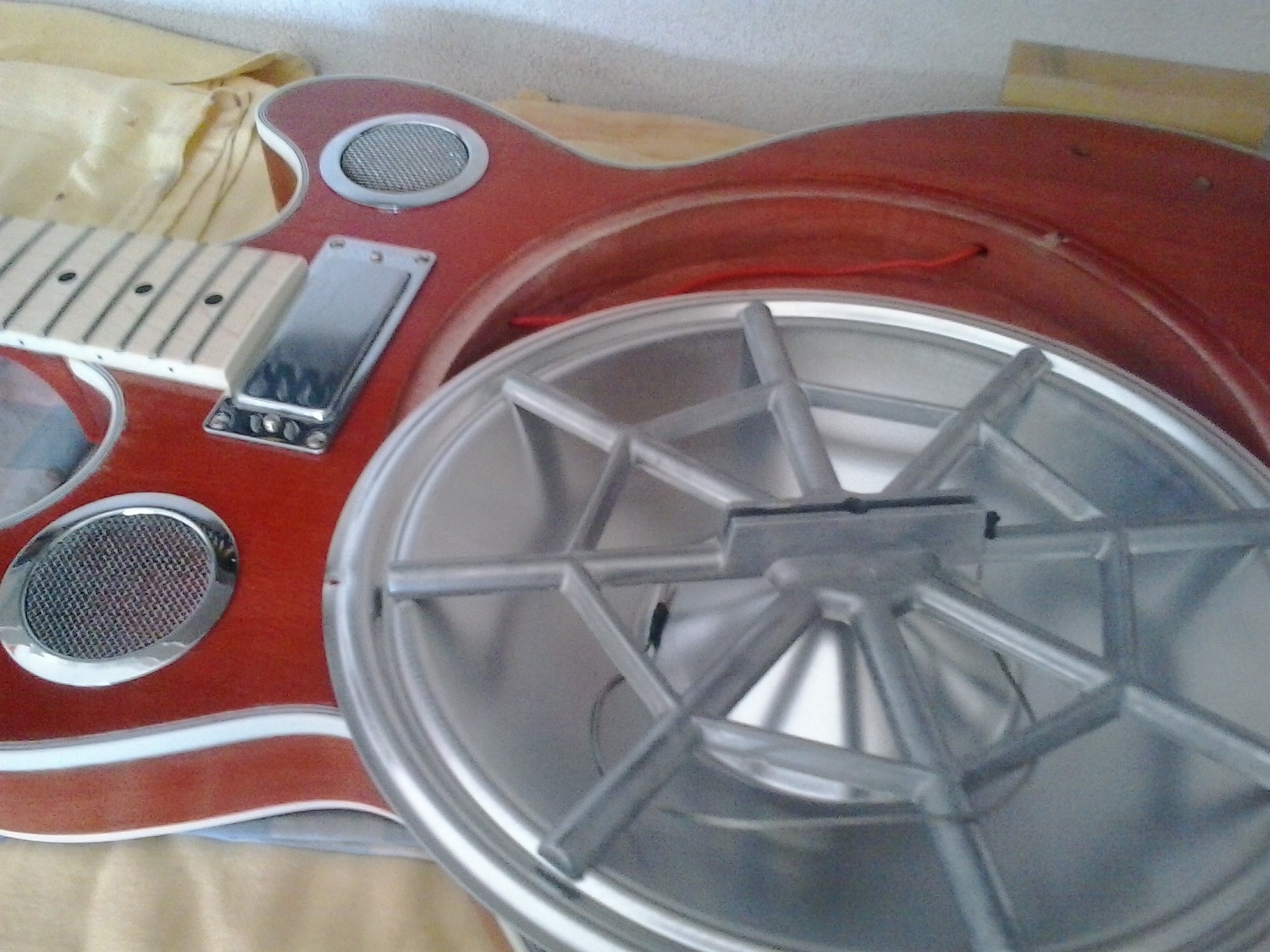

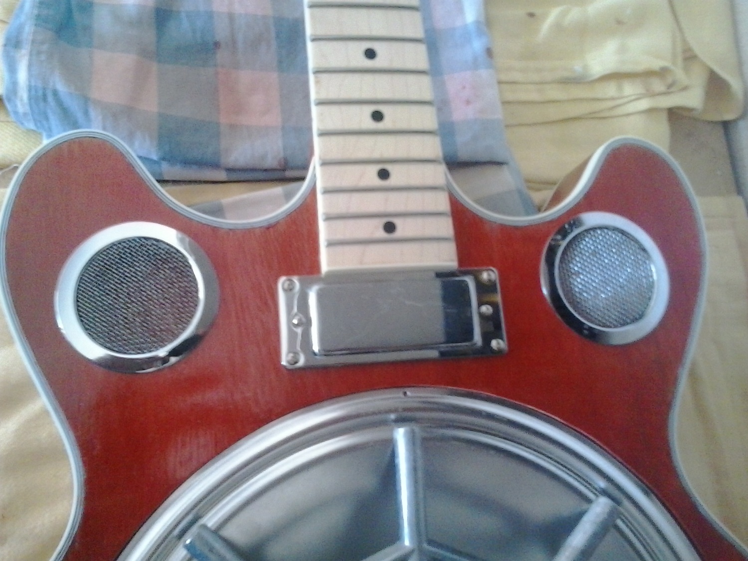

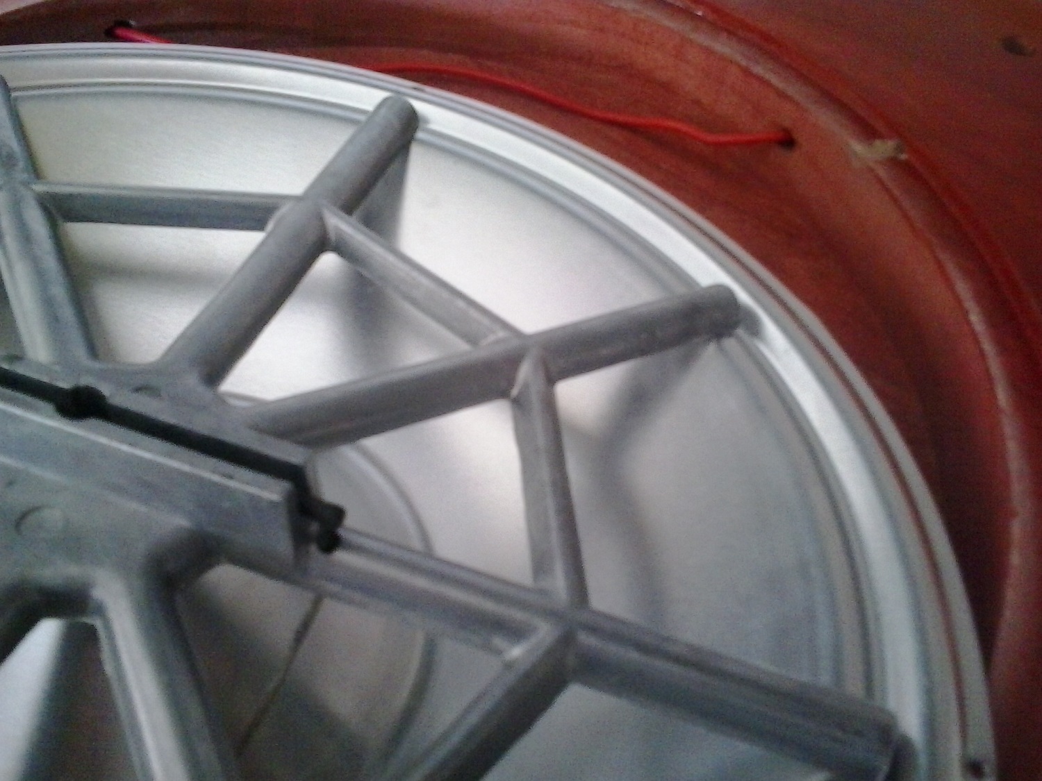

Drilled 3.2mm holes for piezo wire thru spider leg and body rim. Super-glued tea strainers in place (to make it look like I'm making progress!!). Chose to go without holes thru body to sound holes - will see later if it was a good idea or not. Looks like I'll have to feed earth wire from pot thru piezo wire hole back to bridge for ground (??).Attachment 29395Attachment 29396Attachment 29397
