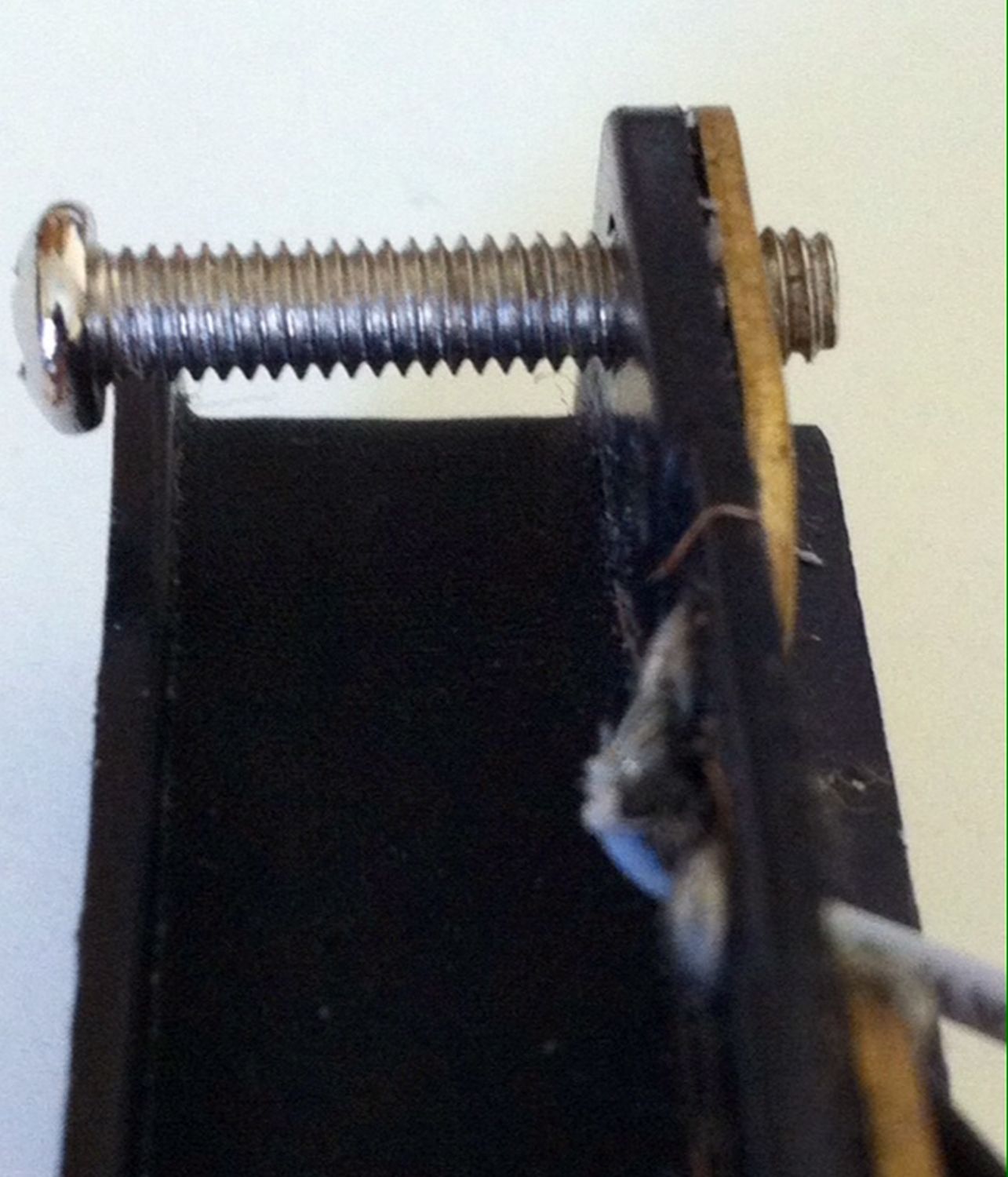

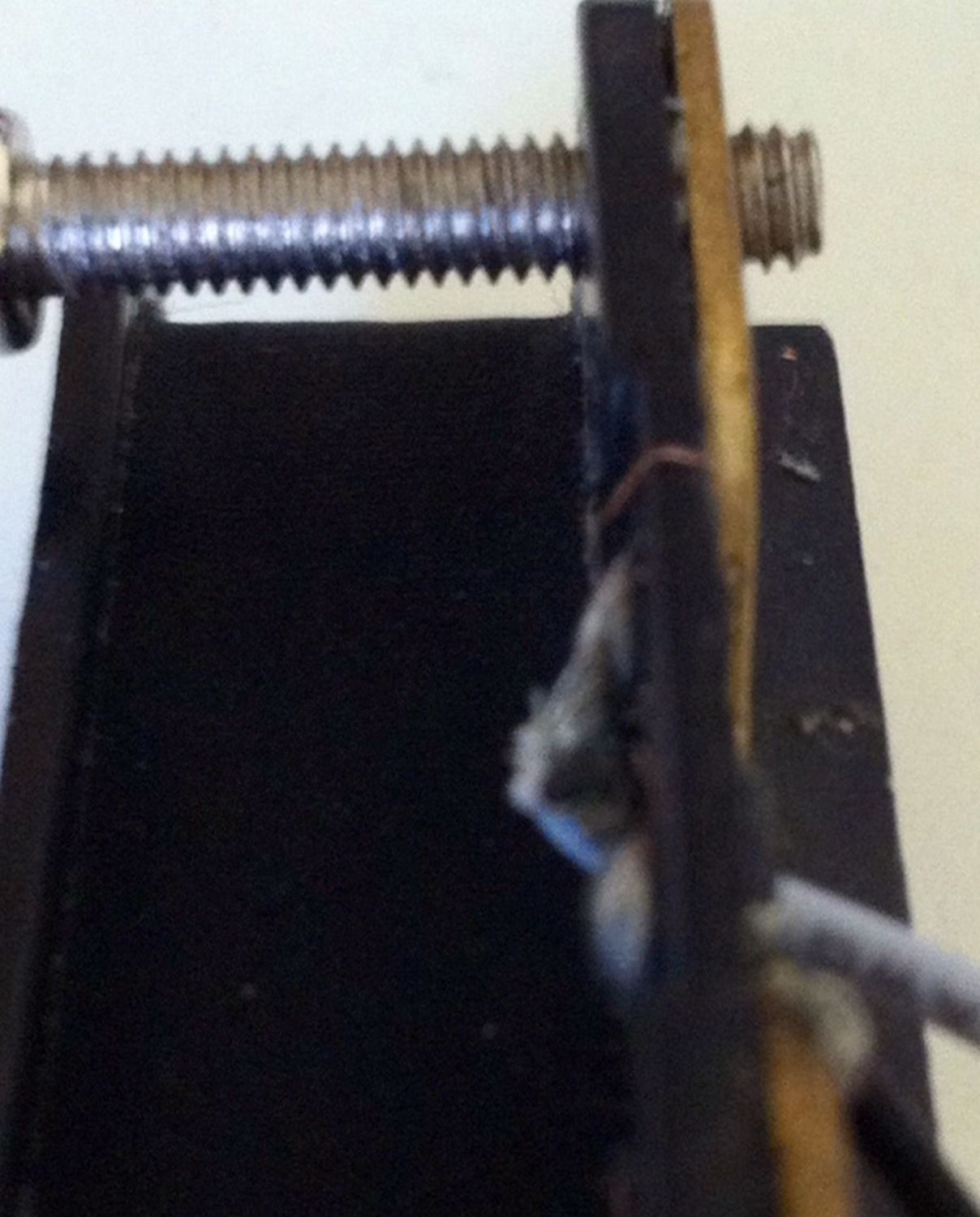

Finally got this thing wired up with the 4 way switch mod only to discover I had the switch upside down as the bridge PUP was not operating on it's own. DOH!!!
Unhooked all the solder joints and did it again and thankfully got all the 4 sounds I was after being Bridge, Bridge & Neck in Parallel, Neck, the Bridge & Neck in series and as they say the last position does in fact sound like a neck position Humbucker.
Only bummer was a bit of buzzing therefore the Shielding Paint did not work as well on this build and had to go to the big green shed to buy myself some of this stuff. As I had run out of daylight/energy/inspiration......I think you get the point, the snail tape will be done on my next day off work and just hope it does the trick.
Attachment 11304Attachment 11305
