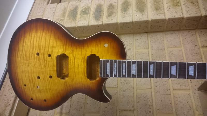

you have convinced me to remove all the tape and paper. Just need to give the top a fine thinners only mist coat. The temps this morning left me with a little orange peel on my last clear mist blend.
Clear coats on Wednesday and Saturday mornings, imperfections and all. Then it can rest up for a month.
Attachment 1150
that is a lovely burst Kane, well done
Wow Kane! That burst is amazing. Puts my current effort to shame. Don't change a thing!!
