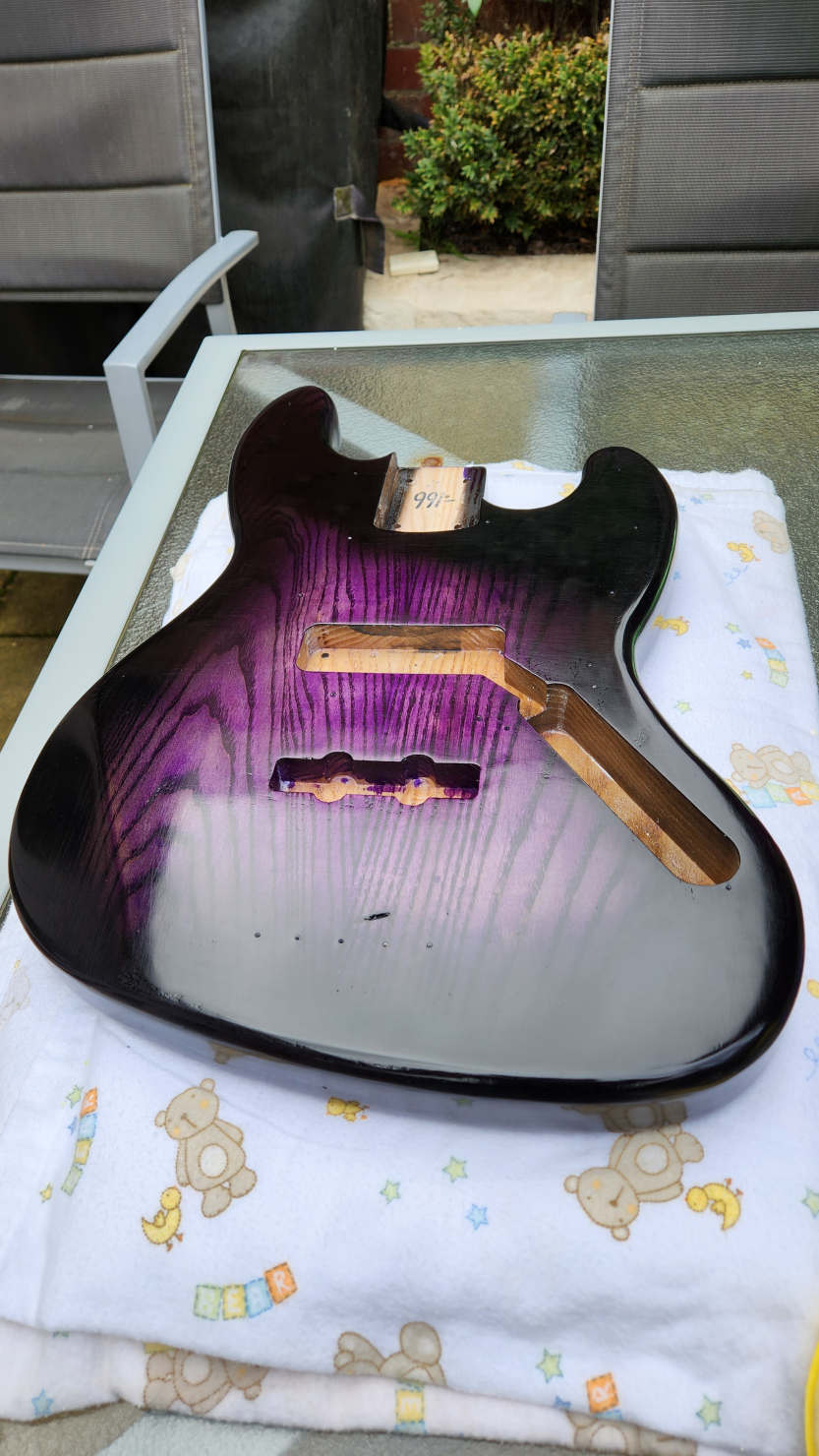

1 Attachment(s)
Wet sand done. Was terrified about sanding through clear coat, but as it turned out, I was fine. Micro Mesh pads were so easy to use! It's not perfect, but I'm happy with it. I've polished it with Maguires Ultimate Compound, and I can still see a few fine scratches from the wet sanding. But I'll get some Scratch X into it after lunch and see how it comes out.
I have some Dunlop 65 Guitar Polish and Cleaner. Is this suitable to put over the top? Or is there another polish I should use to finish after Scratch X?
Attachment 43509
Looks very nice. You could obviously keep tweaking and tweaking, but I’d be pretty happy with that outcome.
The Dunlop cleaner will be OK to put on, but it’s really meant for cleaning dirty guitars and yours isn’t dirty. I’d have another go with the Ultimate Compound as it’s coarser than the Scratch X so will remove scratch marks faster. Repeat as necessary then use the Scratch X to add a higher level of shine.
If the scratches are quite deep rather than very light and on the surface, then you may need to go back and wet sand again. Sometimes it’s the only way. Double check that the scratches are on the surface of the finish and not in the wood beneath it. If they are in the wood, then you won’t fix it without sanding the finish off completely. I’ve had to do that before.
If you need to wet sand again I’d start with something quite fine, say P800. If that’s not doing much after a good sand then try P600. You shouldn’t need to go below P400.
It’s important to clean and dry off the surface after each grit. You don’t want to push those coarser finish particles around with the finer grit paper and you need to be able to check for obvious scratches. There’s no point going finer if there are still coarser scratches around. Sand until you’ve removed all the scratches left by the previous grit paper.
