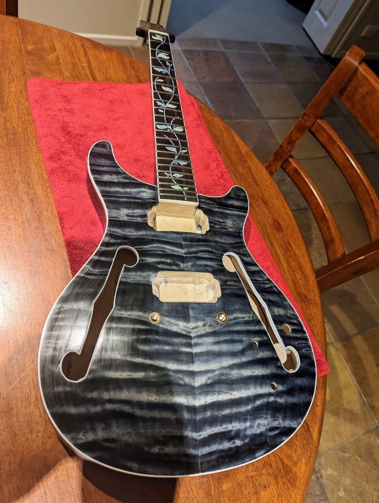

Well, it has been over 1 year since I last posted on this project! I got sidetracked and didn't get back to this until February 2023.
I have now completed staining and oiling the guitar and setting the neck. The last thing I did was apply one coat of lemon oil, for a slightly glossier finish, and am letting this dry/cure before deciding what to do next.
I used stains, danish oil and lemon oil from TLC Guitar Goods and I am very happy with the result. Unfortunately, the guitar body was a 3 piece basswood (you may remember my original, custom, order had a mahogany body but it arrived with quite a few defects) and it's not the best at taking even staining. Nonetheless I'm relatively happy with it. The maple veneer top and the maple neck are both stunning.
Attachment 44086
Attachment 44087
Attachment 44088 Attachment 44089

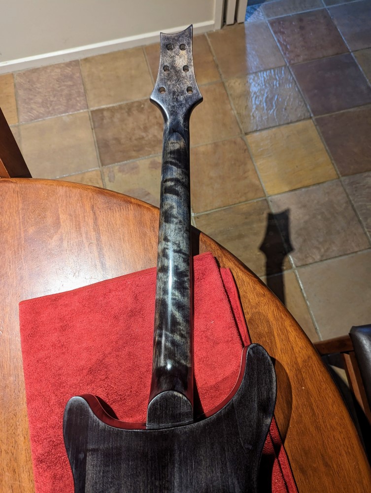

The first image shows the back after staining and before applying danish oil.
The next three images show the guitar after a single and final application of lemon oil.
I am considering applying 2-3 coats of Minwax wipe-on poly. Does anyone have any advice for me? It's a water-based product so wondering if this will be problematic given the danish oil finish. I'm hoping for a bit more of a protective layer and a touch more gloss to the finish.
I wasn't able to find a solution to the white binding so I have decided to go with gold pickup rings to replace the cream ones I originally purchased. If it looks too "blingy" I will go back to the original black ones that came with the standard pickups.

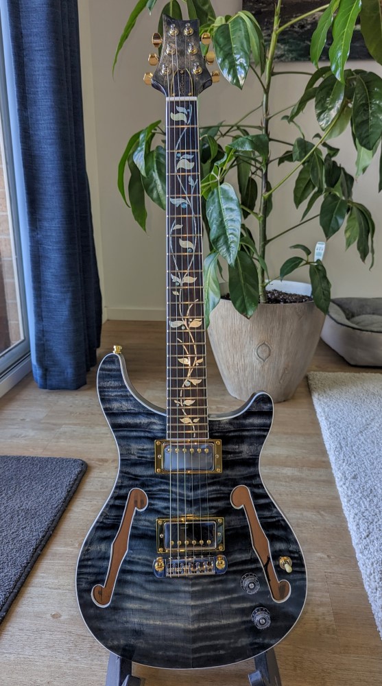

I ended up using the wipe-on poly and I have to say that I am very glad that I did.
It was my first time using this product so I am an amateur but I'm very happy with the finish. Here's the guitar with all hardware installed except for the switches and wiring.
Attachment 44146

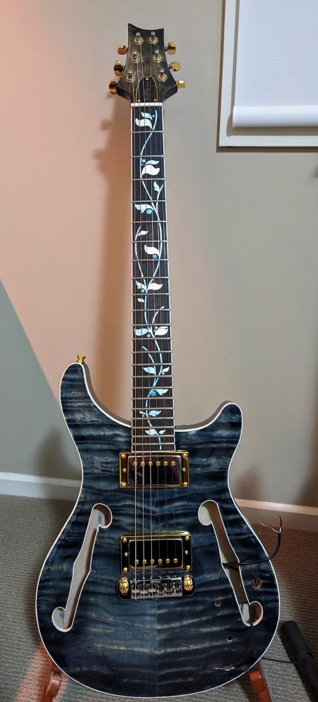

And... the finished product!
Attachment 44166
