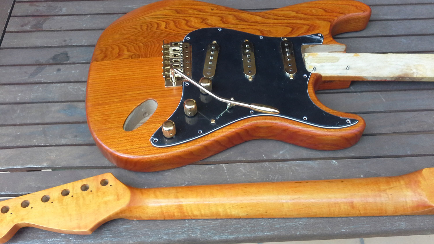

OK, so we have had some progress.
I put another DT colour coat on the neck, and we had a disaster!! I guess there was some grease or something and it ended up looking like a some sort of demented tigers coat after it had been shat out of a T Rex arse.
Not to be put off, I ordered a 2nd kit and started off on that. So, same shaped headstock, but a maple fretboard.
Sanding sanding sanding etc etc, yadda yadda. I went for some Behlen meadium wheat stain, and some naughty oil (sorry DB)
Attachment 5837
This is after 3 coats of N.O. Im guessing about 5 more to go on the body, probably more.
The 1st kit has had the neck striped back, (and let me tell you how much not fun that is!!!!) and will be re done with some more DT when it arrives.
the body has had 3 DT colour coats and just had 1 intensifying coat (pics to follow shortly)
looking excellent so far SoundGuy.
Love the gold hardware, are the pup covers gold as well ? Bit hard to see in the photo
ahh, the joys of finishes not doing what you want/expected...
looks pretty cool now
