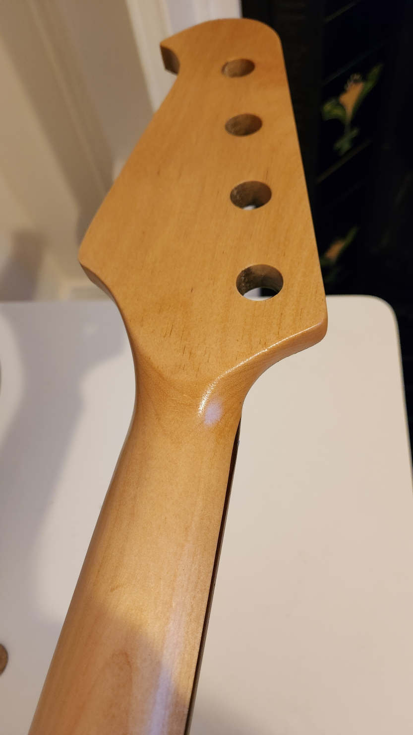

Very light sand on the neck to 600 grit, followed by a final coat of satin poly - so happy with the way the neck is coming up now. Looks good, feels awesome. I may give it a light polish with the rest of the guitar to finish, but I'm really happy with it now.
Attachment 43480
