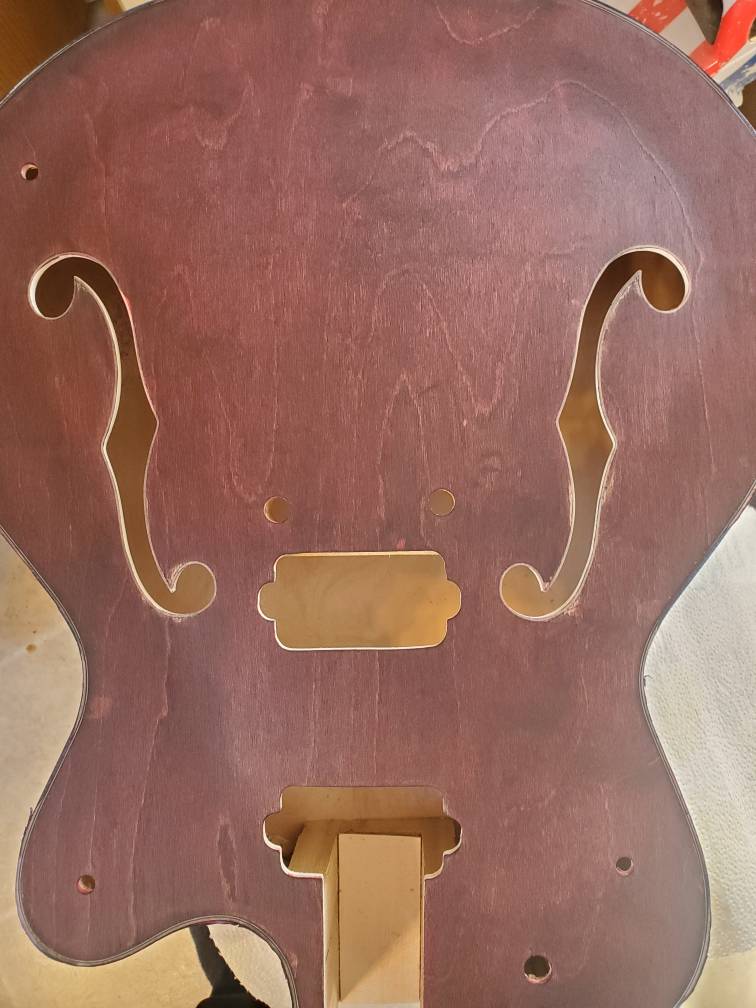

Makes a great base color for a very purple burgundy color. I just can't do a pink guitar. It was done with black, oil based stain over the pink. Attachment 42404

Possibly an artefact of the surface reflecting a lot of white light back. I’m sure it will look a lot redder with a finish on it. But maybe not quite the red you wanted. Try another application of the stain?
Edit: I see I missed an over the page post.
That looks good.

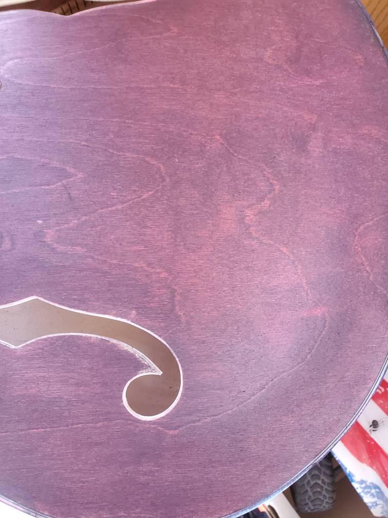

Waiting for the black to dry so I can sand it smooth. Might get another coat of black after sanding. Well see how it turns out. Kind of a dark plum purple stain with mild pink grain highlights. Attachment 42405

I like it. It sanded out nice and smooth with no loss of color. Time to scrape all the tiny bindings on the f-holes, then start on the neck joint and cut the headstock (On a gr-1sf?!........ yes, this one anyway...[emoji16][emoji16]).
The heel of the neck needs some contouring. The radius (contour) from the neck joint to the neck is a bunch of sanded flats. I'll straighten that out too. Yaaaaa hooooo.

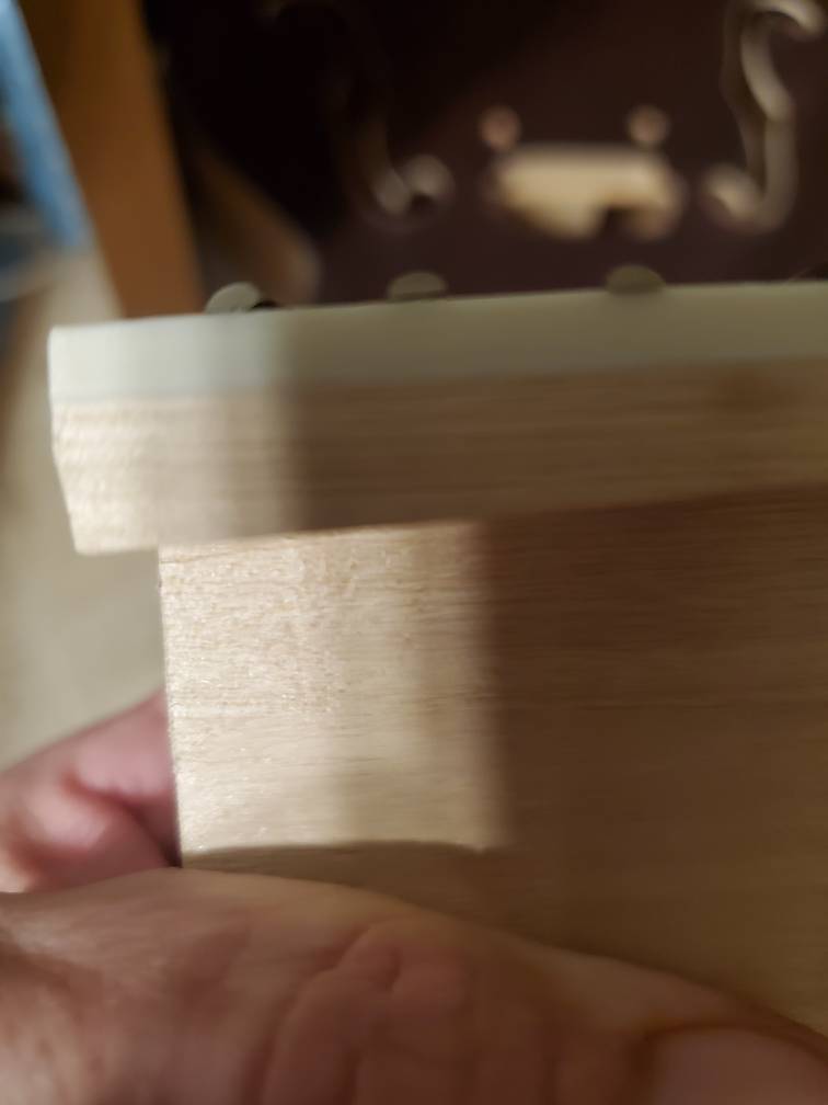

S$/t!!! Going to try to tap it down with a mallet, but it's awful high. Attachment 42465
