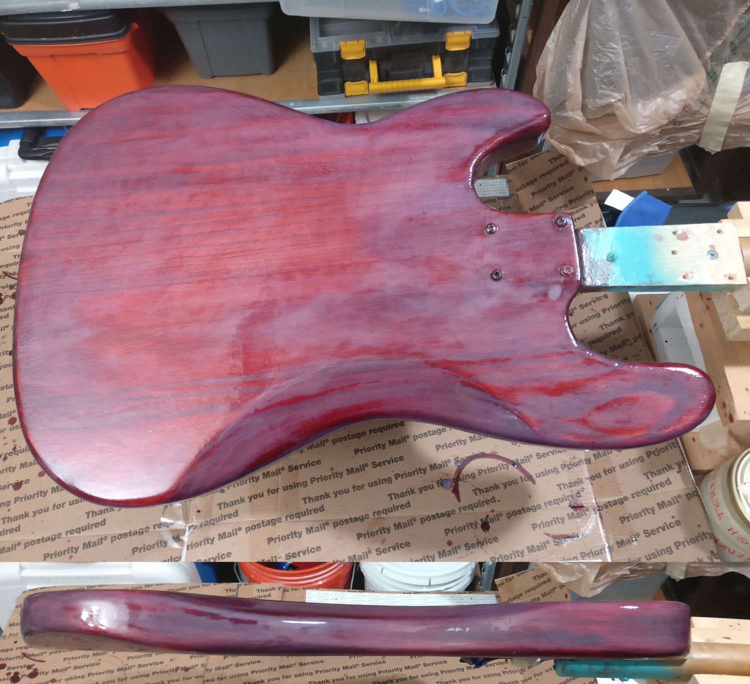

Just a bit more on the finish. An odd thing happened on the last coat of Aqua Coat filler and some of the coats of top coat (General Finishes High Performance Satin). I got this weird sort of cloudy sheen from them...
Attachment 39532
You see it on the back and even more so on the side. [Edit March 13, 2021] I just realized than when I originally posted this, I forgot to mention that after about an hour with the topcoat and about 30 min with the Aqua Coat, there was no more cloudiness. It had turned crystal clear.
That said, the top and back are really well filled. There are a couple of places where there are some natural grooves that follow the figuring of the wood at the bass of the cutaways, but I decided I sort of like how they looked, and the filler has made them quite smooth.

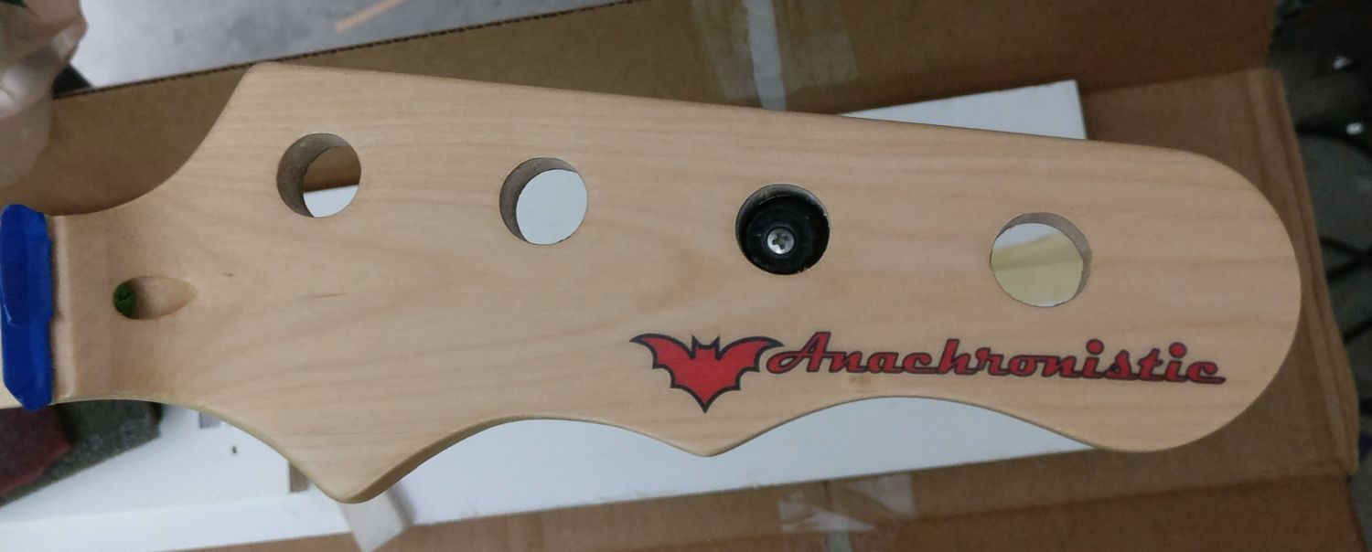

Did the neck too. Not exactly like the old Epi batwings, but an homage nevertheless ;-)
Attachment 39533

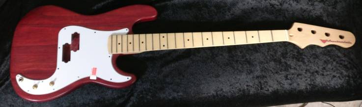

The finish has now cured for about 5 weeks, so I took it out off the rotisserie, and popped the neck on to see how it would look. One of my daughters suggested 86'ing the white pickguard in favor of a black one. I think she's right.
Attachment 39874
Light's not great in my garage at night, and the pics are not that sharp, but you can kind of get a sense of it. It may cure for a bit longer until I have a few hours to sand (and sand and sand).

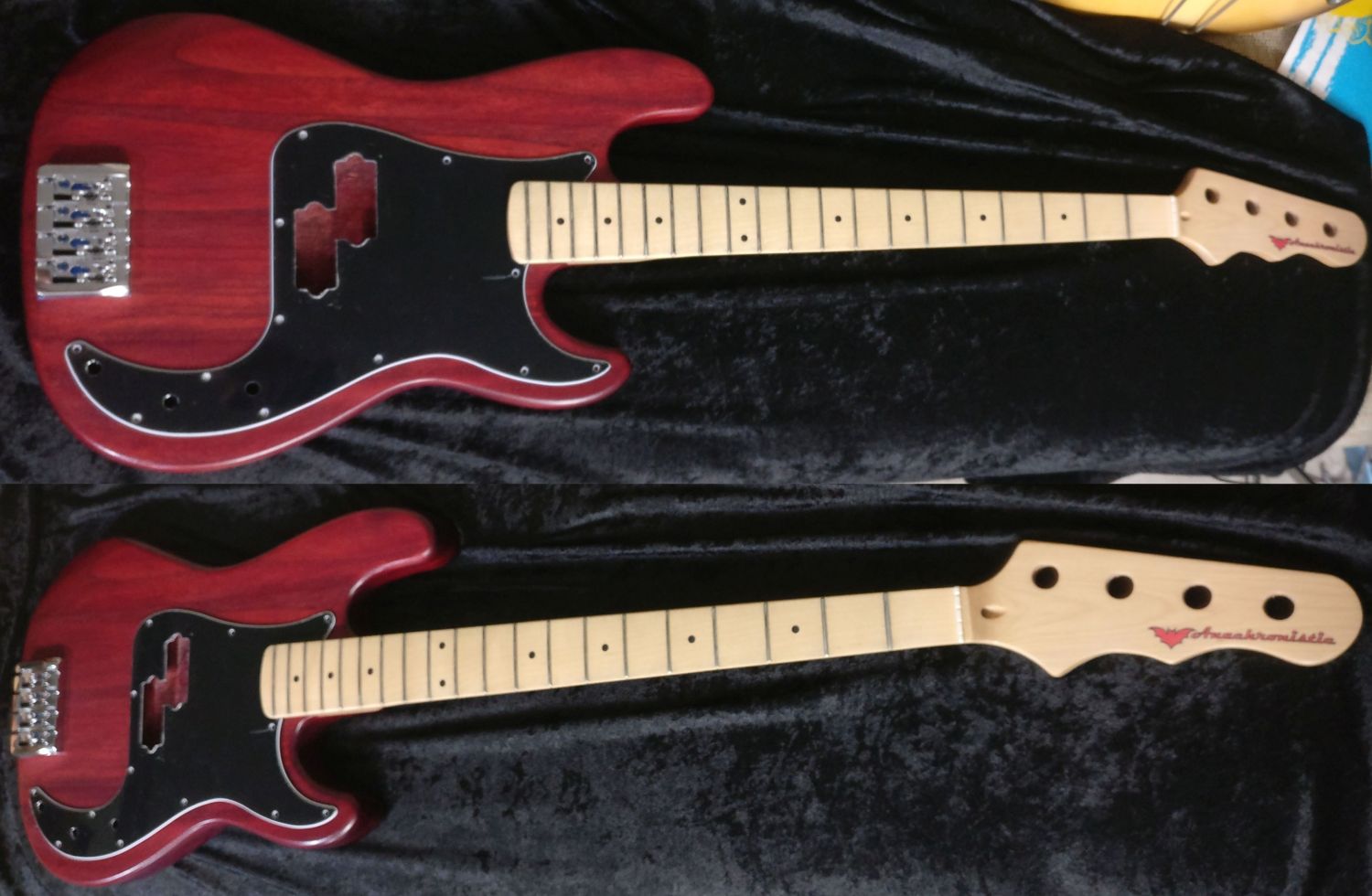

I have seen similar color schemes from Fender, but usually black with a maple neck. Echoed by my aesthete daughter ;-)Attachment 39884
Yep, black wins for me.
She'll be happy you guys agree with her. I am happy not to have a dillema ;-)
