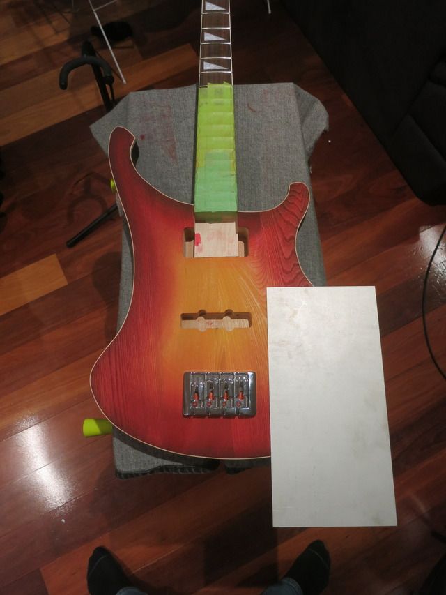

Well a few more coats of stain have gone on.... while it wet its exactly what I want so I reckon Im about ready for clear after a bit more drying time.
Ive been thinking more about pick gaurds/cover plates/whatever.... Ive decided Im gonna cut up some titanium. Partly because the colours now look a little fire-ish and I can heat-colour the titanium so it looks 'hot' but mostly because its titanium and titanium is awesome. :P
Pics:
http://i4.photobucket.com/albums/y13...psba9xdqqp.jpg

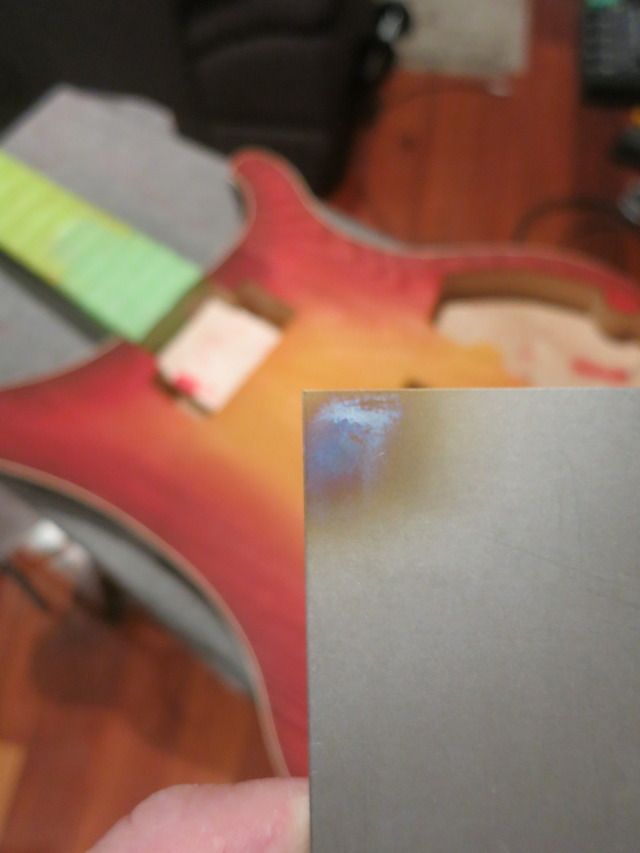

Testing a bit of heat on the titanium (not as easy as I thought it would be but the oxide layer is also more durable so should work well)
http://i4.photobucket.com/albums/y13...psdjxq6egk.jpg

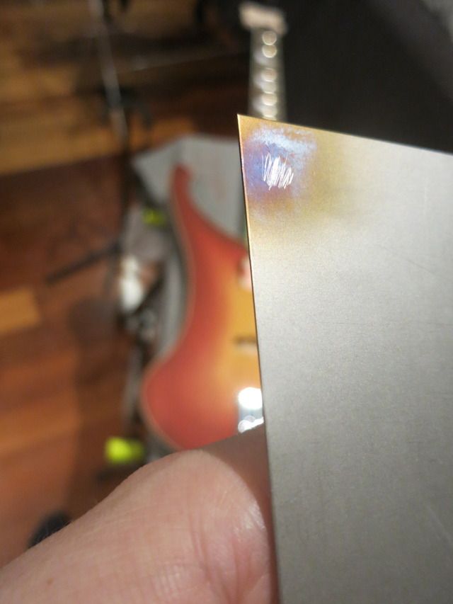

I scratched a bit off to see whats what... although it looks scratched off here because of the light angle, its actually more burnished and from square on you cant see the silver titanium shine.
http://i4.photobucket.com/albums/y13...pscm4frxz8.jpg
