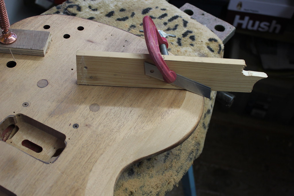

hey. i just found this resto. project.
loads of awesome tips in it. i love the way he scraped the bevels!
http://gretschpages.com/forum/other-...t/65720/page1/
Attachment 40965
