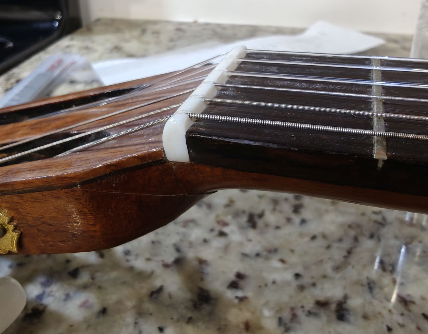

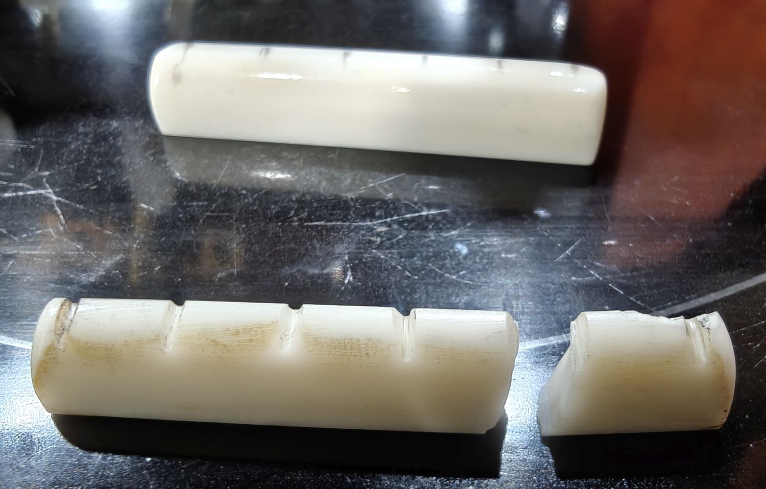

I am about to start cutting a nut from a "raw" bone blank for my flamenco guitar. It's a lot like a classical guitar. Same basic shape, flat fingerboard, etc.* From a setup standpoint, the biggest difference is the action. Flamencos have a much faster action, and are often a bit buzzy. The action on mine is way lower than any classical I have seen...but I confess that I have not ever held or played another flamenco guitar, so I don't have much of a standard for comparison.
With normal playing there are no buzzes on any but the low E string when fretted (or capo'd) at the the 1st fret. With a capo at the first fret, there is .007 clearance between the high E string and the 2nd fret. All the other strings appear to have .009 clearance at the 2nd fret. The exception being the low E, which only has clearance of about .002. It's the only string with a buzz when capo'd, so I want to raise it just a hair.

Would welcome any thoughts! Left to my own devices I'll probably try to combine methods 1 and 4. I'll also probably use a bit of the "Barden method" and have a couple of additional nut blanks handy in case I mess it up.
